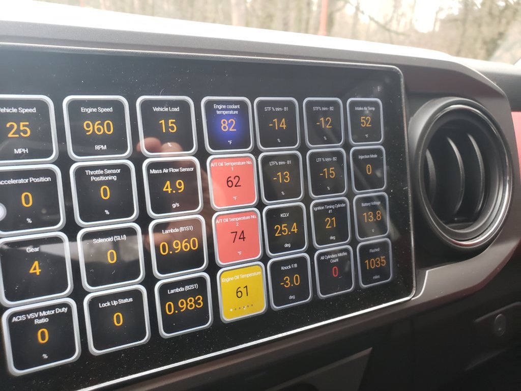

    I think it was going between 26.0 and 27.0. I have no idea what that value means relative to anything. Also, weather was in the low 30's Fahrenheit, if that plays a factor.

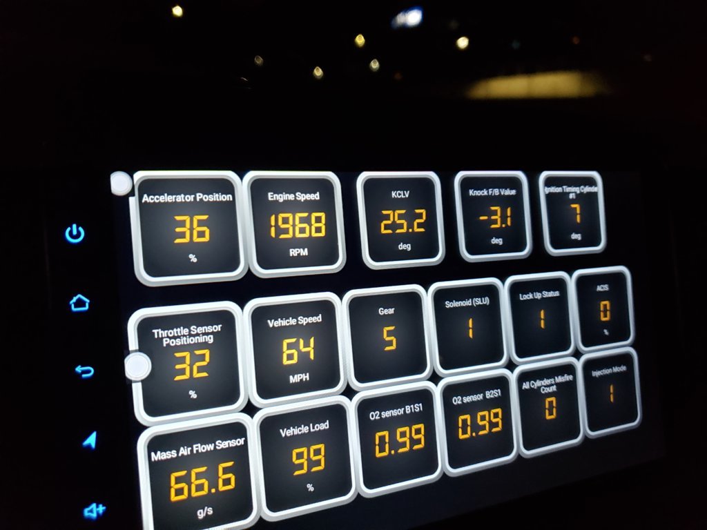

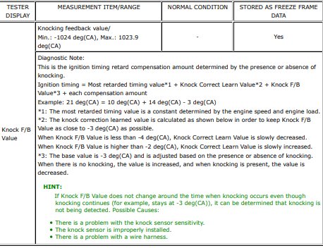

    These numbers can be achieved on tuned ECU running 87 calibration. 2 examples are 2 years apart. Cold air does help
    Here is some information on KCLV

    Great info!
