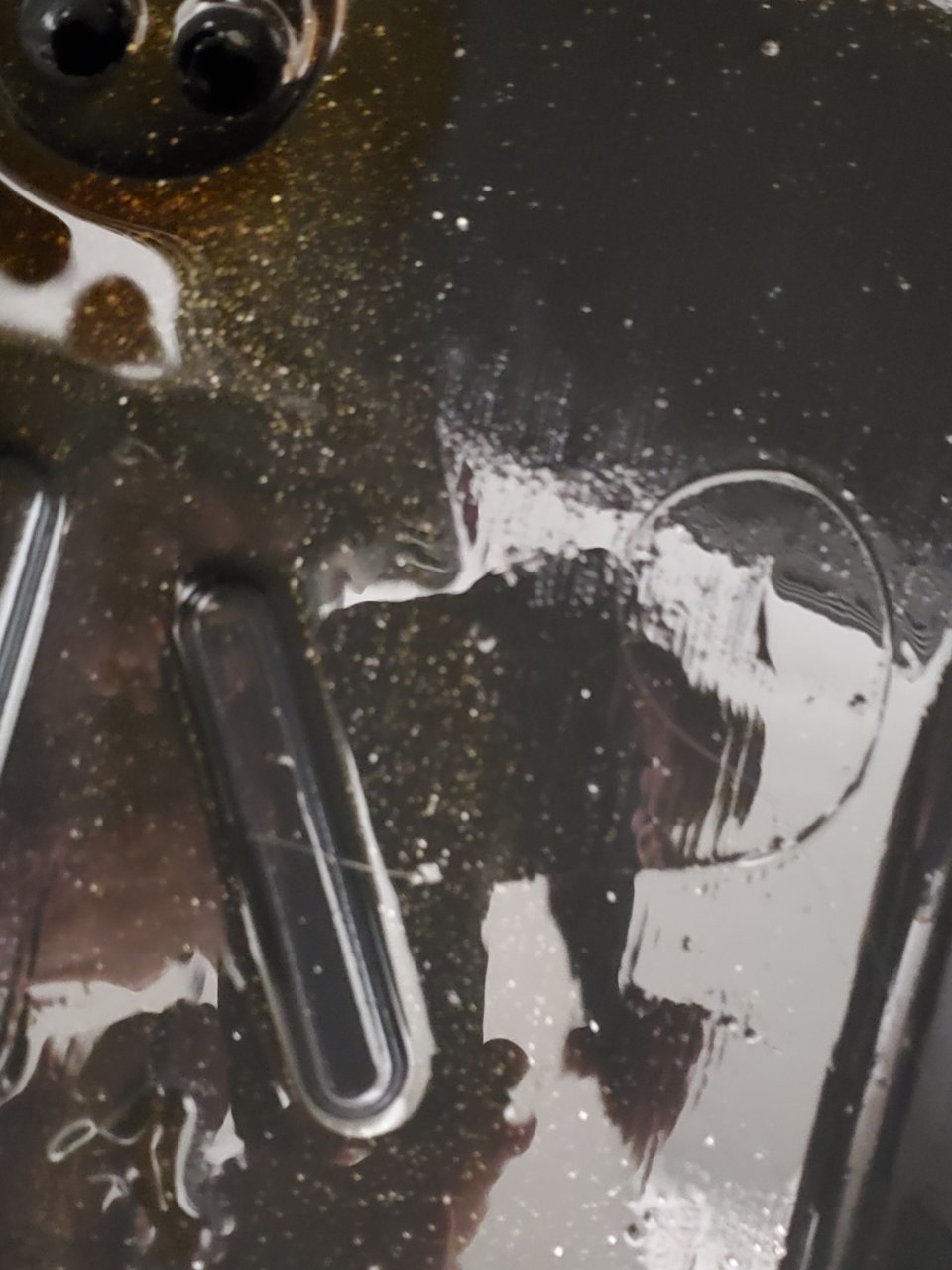

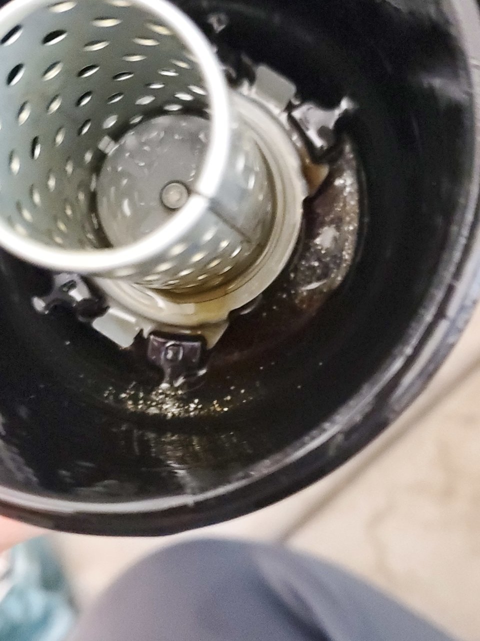

    My Tacoma had metal in the oil at 29,000 miles. Took it in they said don’t worry next thing I know piston 5 decided to leave the block. 1 New long block later 0 miles on the new engine abs ready to hit the trails again. All under warranty still sending it
