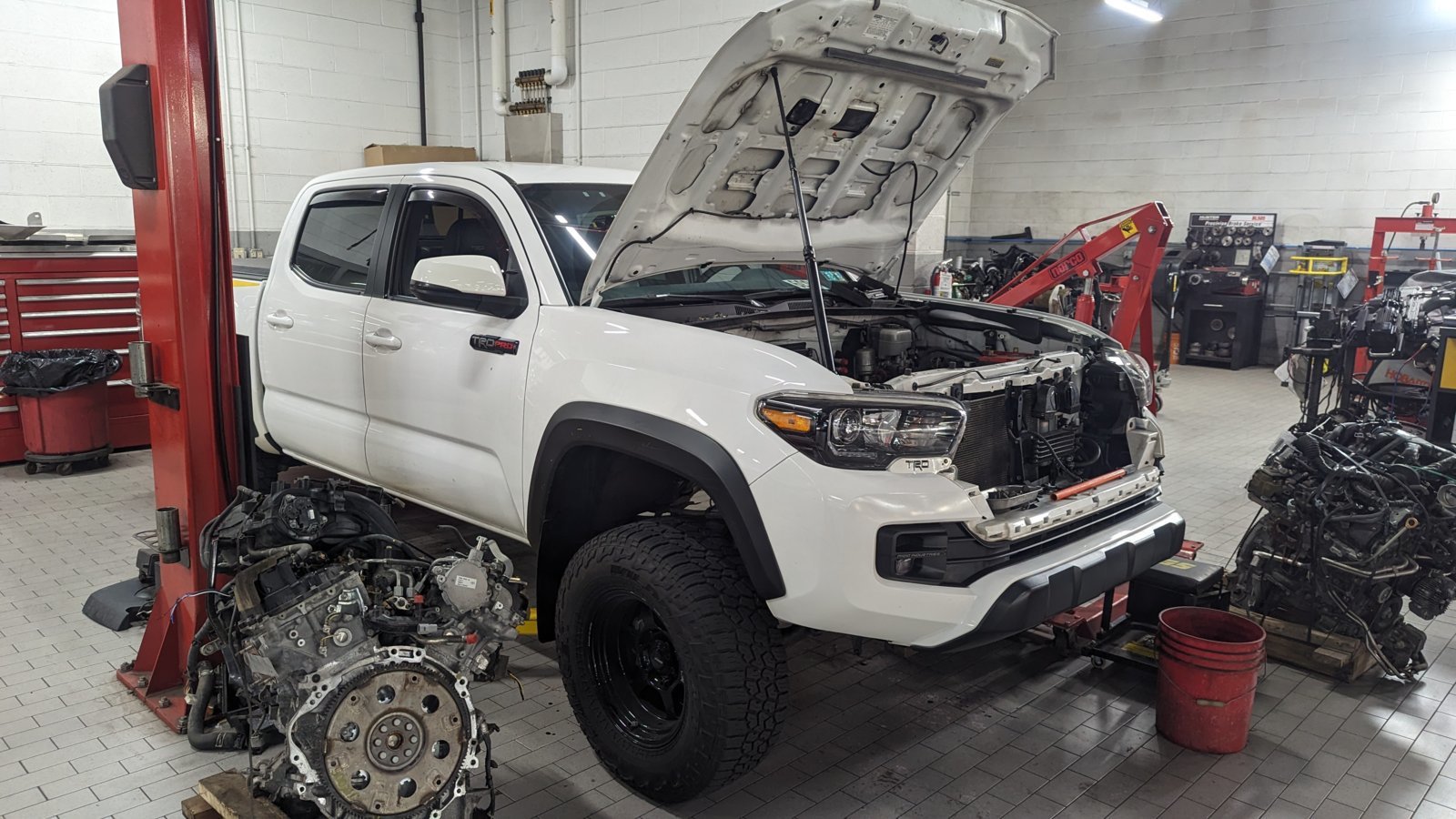

    Conclusion to my engine BS saga. Got my truck back finally.....$12,686 dollars lighter. My dealer ended up giving me a $2500 dollar credit on the service because even they received resistance from Toyotas Brand Engagement department for any assistance....so my total cost was $10,186. Extremely grateful for that much, as I wasn't expecting anything.
    Engine has a 3 year, unlimited mileage warranty on the engine itself and the labor on the job. The engine was used, 42k miles on it.
    This is where things get interesting......it runs GREAT. Smooth as glass, and extremely quiet.....much quieter than it ever was before, even new. There is the soft, muffled injector tick and HPFP tick, but its barely noticeable, and non existent with the windows up. It also pulls much stronger than before too, noticeably stronger.
    It runs so great....I feel it actually runs FAR better than it ever did new. It's also drastically quieter like I mentioned before......which now has me suspicious that there was something not quite right with the original engine right from the very beginning. It's possible it had looser or slightly too large clearances in the bearings or even a slightly mis-manufactured oil pump that never performed 100% and thus, always had lower oil pressure.
    Like before, this engine is only getting Toyota oil filters, and now I'm only using Toyota brand oil too, and I got a case from the dealer right off the bat as well. Everything is going to be continually well documented as proof Im maintaining this engine as well as the first one.....and I'm curious to see if it ends up getting noisier as it gains miles. If it doesn't, then I know something was up with the original one and it was a problem that took 102k miles to rear its ugly head.
    Despite my initial disappointment with my truck when this happened...I found myself quite happy to be driving it again, and especially even moreso that the dealer returned my truck better than new.

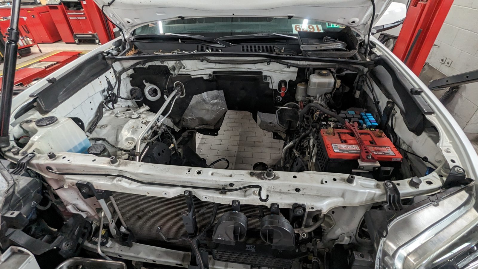

    Replacing that engine was beyond my capabilities at my garage. I could have done it with a lift and engine hoist, but it would be impossible without those...and I have neither.
    That being said.....I found out that by pulling the transfer case and transmission first.....you can actually pull the engine right out from under hood, without even needing to take the hood off. Also noted, the tech that did my job...was a 20 year employee who's a certified Toyota Master tech, so I gotta give him some credit for pulling that off too.
