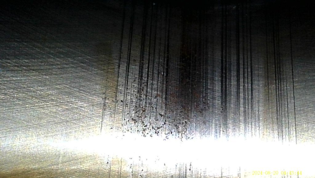

    Hate to be added to the list but it sounds like I might have to be. I feel so validated after seeing all these posts with the same problem, seems like its no surprise to Toyota despite them telling me they have never seen it. Here is a link to my post outlining what happened and where I'm at if anyone can provide some advice and guidance, I've added the mechanic notes they sent me.
    https://www.tacomaworld.com/threads/random-engine-misfire-on-a-2018-trd-sport.825957/
    Here's the long story short
    2018 TRD sport Tacoma with 77k miles on it. Has been babied, no towing no off-roading just a daily driver stock. Was driving back on a road trip and about 100 miles from home the engine light flashed while we were going 65 on the highway. Was driving super smooth beforehand. Had to get it towed to the dealership near me and its still there here is where its at.
    -checked and replaced spark plugs
    -swapped coils and still got a misfire
    -said they checked all external parts for leaks
    -still had a misfire and used bore scope and saw scoring in cylinder 2 so sure enough needs a new engine
    I was shocked, babied the truck, oil change every 5k on the nose.
    Here's the kicker that would be really helpful if anyone can reply. I bought it CPO at 50k, so it has the 7 year 100k powertrain warranty. The dealership called Toyota Warranty to see if its covered and Toyota got back with they need to find the exact point of failure and do a teardown that can take up to 14 hours of labor. If they find it and send it to Toyota then it may be covered (though the powertrain would lead me to think it would be). Okay so Russian Roulette with 3k bill of labor and maybe coverage is leaving me super uneasy. Also, they thought initially it was spark plugs so they replaced them and I have a spark plus, labor, and 2 hours of diagnosing the engine failure after that, that could esaily be 1.5---2k (I'm gonna fight for coverage but idk) It looks like thanks to this forum it is looking like I am in the boat of issues listed that should be covered. But if anyone can also let me know the treatment they got and what was covered to know what I should expect. I called Toyota Corporate and said I was incredibly disappointed with the potential 3k labor change and they are calling the dealership to see what they can do.
    Thanks all

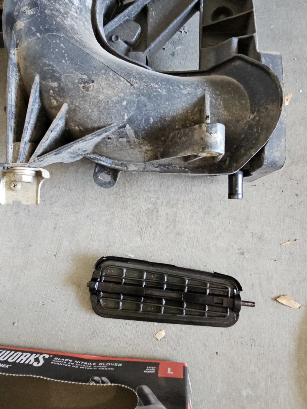

    Cylinder #3 misfire, high rpm under load..
    While performing troubleshooting, the symptom was strange. The misfires were changing cylinders as I swapped coil packs around, making me believe the coils were just going bad.. and when I pulled a coil, there were arcing marks on the bottom of the sleeve where it meets the boot.. but the only cylinder that coded was Cyl. #3
    So glad I was able to find a similar issue on this forum!
    ACIS (Acoustic Control Induction System) failure
    ACIS plenum flap broken inside the intake manifold

    If only the failure points were reinforced or made of metal in later model years but I don't think they are. Looking forward to this issue in 4 to 5 years! :kona: Could be worse, at least I don't have active grill shutters I suppose.
