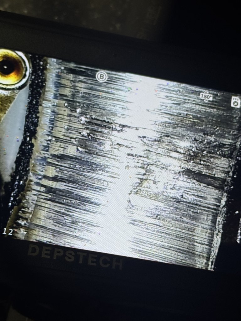

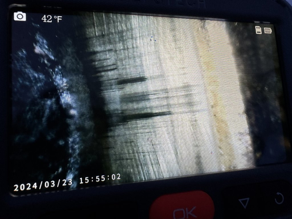

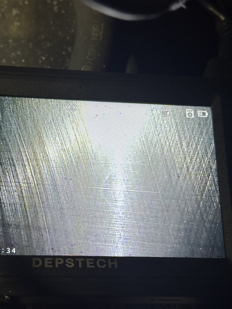

    Just got done diagnosing my brother-in-law’s 2018 TRD. She done. :-(
    Cyl 2 is fukkkkkked. Looks like rings are toast. There’s a loud piston slap and oil in the cylinder. Walls are horribly scored. Compression is shockingly not zero, I got 200psi on cyl 4 and cyl 2 still had 150-160.
    Photos are:
    - good portion of Cyl 4
    - some scoring starting on cyl 2
    - cyl 2 rubbed raw
    -Mileage that problem/failure happened: 104k
    -What actually happened:
    - codes for cyl 2 misfire, bank 2 rich, and AFR
    - bad engine internal sounds
    - running like crap
    -Vehicle usage (towing/off-roading/pavement pounder): contractor work truck (so pavement pounder, a little very light towing)
    -Vehicle modifications (tune/geared/tires):
    Bone stock.
