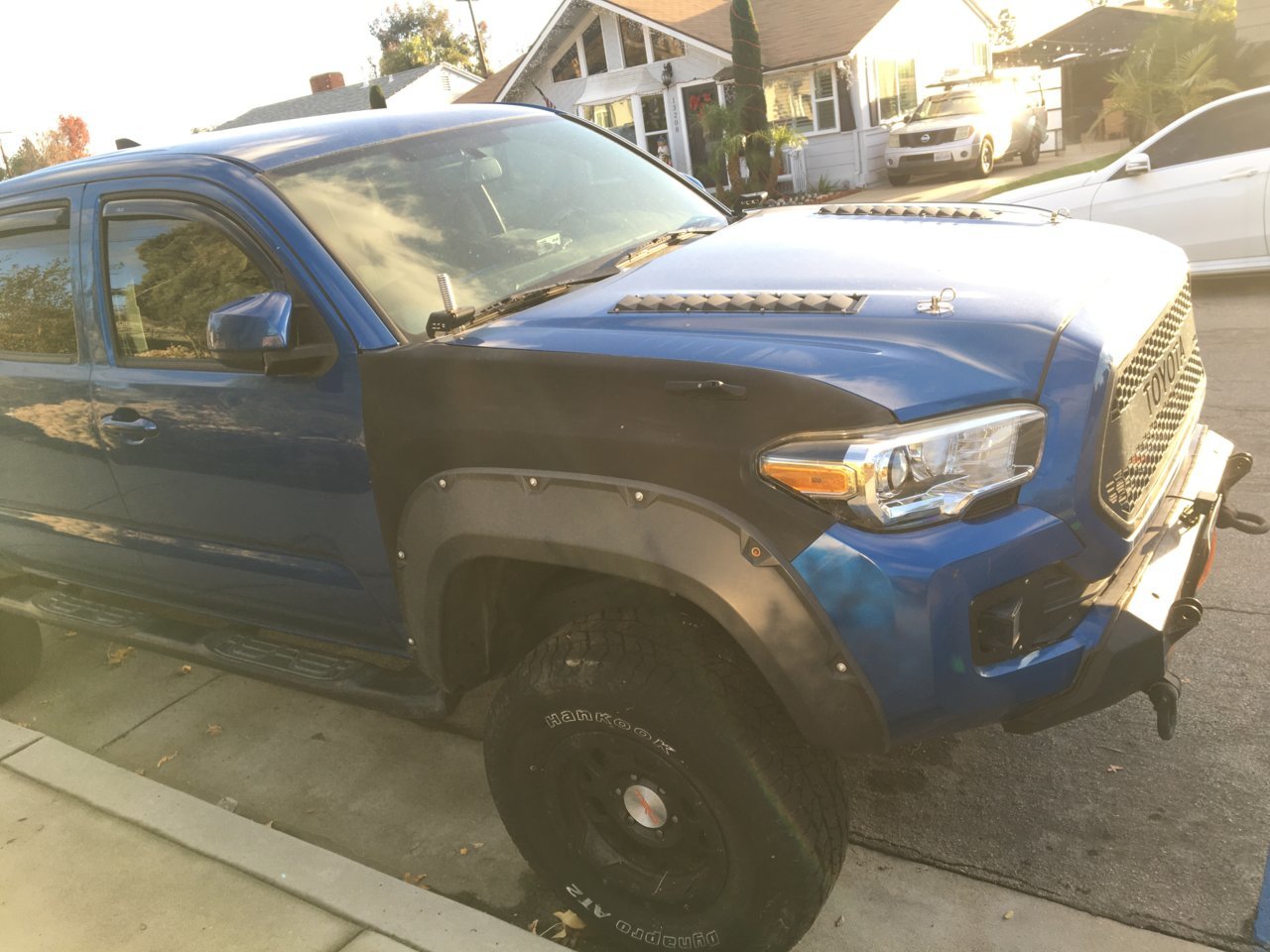

    The mini snorkel was a gag install of spare parts from my 93 4x4 after a red light runner punched a hole in my right fender, it was only in there for a couple weeks before a new fender was slapped on. Definitely wouldn't spray into an NA toyota with an 11.8:1 compression ratio on non-borable cylinder sleeves. Maybe with stainless/inconel valves and low compression pistons but otherwise fuck that. Thats right up there with slapping on the Magnuson kit for a daily driver stupidity wise.

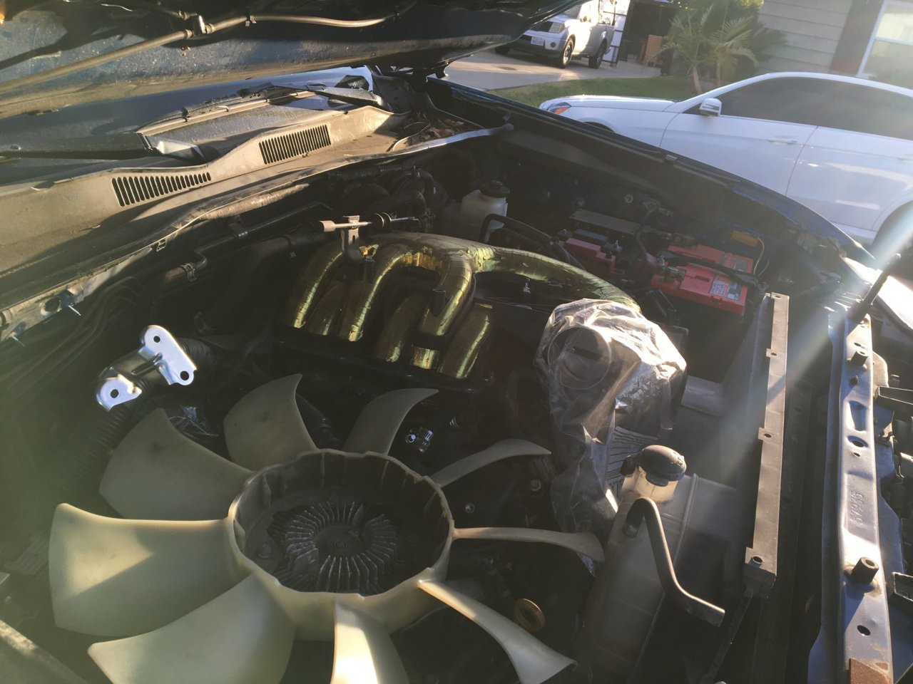

    No más mini-snorkel. y No más engine :(

    What... is that on the upper intake runners?

    Shiny tape

    For heat reflection or something?
    Just curious.
