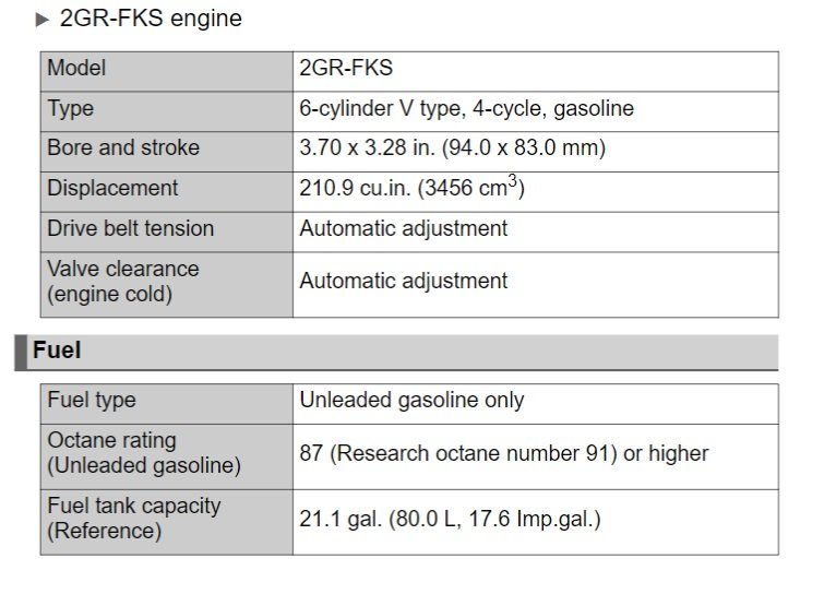

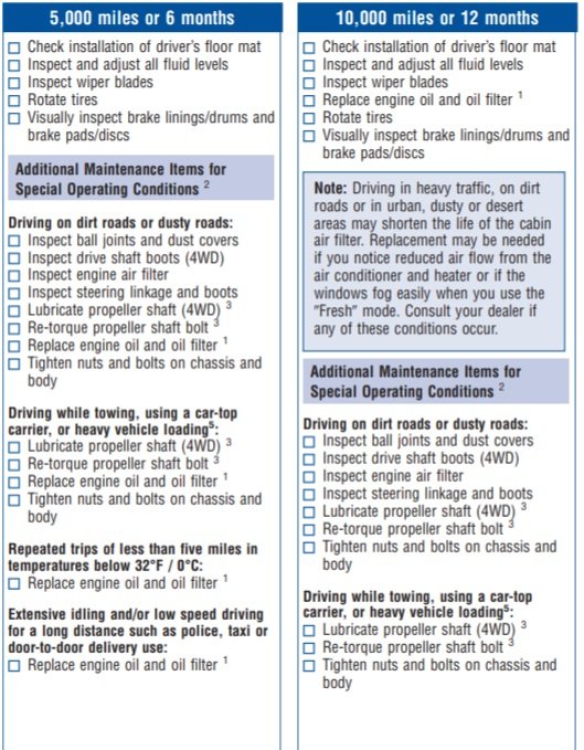

    I ain't sensitive, no worries. I had no idea RON was a thing, do you know what the difference is? I'm gonna try finding the manual, I swear the heavy use interval was 3,500 miles and the service dept was good for it, only problem is the cab is basically a parts dept at the moment.

    Manual is online, that's where I found it. RON is what I believe other regions use and the fuel is measured differently than ours, or something like that. I'm sure a fuel nerd could answer it better, but otherwise ask Jeeves because I don't know exactly.
