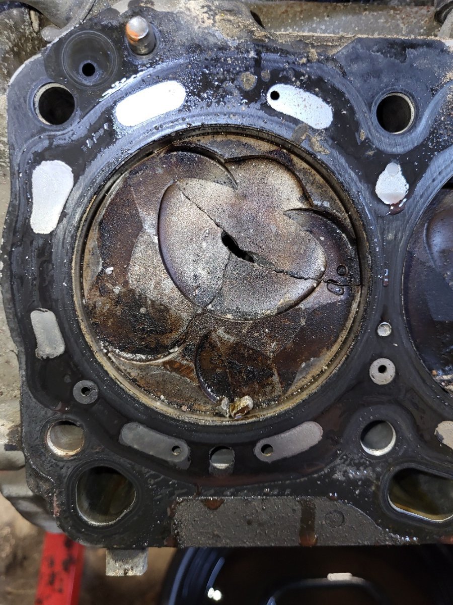

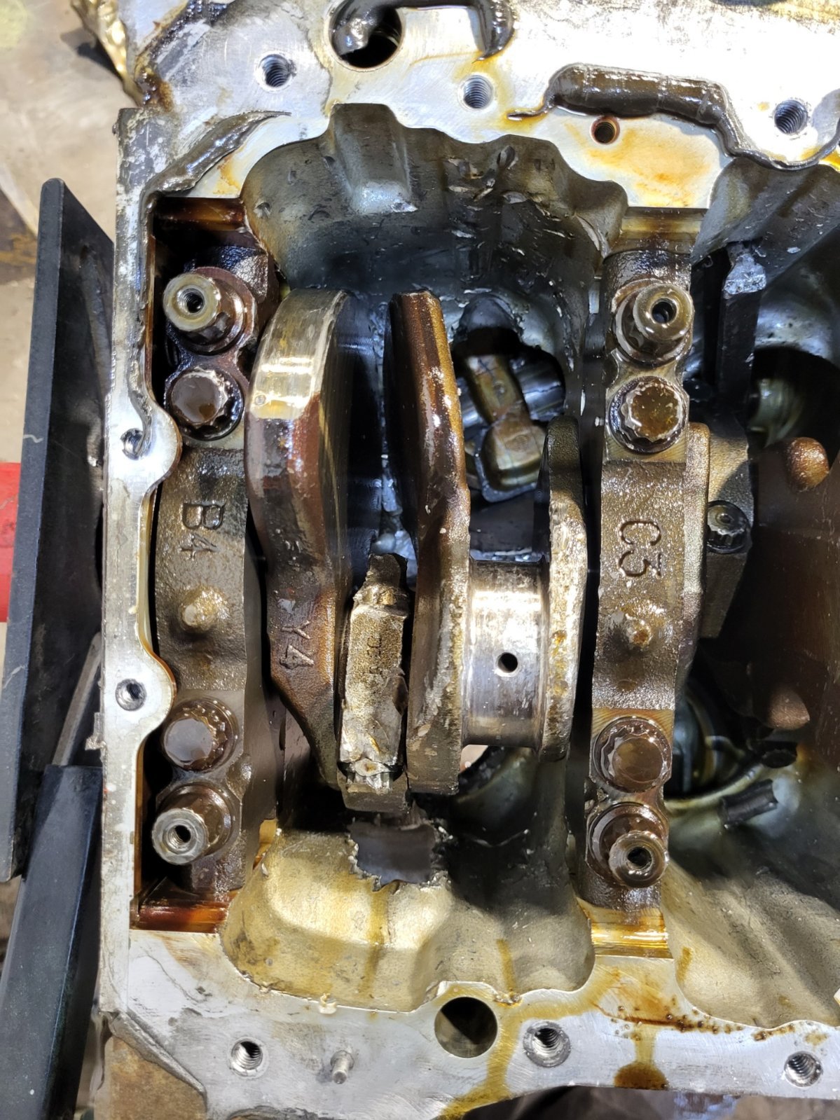

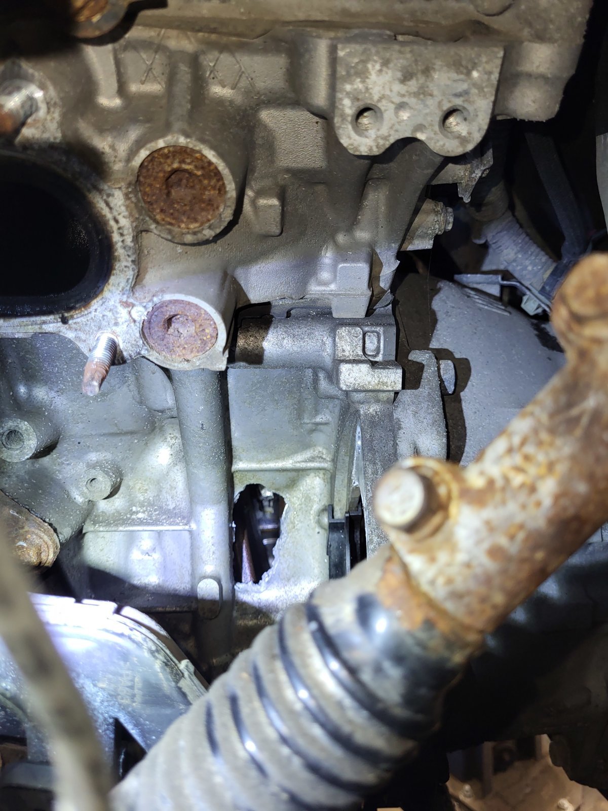

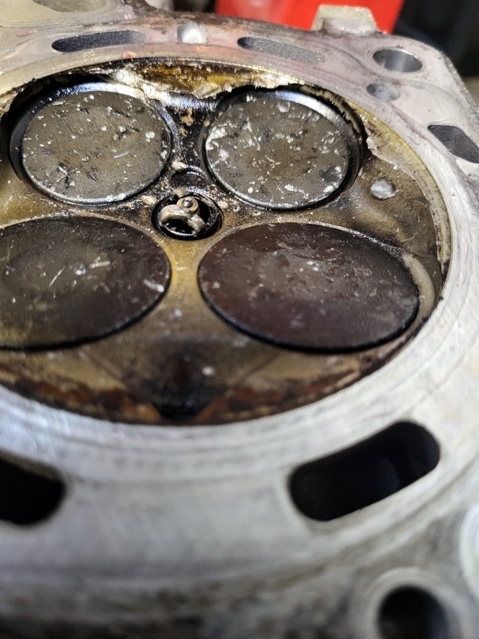

  8. Jan 11, 2024 at 5:43 PM
    #288
    defensio
    defensio New Member
    Jan 11, 2024
    #441447

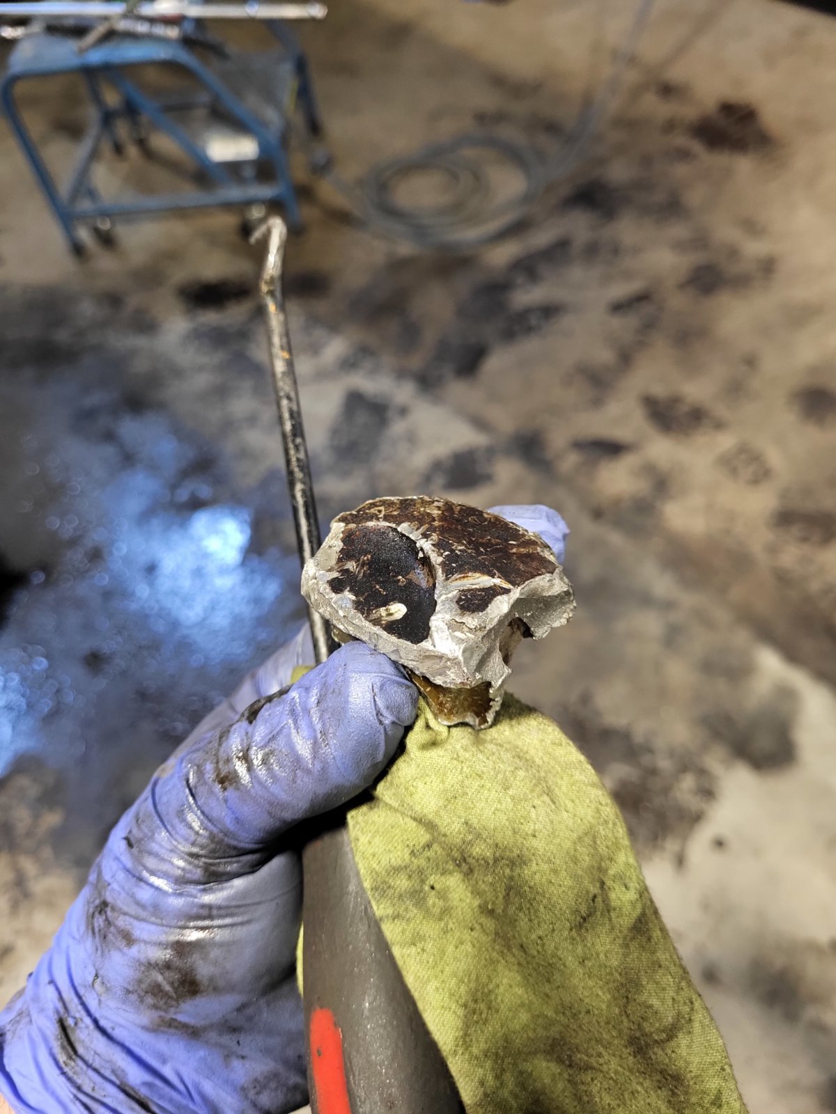

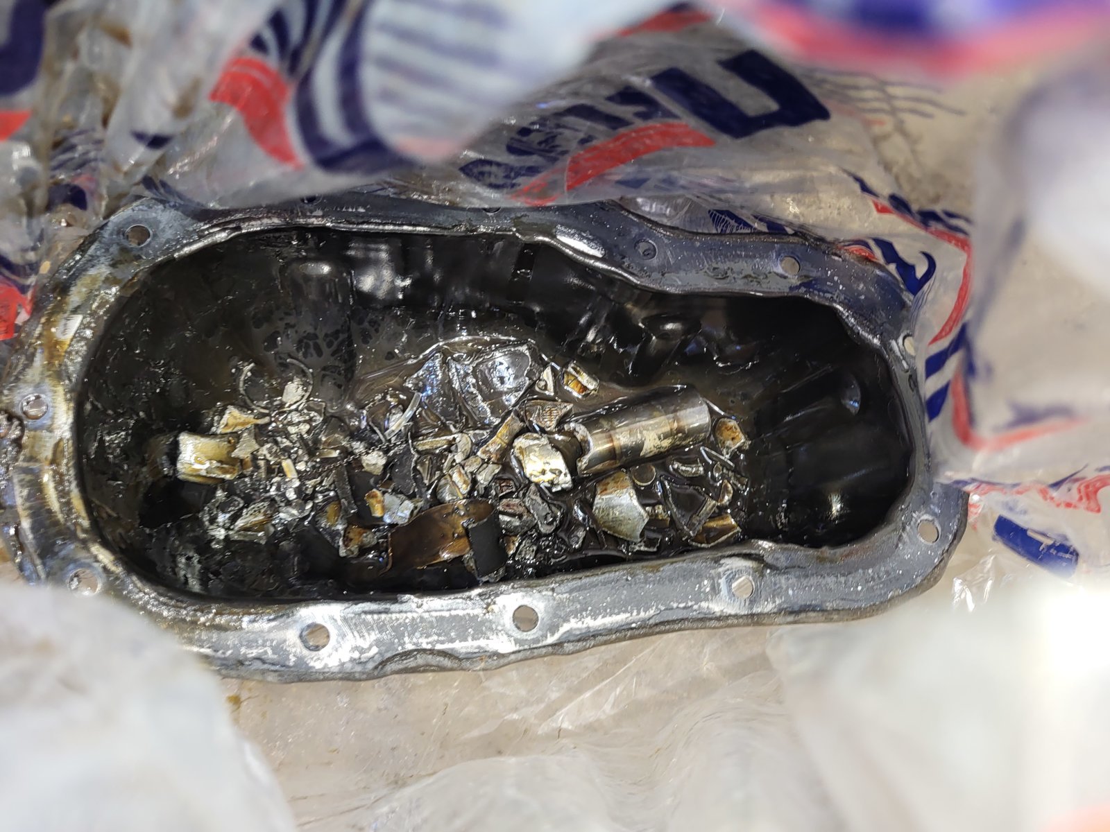

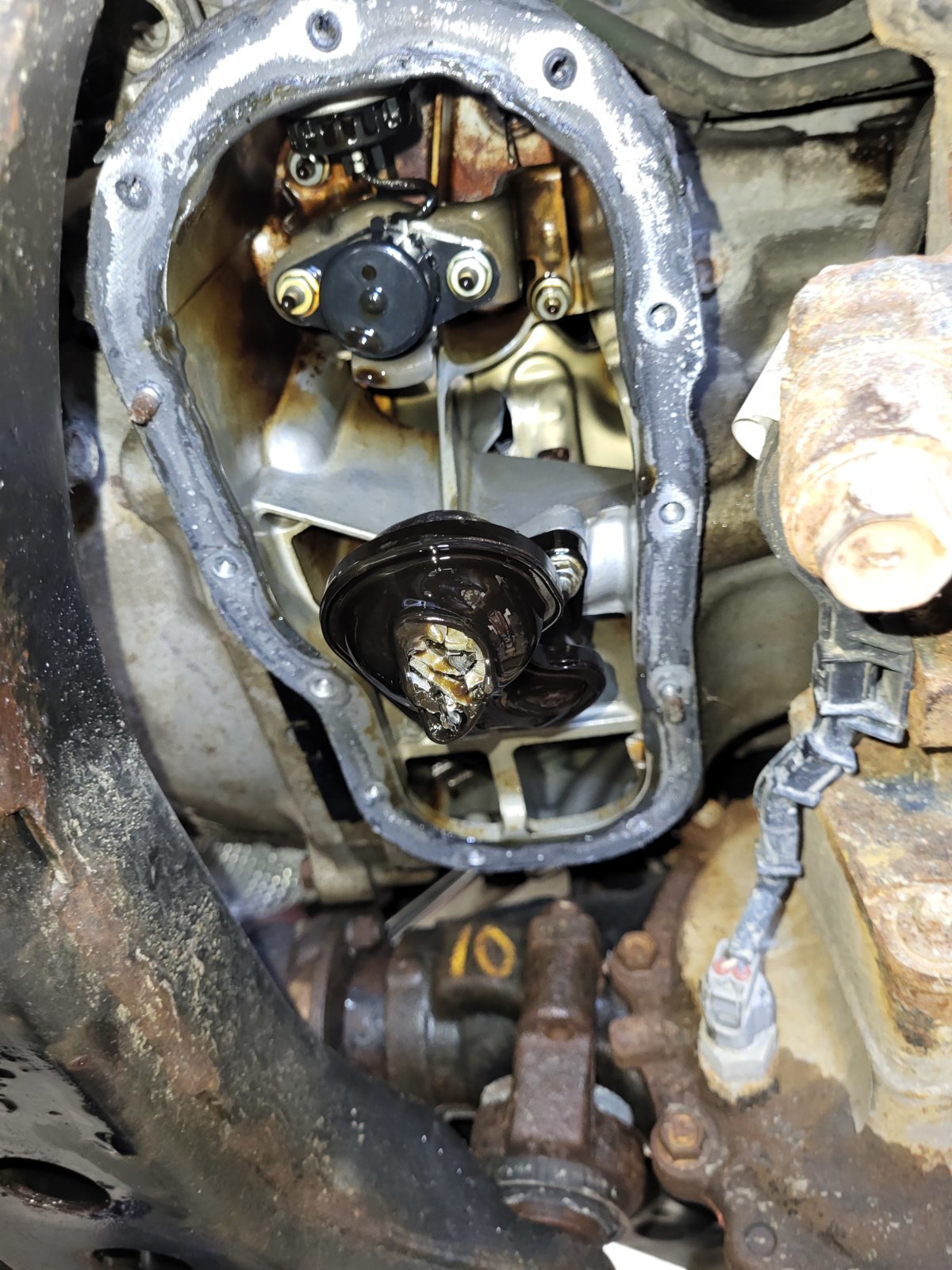

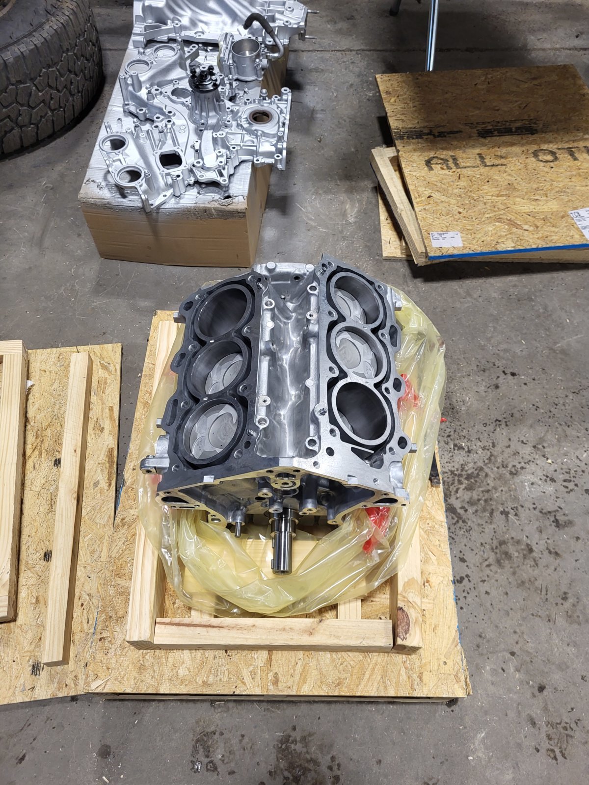

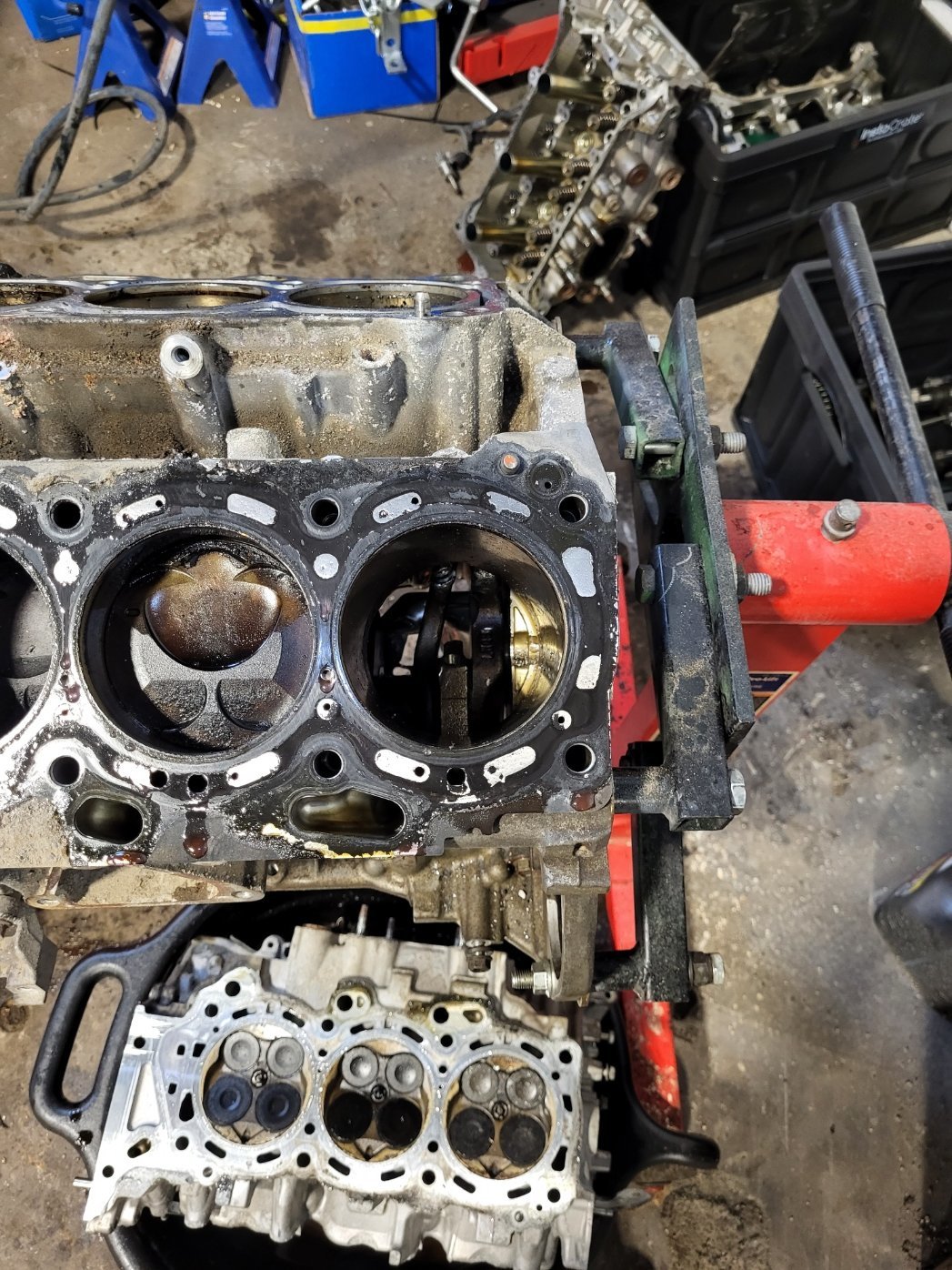

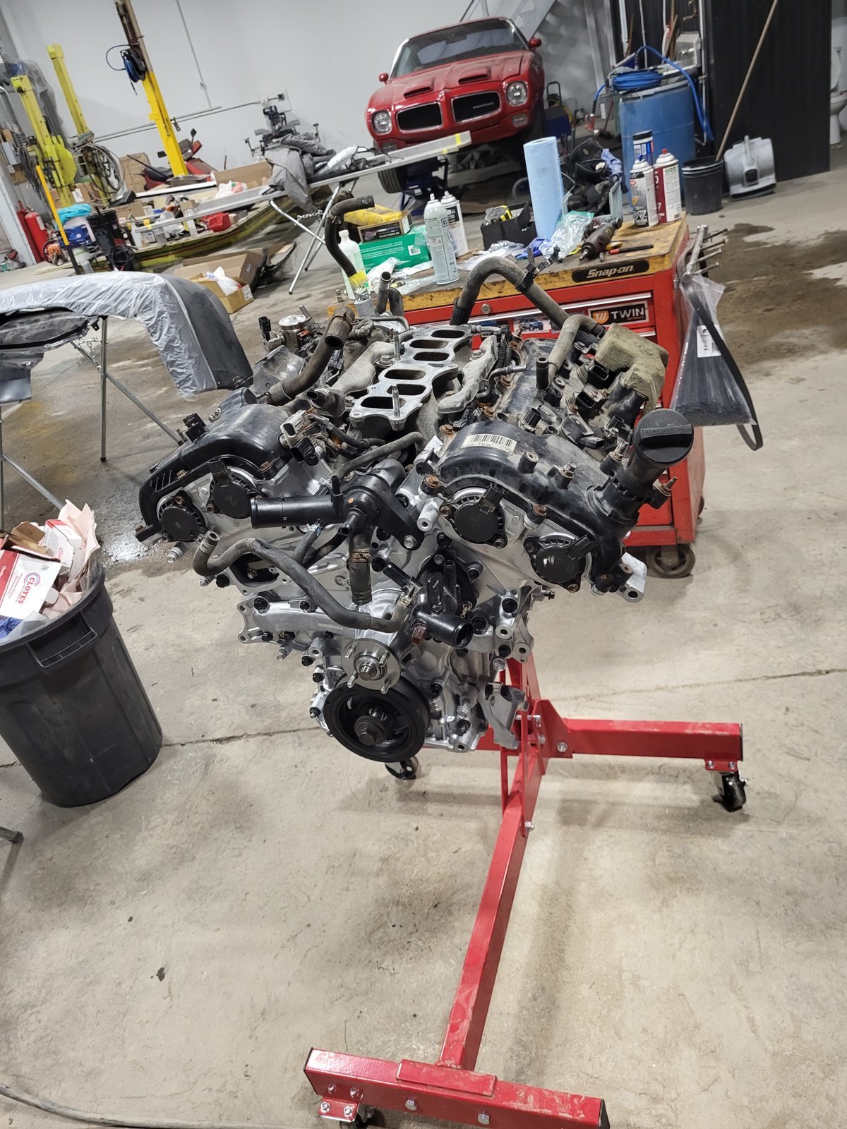

    hi, this is my first post.
    only to show you an other 2gr-fks issue with cyl 5-6. (150 000km engine)
    but with a lot more damage.
    ive rebuilt the engine with a new oem short bloc. +- 5000$CDN , 15k with all the labor and parts.
    ive found alot of silicone every where in the front cover and lower pan... maybe a rejob from toyota on warranty...
    drvn, shakerhood, TacoManOne and 6 others like this.
