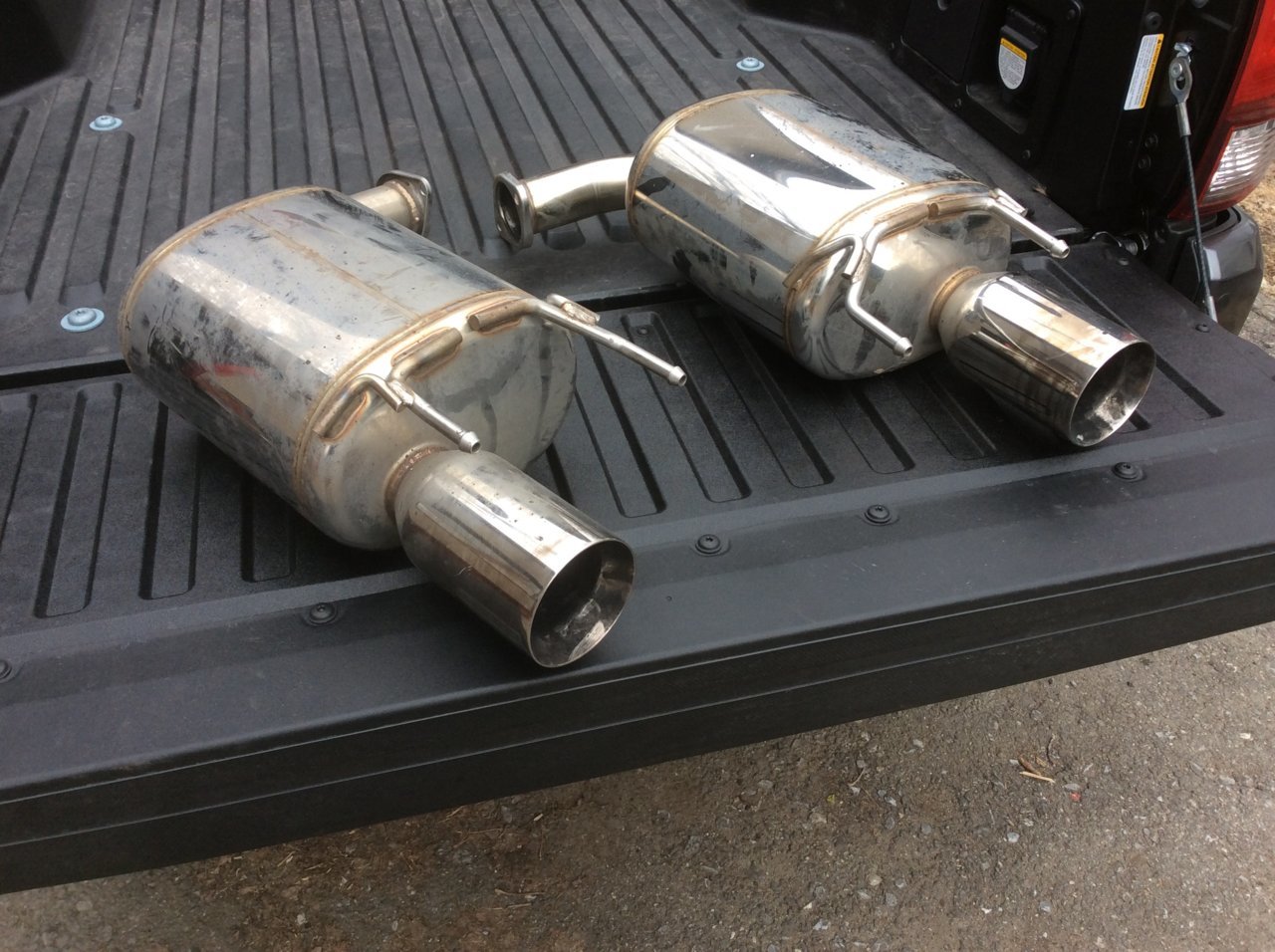

    As it sits, the formula is to utilize a factory IS350 H pipe, factory IS350 mid pipe resonators, and Lexus/HKS F Sport accessory rear mufflers. These rear mufflers are a neat combo of a perforated tube absorption type in one muffler, and the second muffler is a Helmholtz resonator is its entirety. They seem to produce a very nice tune on the Lexus, and since we have a variant of the engine, it's a good place to begin.
    I snagged a nice set of used HKS mufflers off of eBay. The tips are 3.75", a bit much. Now to gather the upstream parts.

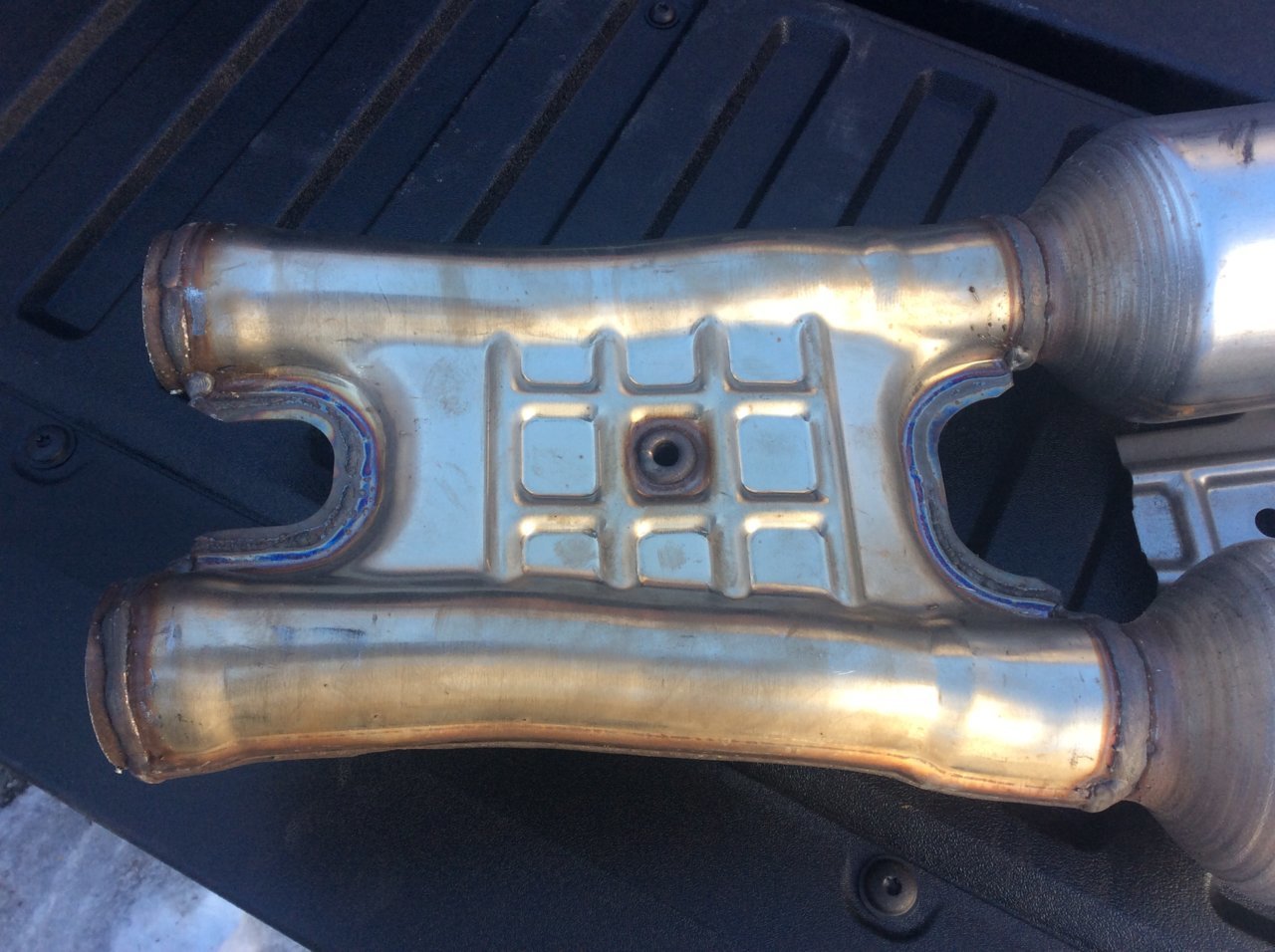

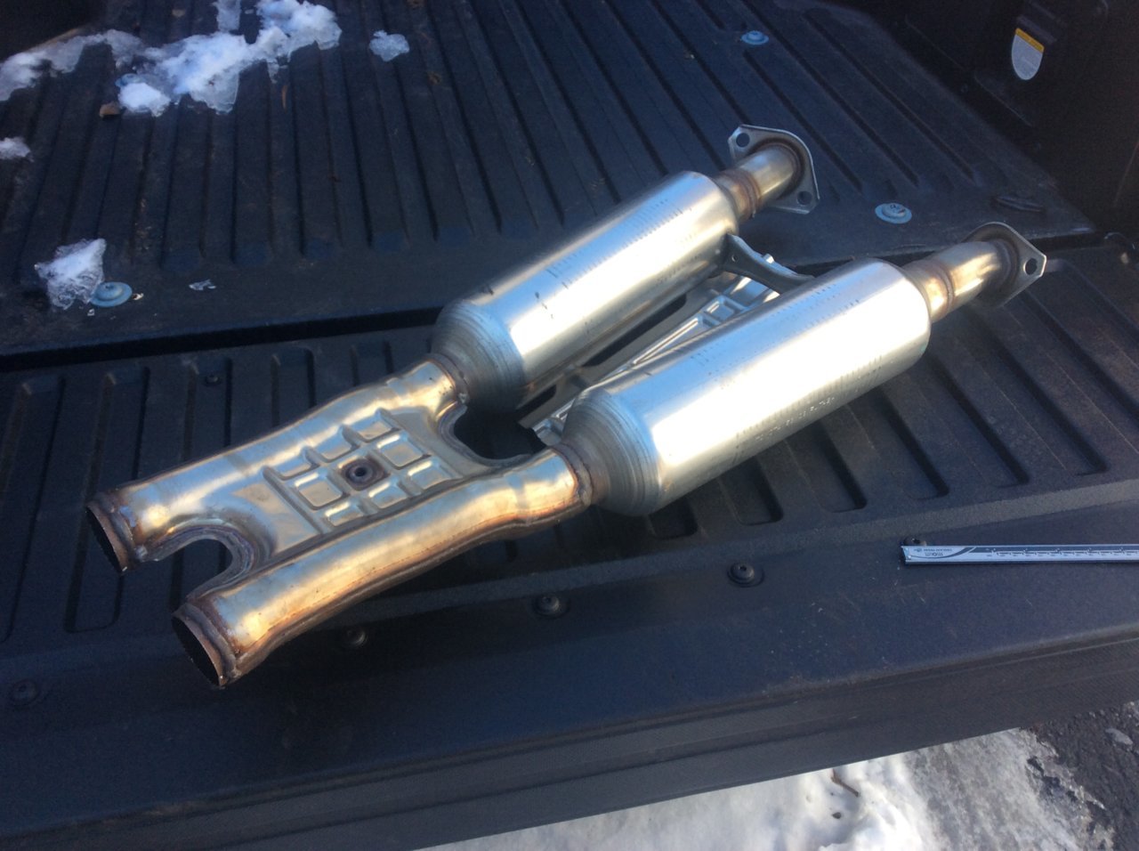

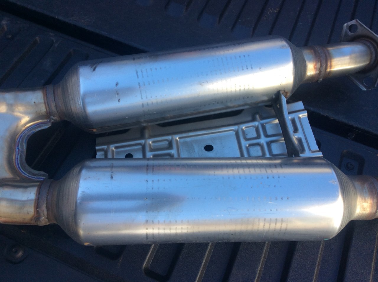

    Here are the factory H pipe and resonators. The interior of the H pipe looks exactly as the stamped exterior does, no baffles or perforations hiding in there, just a fat H... or maybe a squashed X? The resonators are straight through with a perforated core, as expected. Outer diameter of the H inlet is 2.13", the resonators are 2.21" in, 2.44" out.
