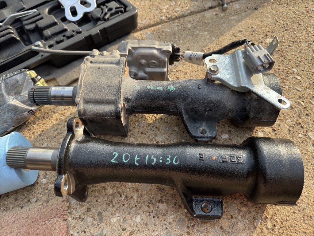

    It’s because the 2WD to 4H shift is not complete until the ADD is locked in. Only then will it allow 4H to 4L. So because you are sitting still and the ADD isn’t lined up, it won’t go until you move. So in theory you could shift across both modes, but the ADD would have to be in the perfect spot while you’re sitting, which is very unlikely.
    A lever to yank on is much preferred in my opinion. I don’t like the knob or ADD, but I got rid of the ADD and so now it at least shifts quickly electronically. Since I spoofed the ADD electronically, it will shift both times in one go.
    Technically, you could delete the ADD on a 2024 as well using parts from the full time 4WD Limited model. But the wiring connectors are not really easy to locate to build a harness for spoofing.

    Automatic disconnecting differential. It’s a coupler in the right side front diff tube that disconnects the right side axle shaft. This lets only the spider gears spin (driven by the left axle), instead of the front driveshaft and ring & pinion. Some see it as a benefit, I don’t really. It’s mostly done for CAFE/mpg related stuff.
    It’s not a terrible thing, it works okay but when it doesn’t work, it becomes a headache to deal with. Most problems are due to moisture, if moisture is kept out of the ADD actuator motor, it will probably live a good long time. Still makes shifts take an annoyingly long time to complete sometimes.
