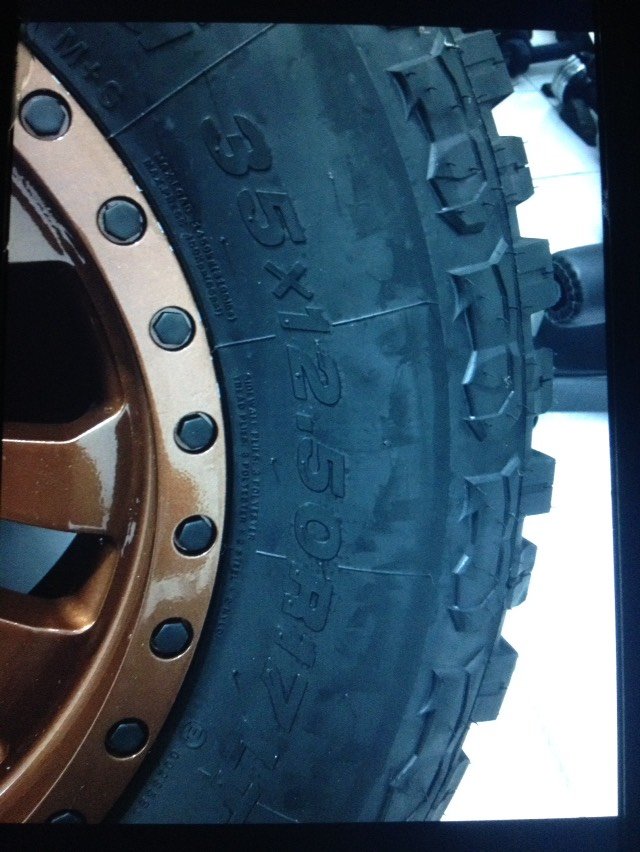

    I have a tire 35x12.5r17and would like to put a 2 in spacer on my 2004 toyota truck....will it be weird or nice to put a spacer.on it...i dont really know anything about spacers or cars 1st time to modify my truck..any suggestio s

    I don't think the problem is what size spacer; the problem is your tire. 35x12.5 is way too big a tire for a 1st gen. Truck wasn't designed to accept a tire that big.

    Are you talking wheel spacers or suspension spacers? I assume suspension, since I've never heard of a 2" wheel spacer, but you never know...
    As has been said, it's best to try and avoid spacers (of any kind). Get the proper lift coilover, or wheel backspacing (if we're talking wheel spacers). Spacers are just bandaid fixes.
    Area51Runner and frizzman like this.

    It wasn't designed to fit a 33 either... or even a 32...
    Plenty of people have 35s, but you need to do a lot of cutting of the fenderwell/body mounts to fit them.

    35 12.5 is huge for a first gen. To fit them properly you’ll need a whole new strut, like a Toytec BOSS at least and tubular upper control arms along with lots of cutting and tubbing the wheel well and probably some of the bumper plastic.
    As for as weel spacers it depends on your current backspacing.

    i run 2" wheel spacers and 35s. spacer argument has been done many times before. if theyre quality spacers they arent an issue. there arent too many wheel options with the right bs to keep 35s off the frame for our trucks ive found.
    even with 3" lift you cant even turn on flat ground with 35s and no cutting ahaha.

    With spacers, you're putting a lot of additional torsion load on your ball joints etc. That is an issue with physics, not spacer quality/price. Certainly, cheap spacers that don't fit right make the issues worse, but high quality spacers don't eliminate them entirely.
    Even a "correctly" backspaced wheel, if it exists, puts a lot of excess stress on the suspension when you move the whole wheel 2" outboard.
    We all make compromises based on budget, fabrication skill, intent of use, etc... given the issues with our lower BJs, I'd just assume minimize excess stress when possible.
    So it depends on what you want to accomplish. If you want true offroad performance, spacers aren't the way to go, and either long travel or a solid axle are the best way to increase your track width. But if you're just after looks and street driving, they're probably fine.
