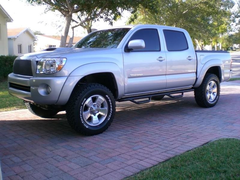

    Hey guys First off Im a newb and this is my first post. My problem is Im at a lost with what look I am going for with my taco. Im looking to run 265/75 R16
    Nitto trailer grapplers or BFG All terrains and keep my stock rims on my '14 DC 4x4. Just looking for that super stock look. I am also worried about warranty issues. Im not sure I need a 3in vs the 2in leveling kit from tuff country. Im not sure who's truck this is but it is exactly what lift and tires im looking for.. Any help would be appreciated4496324237_cd33620a0f_o.jpg

    Looks like a stock rear and inch and a half front lift.. Don't get tuff country. I'd do bilstein 5100's set at 1.75 in the front. Or OME 883 coils.
