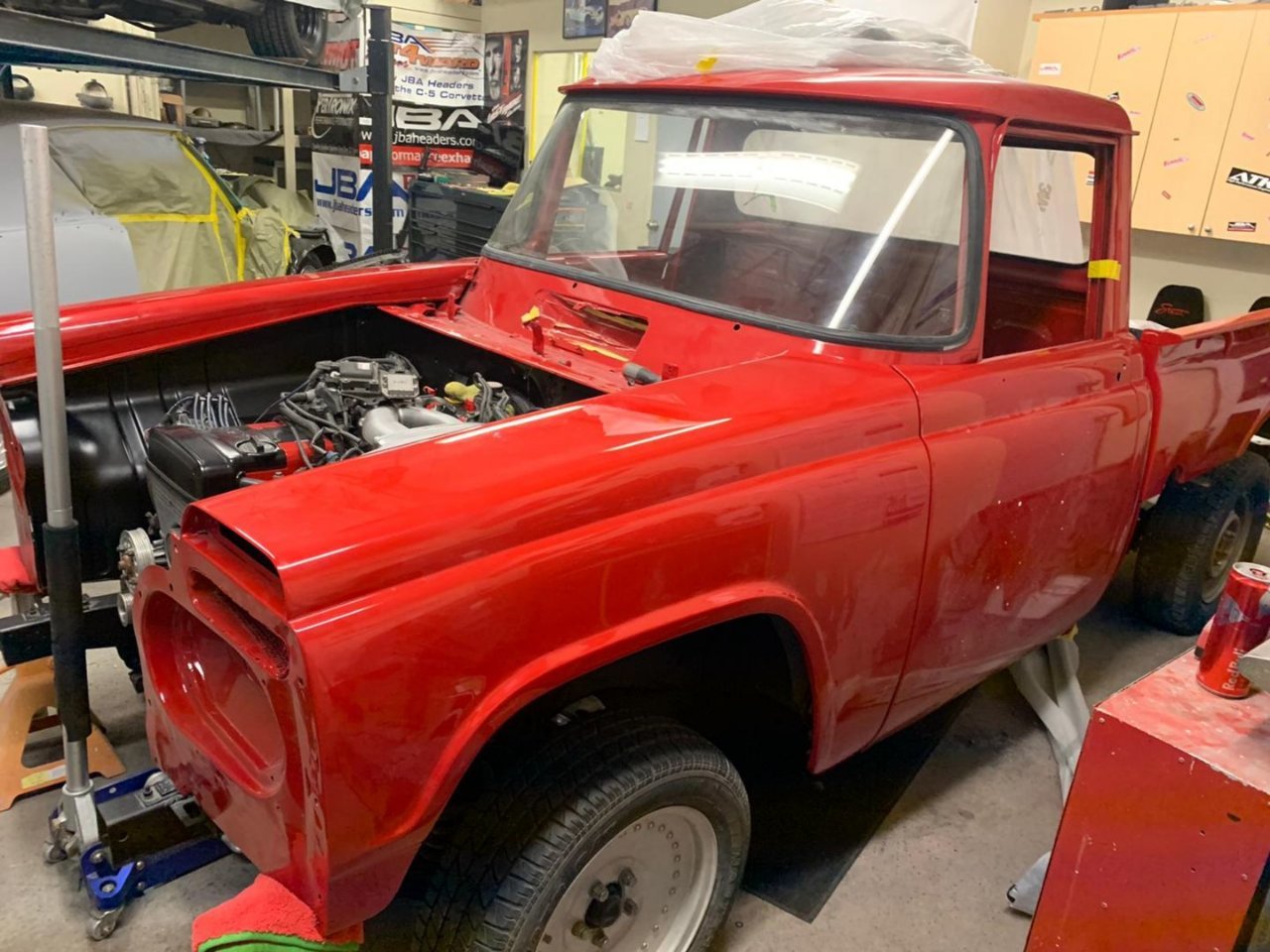

    Not to thread Jack but this reminds me of my current project. 67 Toyota stout with a 2jz.

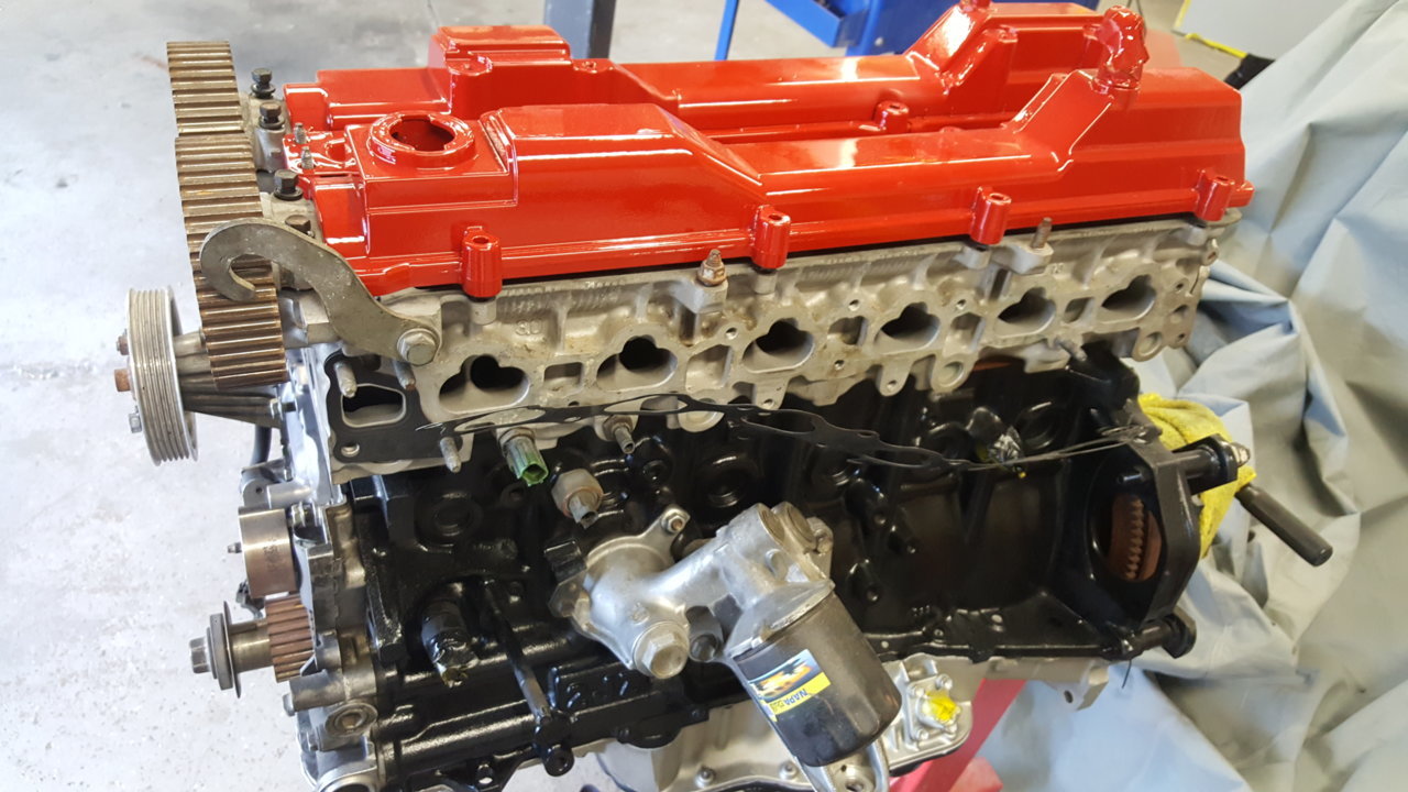

    Pic of engine

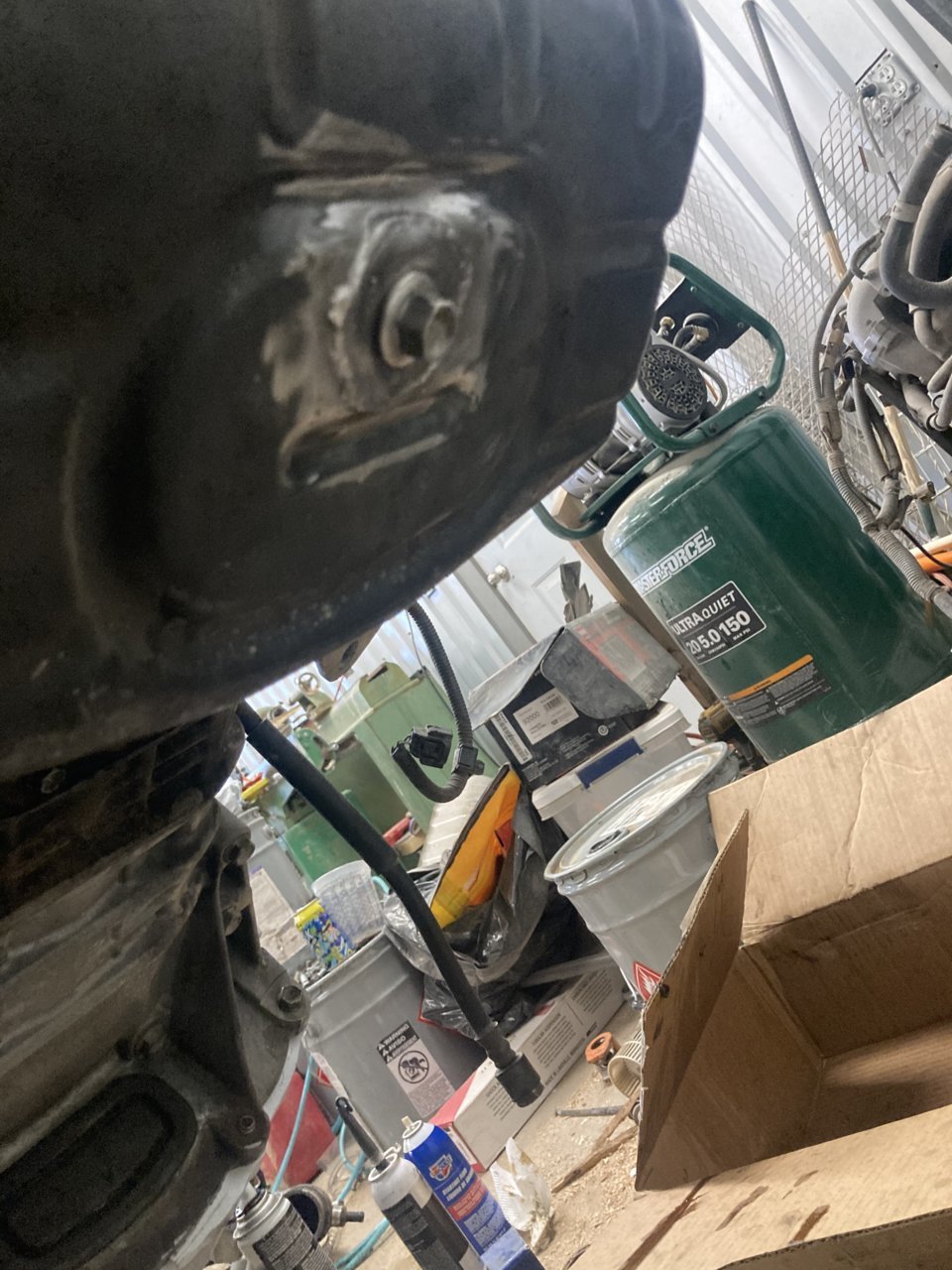

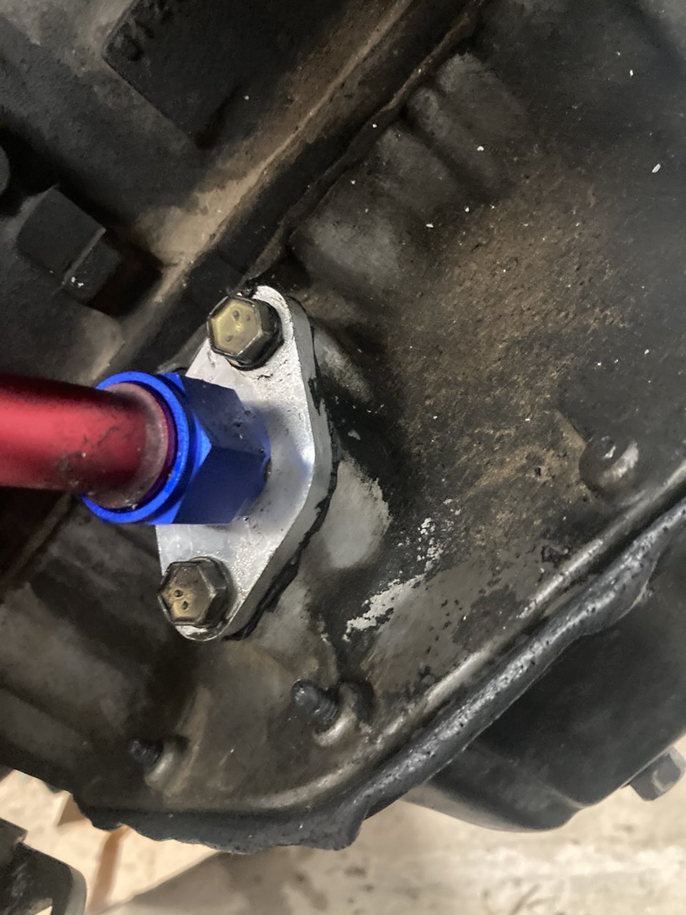

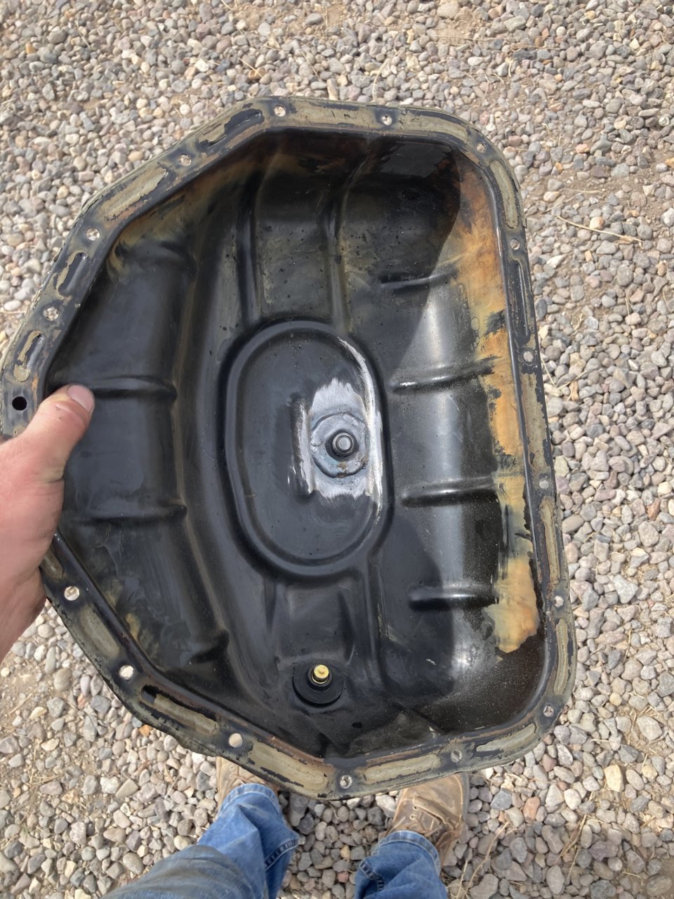

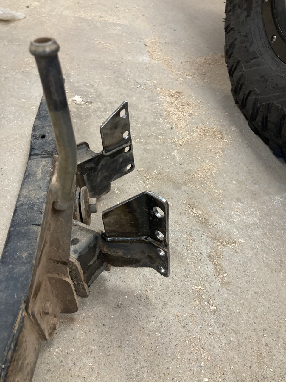

    I got my motor in for good I hope now. Here is some pictures of modifications I had to do. upload_2021-5-1_23-34-34.jpgupload_2021-5-1_23-34-34.jpgupload_2021-5-1_23-34-34.jpgupload_2021-5-1_23-34-34.jpg
    I had to modify my transmission mount. And drill in my turbo oil return line. I also added a new oil drain in the pan that I could access.

  17. May 1, 2021 at 10:39 PM

    I also deleted my brake booster. I don’t know if it will still stop good. But it was in my way. I will show more pictures tomorrow.

    Dang that’s some quality work man! Thanks for sharing

    Thanks to a couple of my brothers. It’s wouldn’t be really possible without them. I don’t know how to weld smooth enough to do it. I think it’s turning out good.
