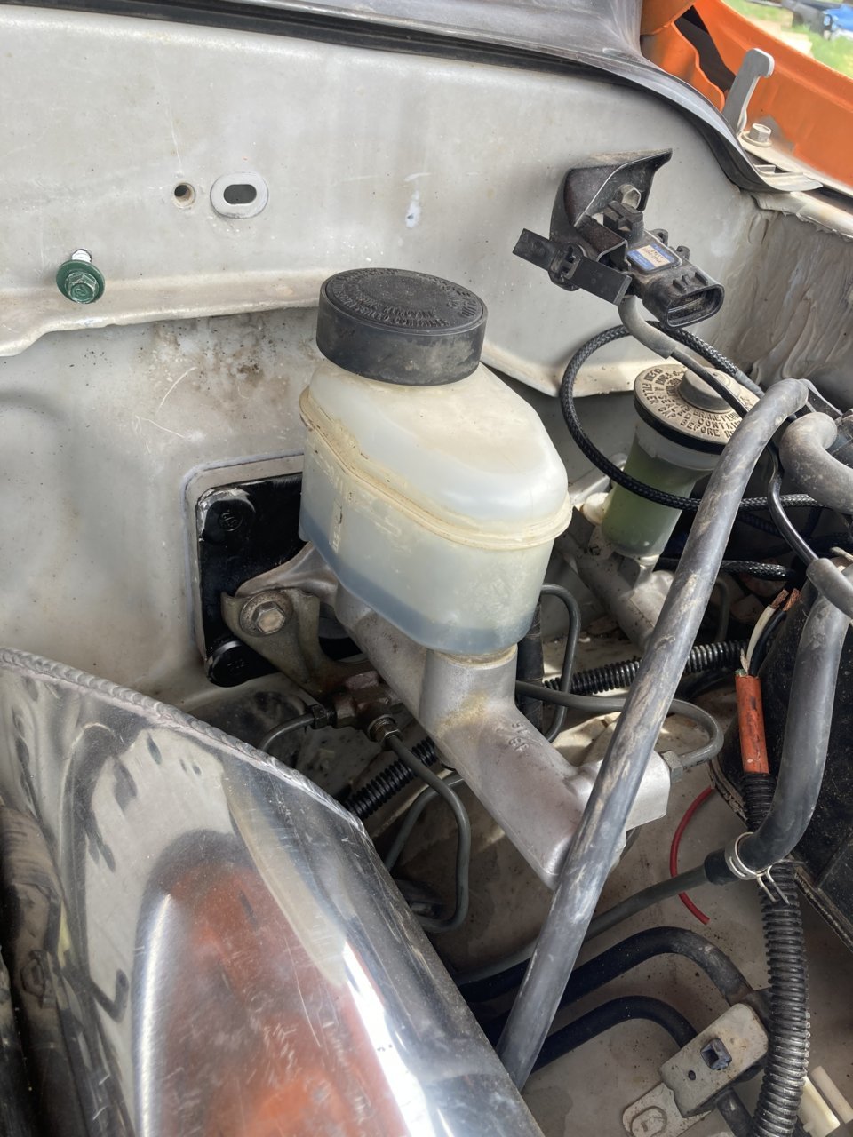

    here is a couple more pictures. Hopefully my brakes will work okay like that. I just couldn’t fit it any other way. Now I am waiting on my turbo manifold from cx Racing.

    I think you will be ok with the brakes as long as you have a strong foot, the booster just multiples the force put upon the master so you have to put little effort to apply the brake!

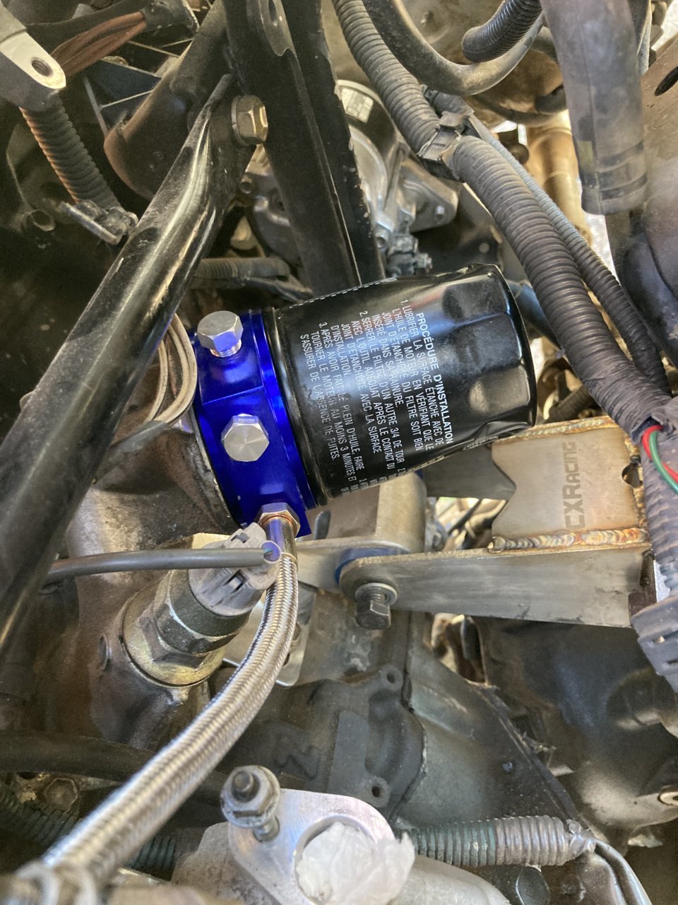

    I have had to peace together my turbo kit. Next time I would just buy the whole turbo kit for the Lexus GS300

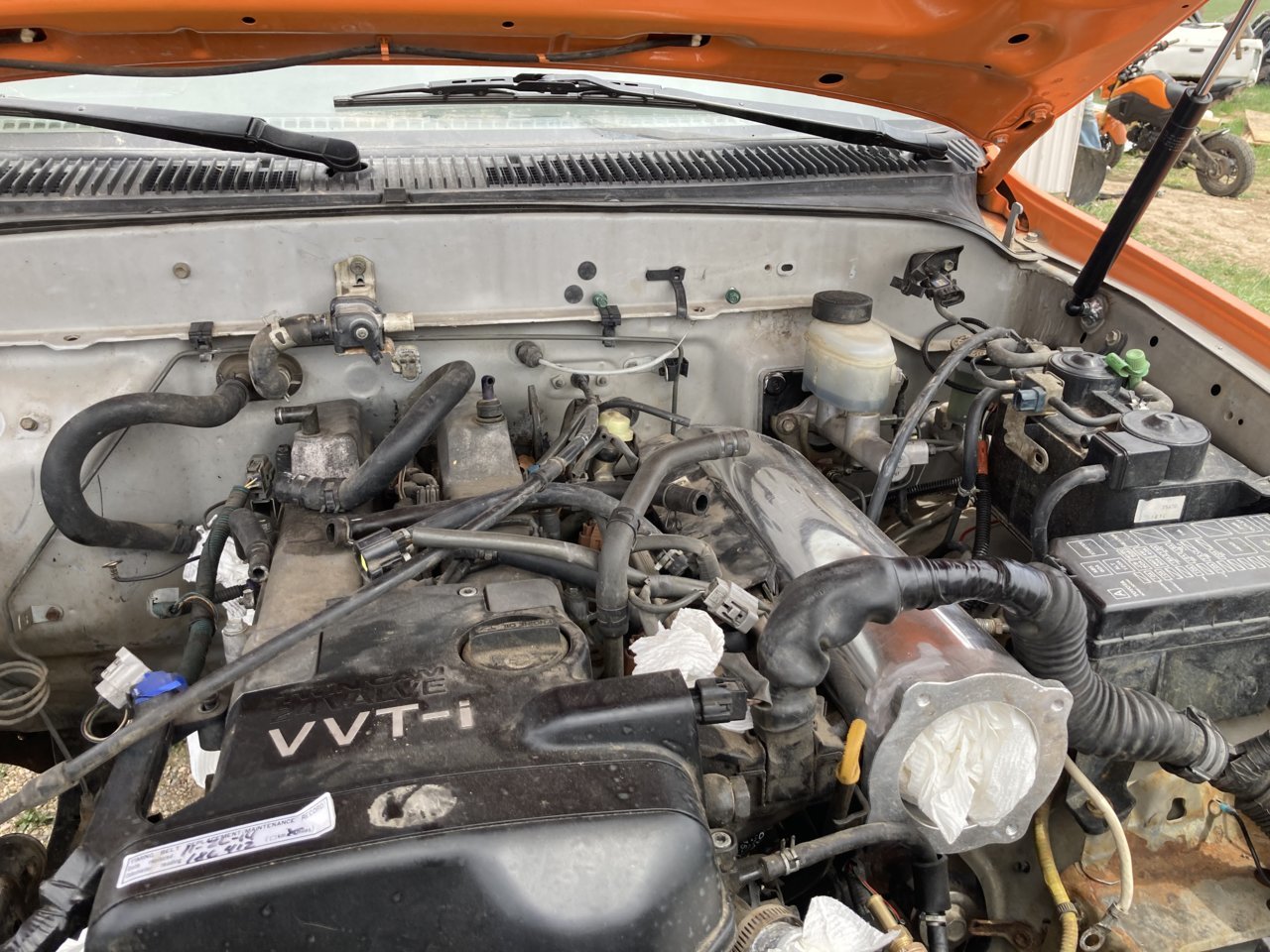

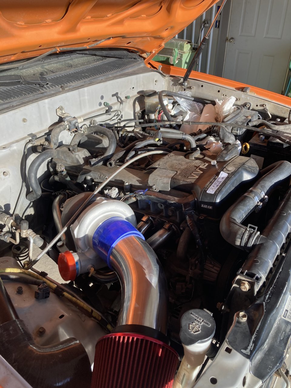

    I finally got my turbo manifold. It’s looking good

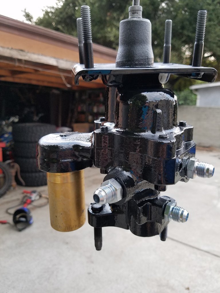

    If you are having troubles with your brakes, I found for my swap I was able to clear a hydroboost unit which is a lot longer but narrower than a vacuum booster.

    Interesting, what unit did you use?

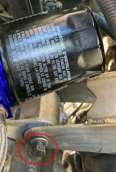

    One more item for the To Do list:

    It was out of some 89' GM truck, but I hear the go to (from pirate 4x4 I think I heard it from) is an Astro Van hydro boost unit.

    To start off, AWSOME build you got going on there. I will try and run it like it is. If not I could probably go that route. Do you have to put a different pump on the motor to run it?
