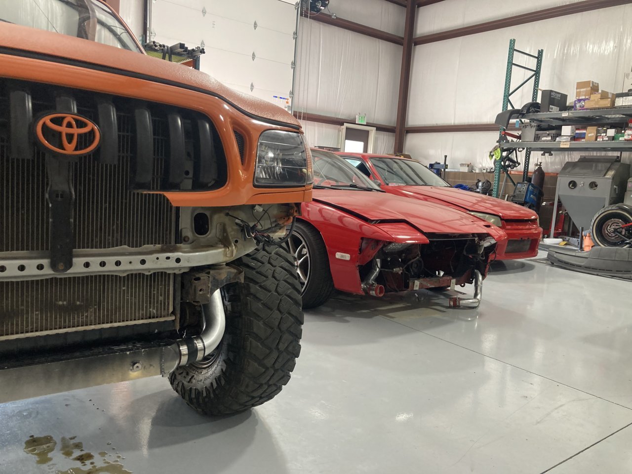

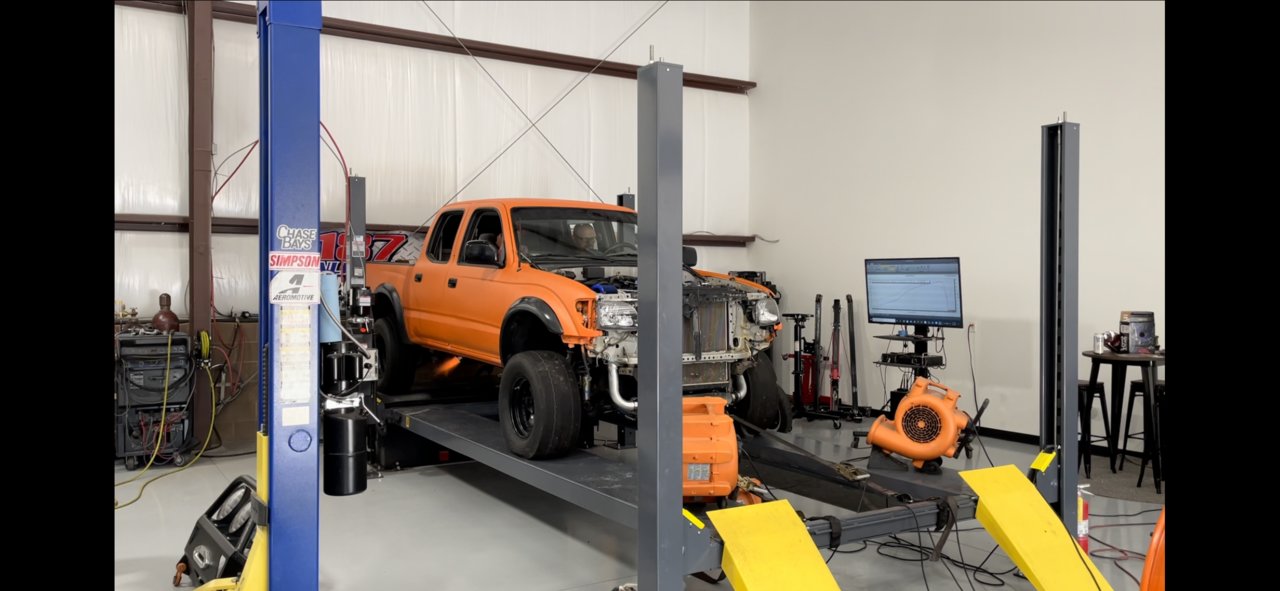

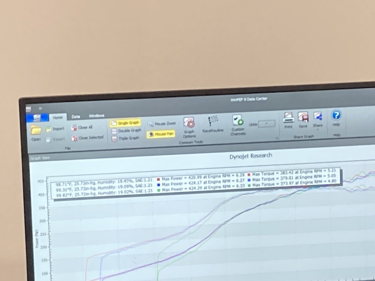

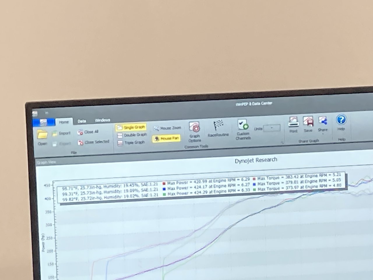

    she is alive. Runs 424 hp. 12 psi boost. I love it so freakin much. Definitely worth the money spent. It’s sounds so freakin goodupload_2021-7-4_10-52-31.jpgupload_2021-7-4_10-52-31.jpgupload_2021-7-4_10-52-31.jpg

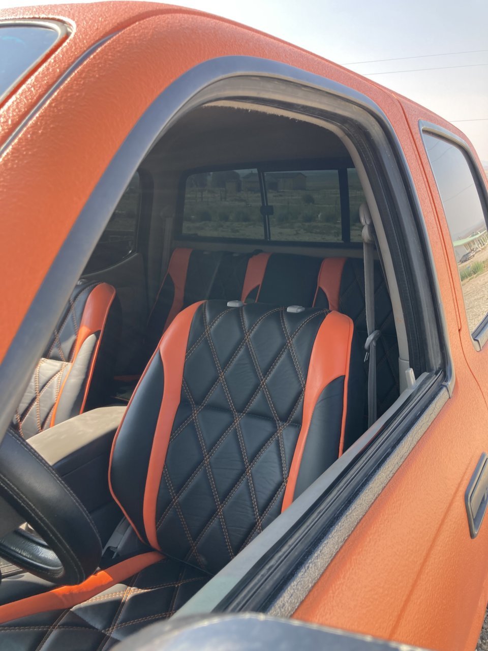

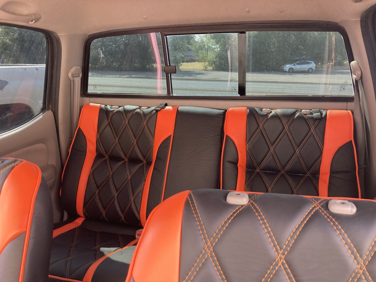

    my seats are getting reupholstered right now. They look sick. It’s real black leather. I tried to get really orange leather but everything I ordered came way to dark orange. So this is a good vinal. What do you all think about it? I’m putting my truck in my local car show on the 24th of July

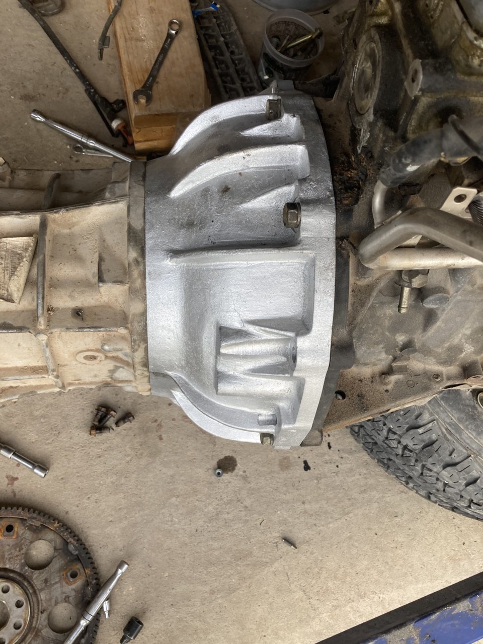

    What trans are you running?

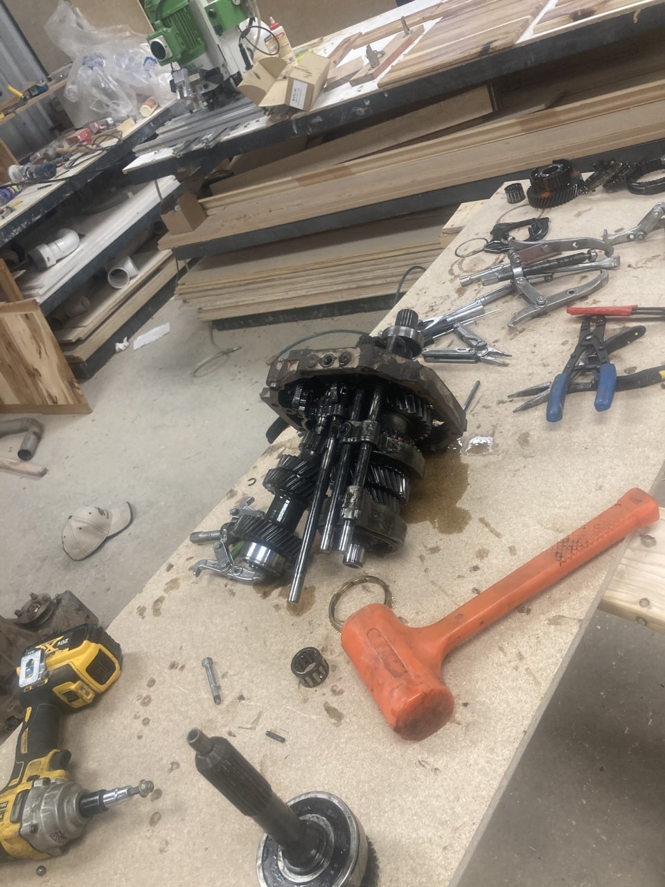

    It’s a r150f from a 3.4 I pulled it apart and put a shorter in put shaft in and got a bell housing it bolt to the 2jzupload_2021-7-8_17-16-19.jpg

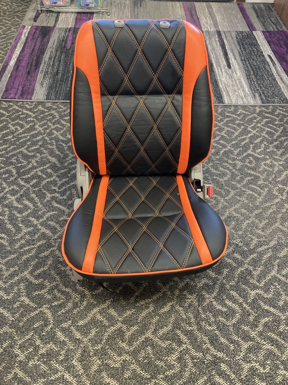

    upload_2021-7-10_17-34-22.jpgupload_2021-7-10_17-34-22.jpgupload_2021-7-10_17-34-22.jpg
    My seats are done besides my head rests. What do y’all think. I love them. They are real leather

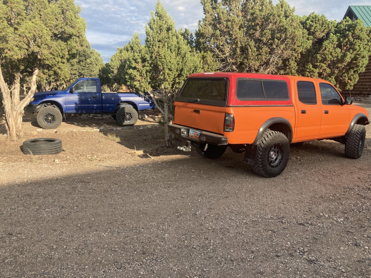

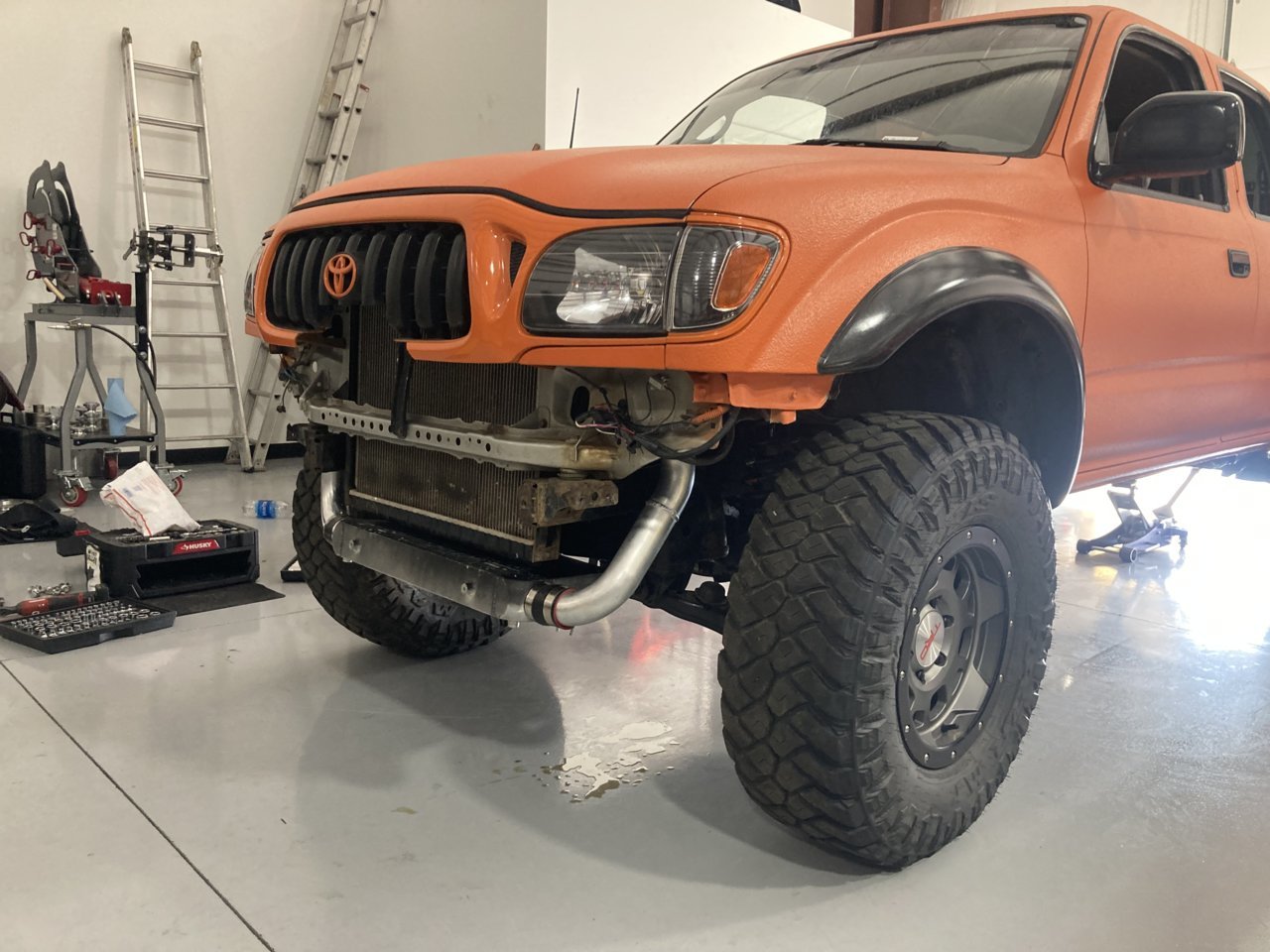

    upload_2021-7-28_20-13-59.jpgupload_2021-7-28_20-13-59.jpgupload_2021-7-28_20-13-59.jpg

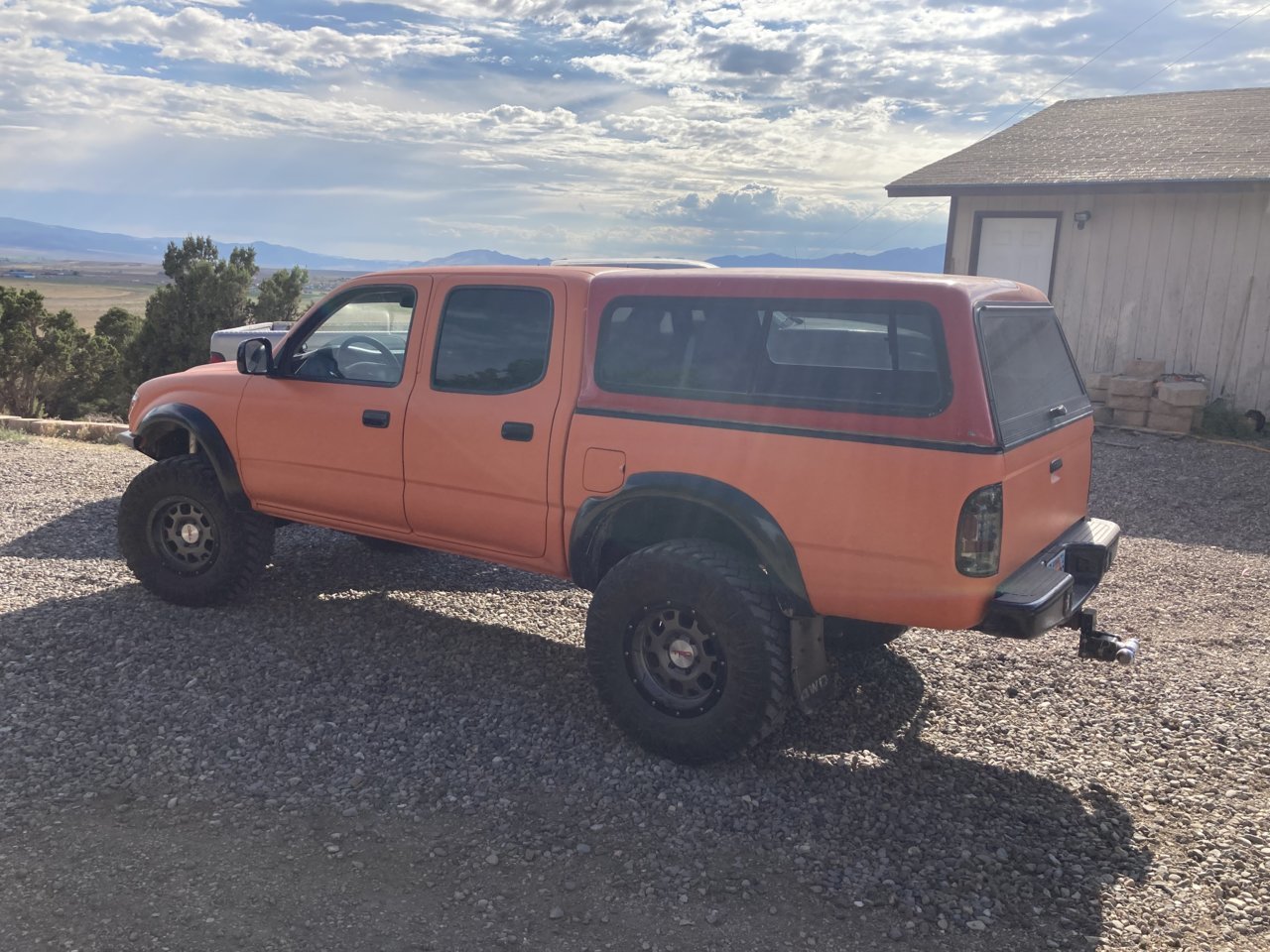

    I just picked up a 200$ camper shell. I will rhino line it to match.

    6,997
    devin
    lewisporte Newfoundland
    2023 aclb trd or mt
    icon stage 10 kit, toytec 1" bl, 35" general x3s, 17x9.5 procomp wheels, locker anytime mod, s&b intake, blackhawk 2.1 tune,
    setup not dynod. enough to slip auto trans at 15-16psi. Ive seen other setups start to get close to the 400whp number at this boost level. I daily it at 8psi and only turn it up on occasions. I believe these engines are at their absolute limits at that 400whp mark. definitely keep it short runs and lots of meth keeping iats super cool and effective octane up. lce will sell rods/pistons/headstuds to go who knows how high. in the early 2000s there were a couple 5vz builds getting close to the 1000hp mark. dont think ive ever seen it achieved though
