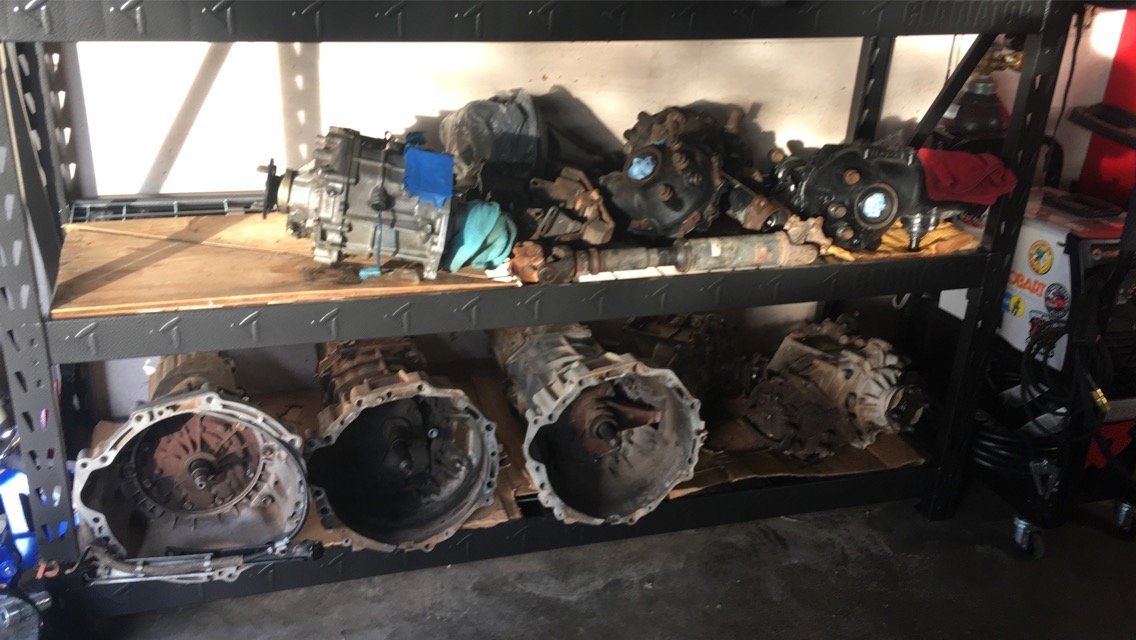

    A lot of it varies by location. The nearest R150F that was verified functional was in Oklahoma (guy was going to use it on his 2JZ FJ80) when I was looking for one in 2019. I crawled Craigslist and Facebook for 2-3 months and visited local yards. If an R150F goes up for sale in Texas chances are it's already on it's way to Mexico in an hour or two.

    I actually have an extra one sitting. I told my younger brother if he will get a double cab I will manual swap it for him. I should keep my eyes open around here they are pretty easy to find.

    I have 3 including one in a truck. I'm selling one to someone on TW in south TX. Other one was full of mud when I bought a ranch truck. Far left is an A340F with an A340E output shaft. Doubt the mud one is even worth sending to Marlin as a core. I'll stop spamming your build thread now lol.

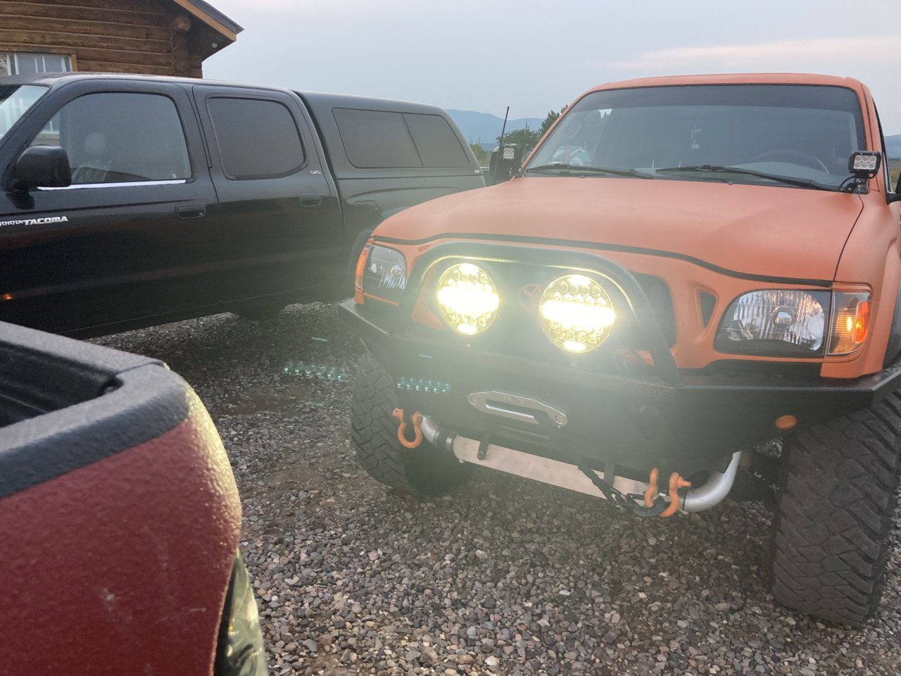

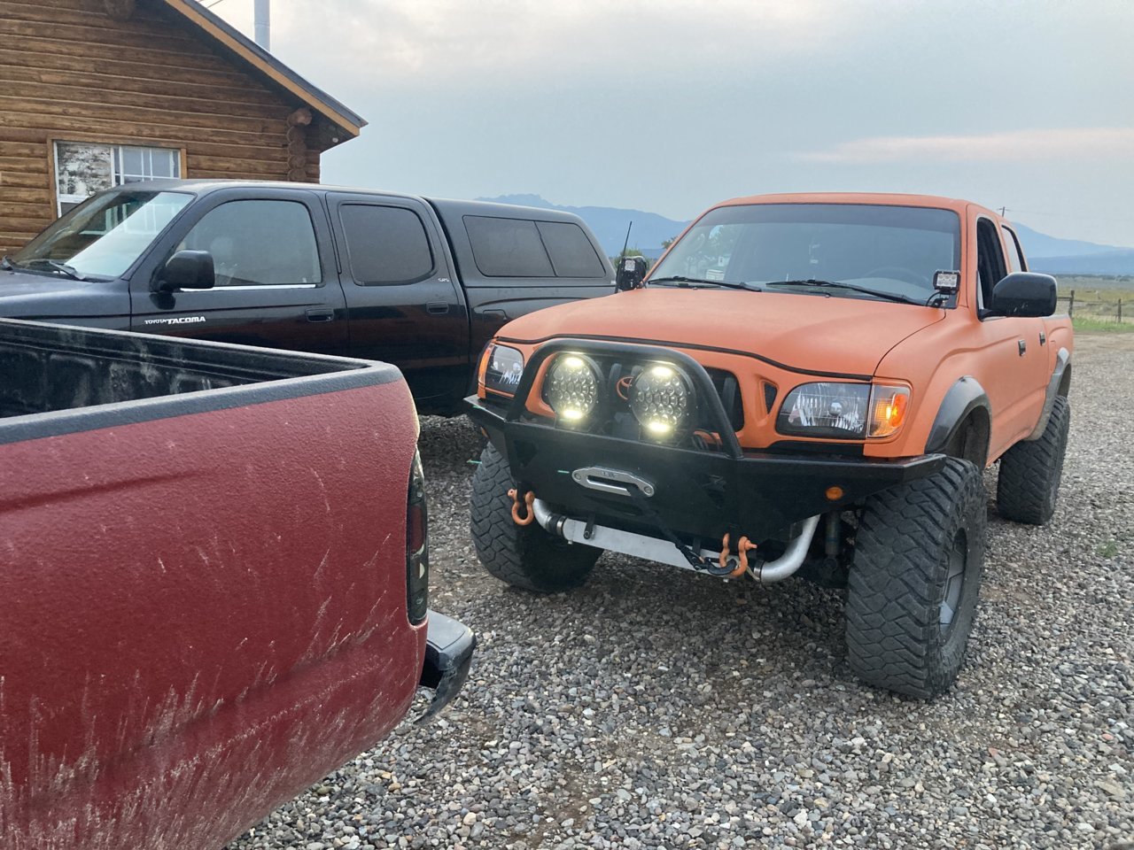

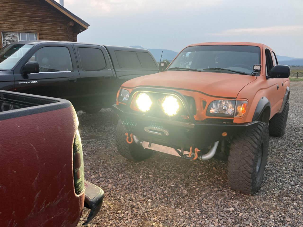

    Awesome swap! definitely, something I could get into with mine. What lights are those on your bumper

    AUDEXEN 300W 9 Inch Round LED Work Light, Pod Lights Built-in EMC, High/Low Beam Driving Lights with Adjustable Mounting Bracket Compatible with Jeep Wrangler Off Road 4x4 Truck ATV SUV - 1 PCS https://www.amazon.com/dp/B083DN5Z2K?_encoding=UTF8
    I really love the way they shine. upload_2021-9-1_20-4-30.jpgupload_2021-9-1_20-4-30.jpgupload_2021-9-1_20-4-30.jpg
