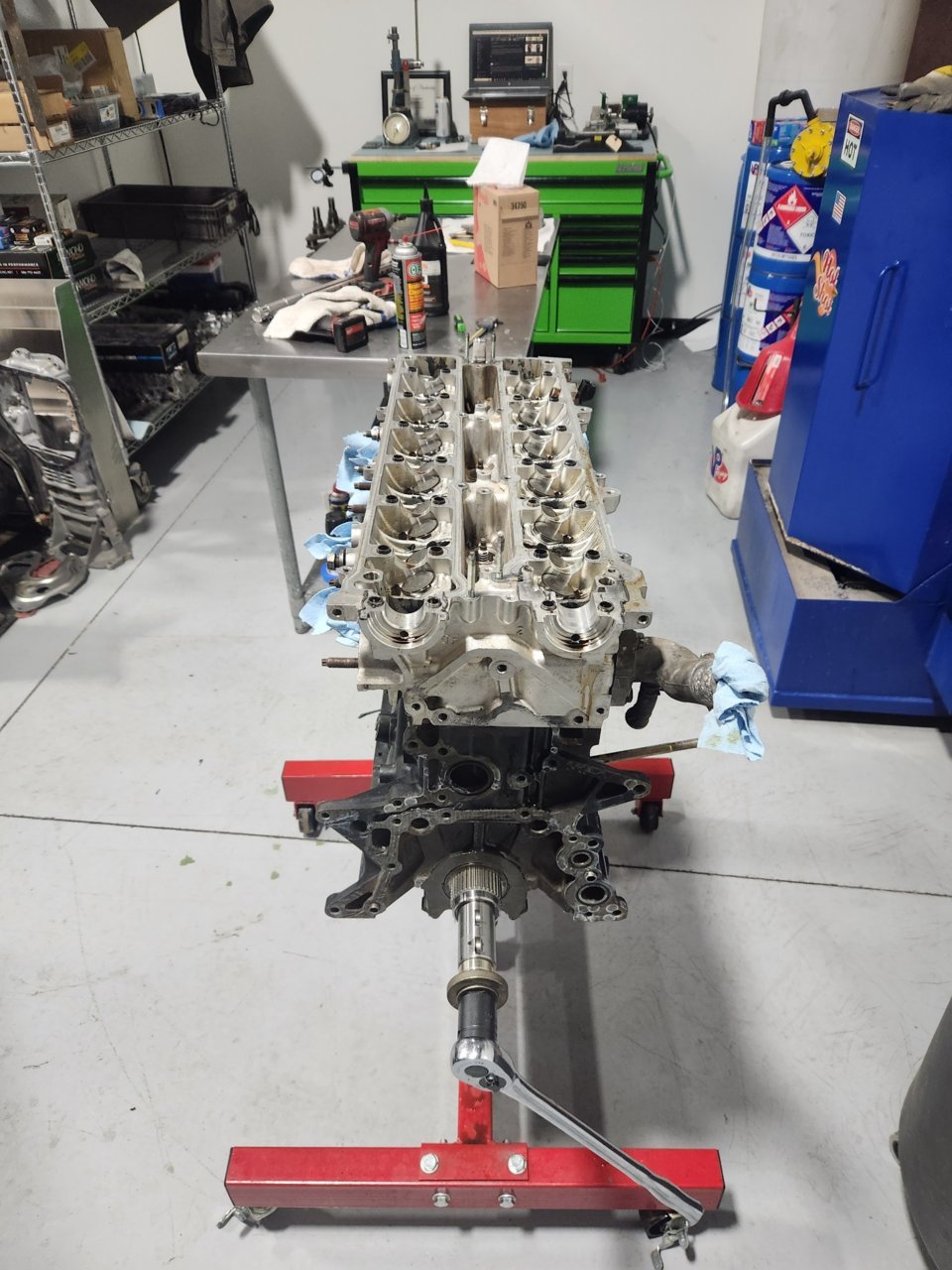

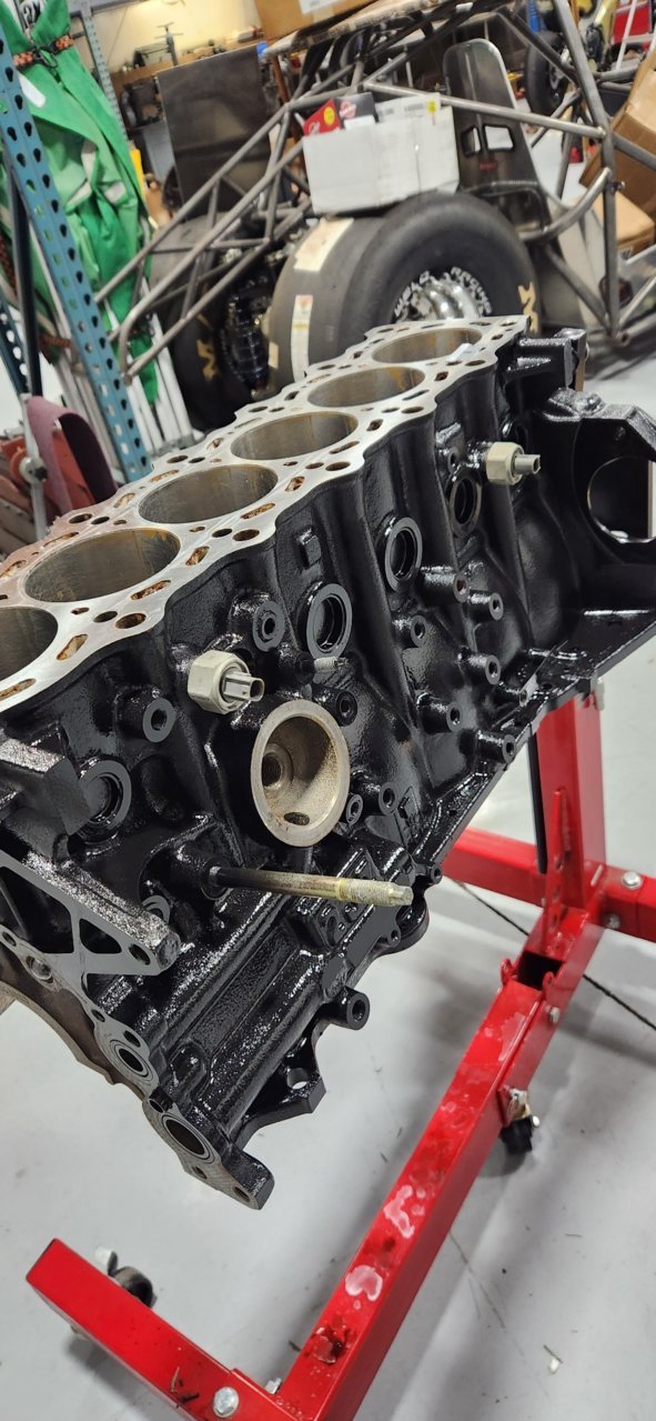

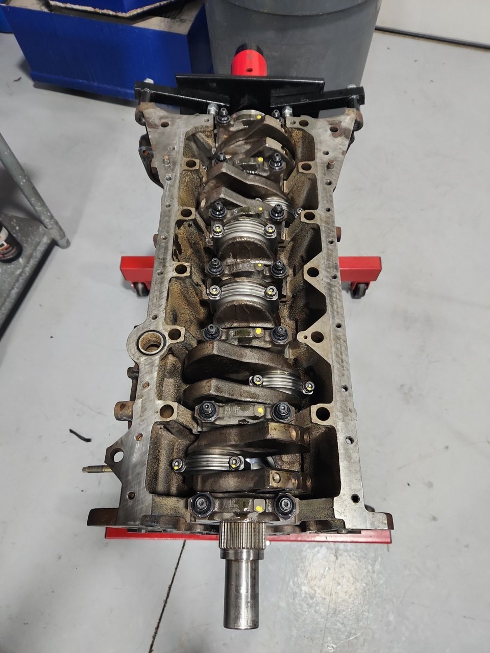

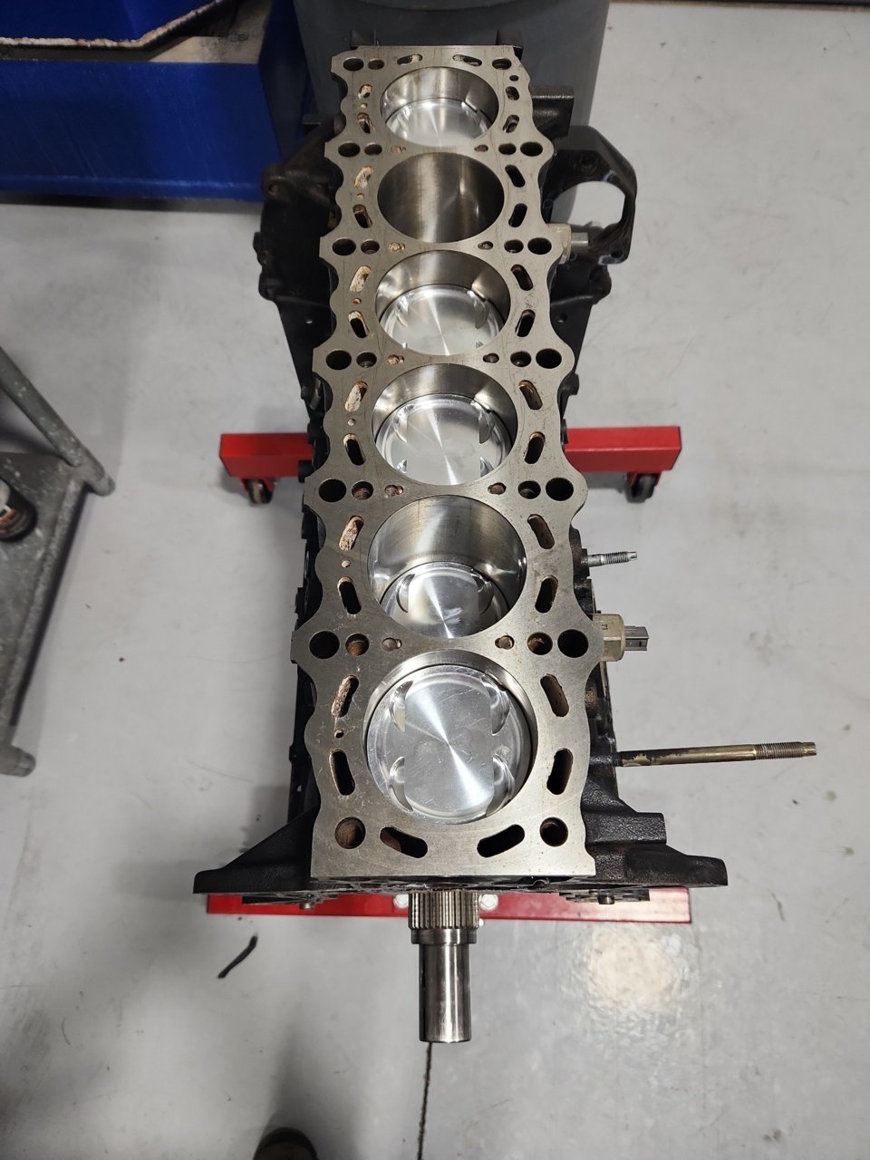

    my motor is almost done get rebuilt/ built better. I torched a piston a couple months back so now I am just finally building the motor. It should be able to handle 850 hp. I don’t think the rest of the truck could ever handle that. But it will be nice to know It’s tough enough. I will probably leave it where it was at around 420 hp. Maybe ad a little boost to get 450. I’m talking about selling it. Is there anyone interested. I will post more pictures when it’s fully back together.

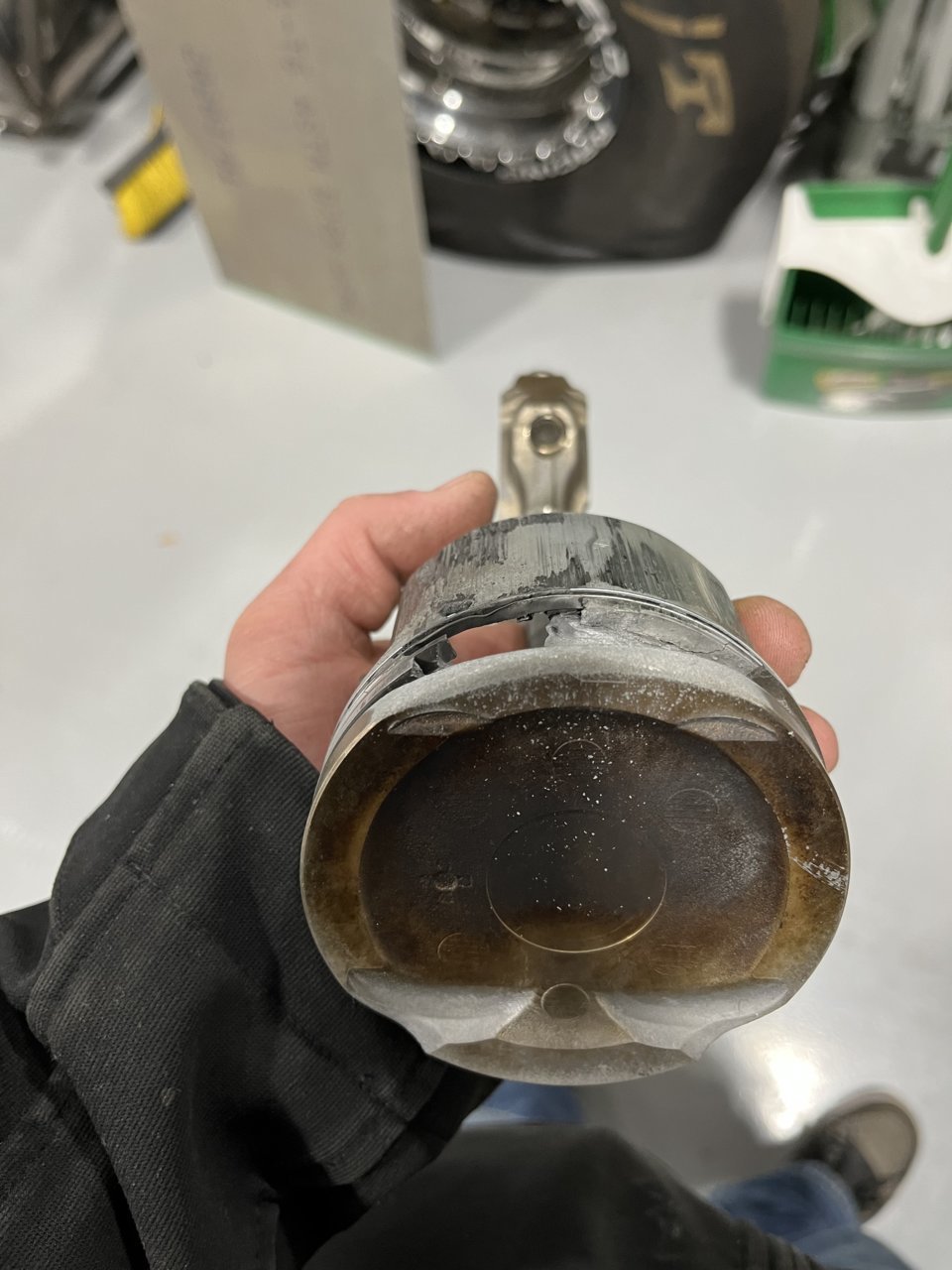

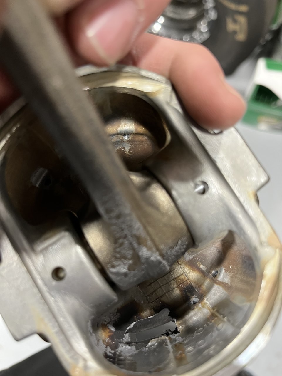

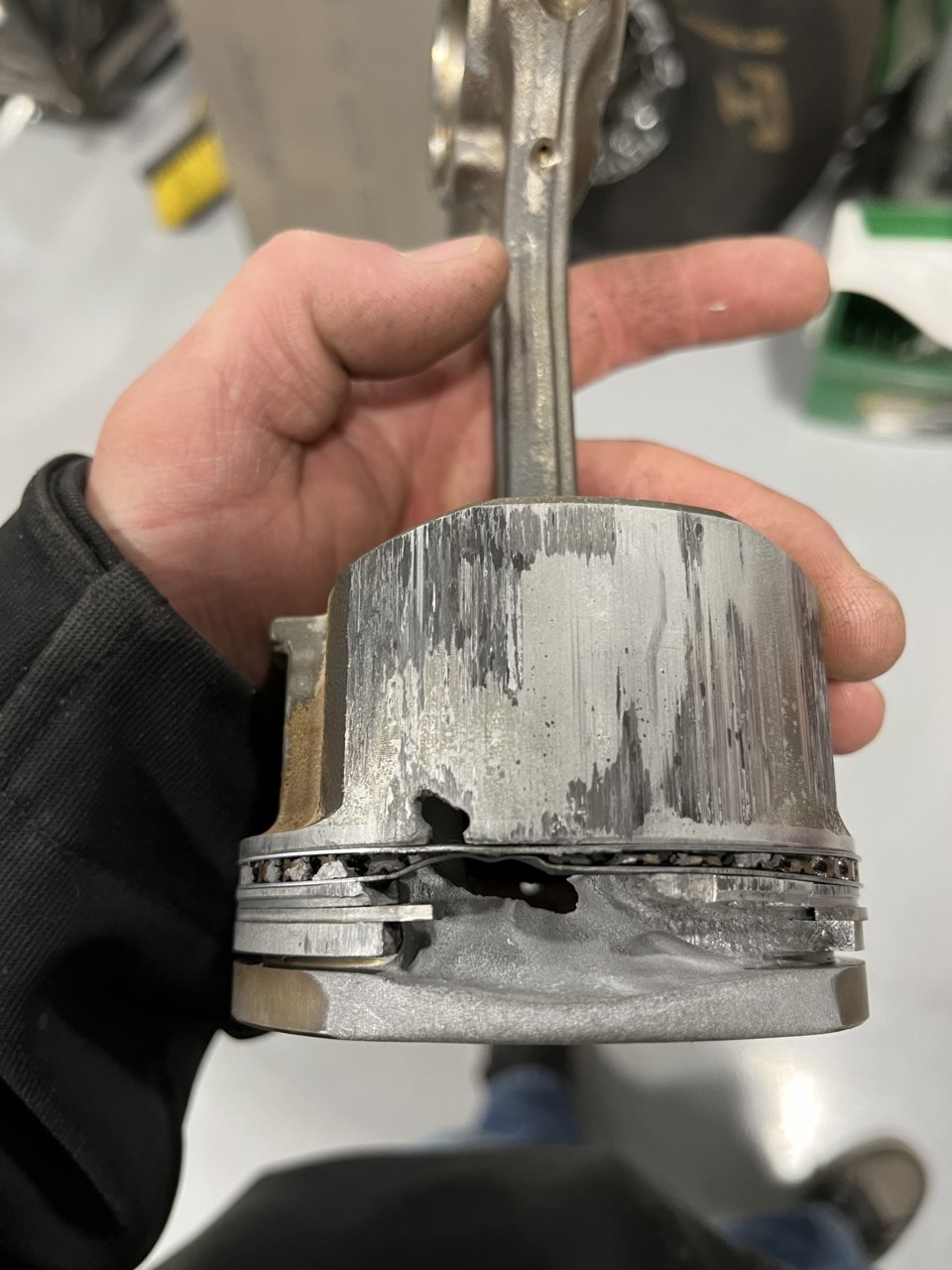

    this is my old piston. She’s effed

    Ooof! Cylinder #6?!

    Broken ringlands, ouchie. Need to gap those rings a bit more on the new build. Is that rod bent?

    Looks bent from the angle. Is it bent?

    No it was cylinder 5.

    Not that I can see with my eyes. It just broke the ring and torch through. That was running 14 psi on stock 250k mile he vvti. It was bound to happen sooner than later.

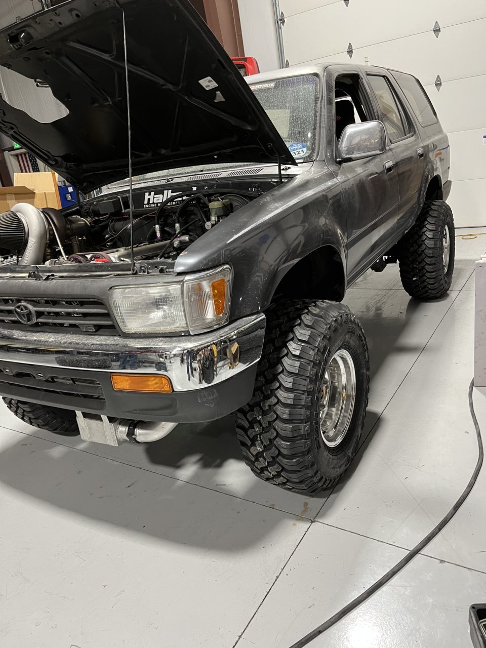

    my buddy’s 1200 hp 4Runner. What a beast
