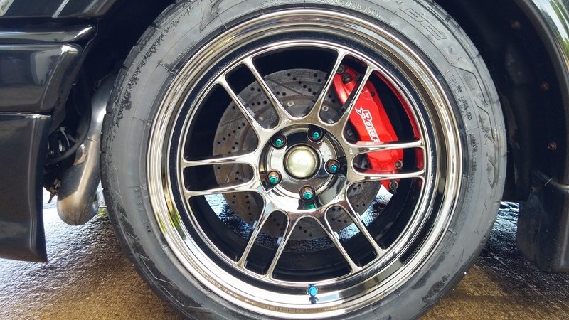

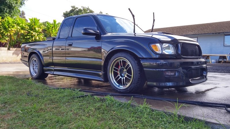

    Returned to Maui last week for the last round of drag racing. Truck was unfortunately in same running condition as 2 years ago. Brother/owner has been working 70+ hrs a week almost non-stop. Waiting on 1320 Performance to install chassis dyno for legit dyno tune session. 1320 performance did help us tune the drivability of the truck so its not a struggle to cruise anymore. Also came to conclusion that one of the two 255 fuel pumps is done. Explains the sudden loss in fueling at high RPM last time around. Past 6000 RPM, a/f ratio rises rapidly from 11.5:1 to 15:1. Pending on available free time and dyno tuning, truck will be seen/raced at earliest Memorial Day races 2017. New fuel pump and possibly roll bar (NHRA legal to 10.99) are also on the to-do list.
    Picture with drag radials out back and new set of black chrome RPF1 fronts.
