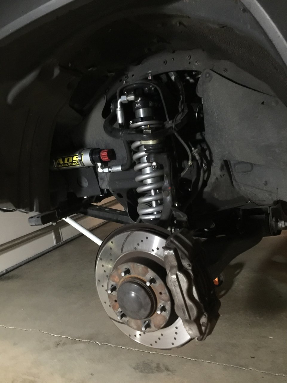

    C4Fab LoPro, BAMF Sliders, Ext ADS 2.5’s, 4.88's, OVTune (OG to KDMax)
    You could buy just the ADS fronts with UCAs for $2K
