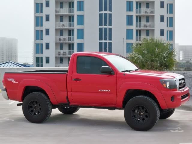

    Yeah what Niknaq said. I did the Bilstein 5100's set at 1.75" on my 07 Regular Cab PreRunner and it leveled it out perfect IMO. And I got 265/75-16's as well. I really liked the look and I'll be doing the same mods on my next one! Here's a pic of mine so you can get an idea of how it looks with that setup. Oh and I didn't have any lift in the rear.

    redrazr....this looks really good! Did you have any rubbing issues? Also, what kind of tires are those?

    Thanks! After I got the new wheels they rubbed a tiny bit up front. Fender wells I'm guessing? A bit of trimming probably would've taken care of that. The tires were Goodyear Wrangler AT/D2's. Sam's Club specials :D lol
    If you want the same height as the 265's, but skinnier, then a 235/85-16 would be a good choice.
