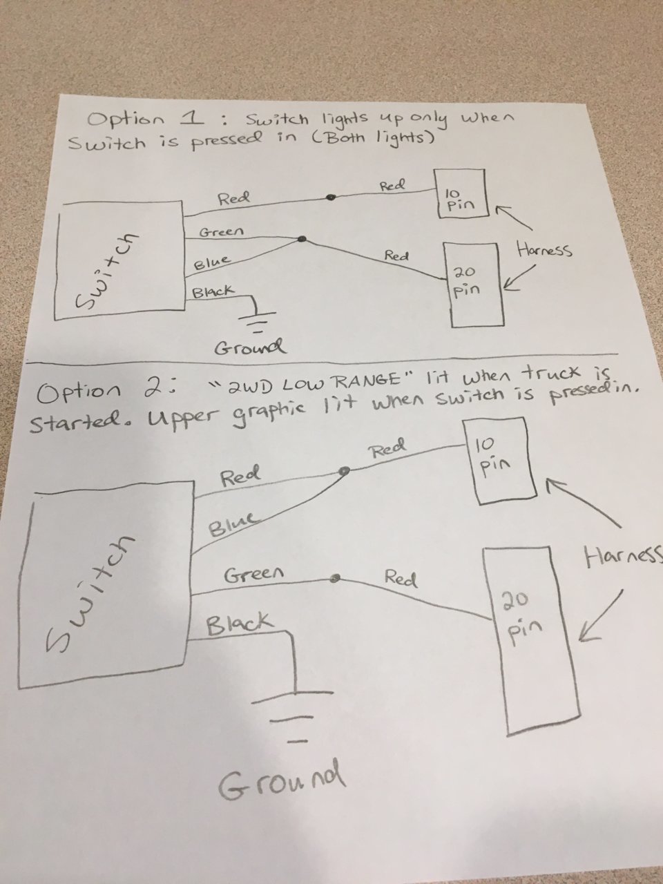

    Installed my module about a month ago. Using an Air On Board switch to activate. Smooth install. Module works like a champion. Always keen on unlocking extra functionality.

    I have the same switch. Just out of curiosity, did you wire it through a relay to activate the 2-lo?

    No relay needed! Followed @Up2NoGood 's instructions below. Used Option 1.
    DISCLAIMER: In Option 1, both image and text on switch will be lightly illuminated when the switch is disengaged. Image and text will increase brightness when the switch is engaged. When I install an auxiliary power distribution module, I will tap into the dimming circuit for a more OEM look and feel i.e. Blue switch wire to ILL + and Black switch wire to ILL GND.

    I didn’t wire mine with a relay either. I was just curious since I think the switch instructions mentioned the use of a relay. I have a habit of breezing through directions lol

    AOB directions do state the need for a relay. Now I don’t know for sure, but based upon the familiar click I hear when engaging the switch, I presume the 2LO module has a relay baked in. Therefore meeting AOBs requirements that switches only engage a relay.
