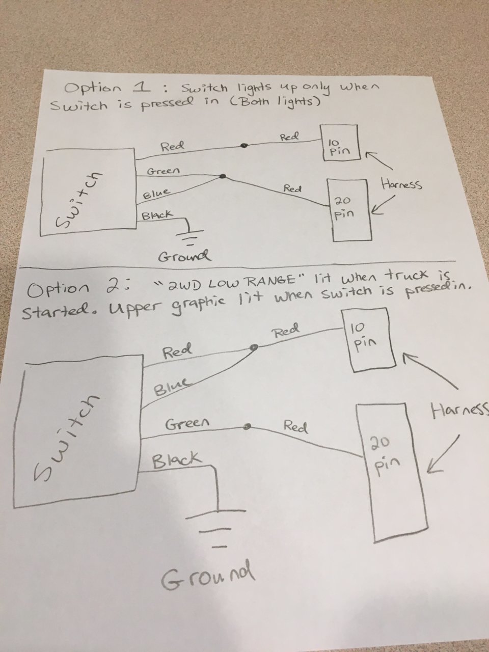

    If any of you are going with the Air on Board switches below are a couple of hookup options I sketched for someone. I've never used the ch4x4 switches so I don't know the wire configuration for those.

    I was just looking to find how to wire a switch for the module. Thank you sir

    Looks pretty similar for CH4X4.
