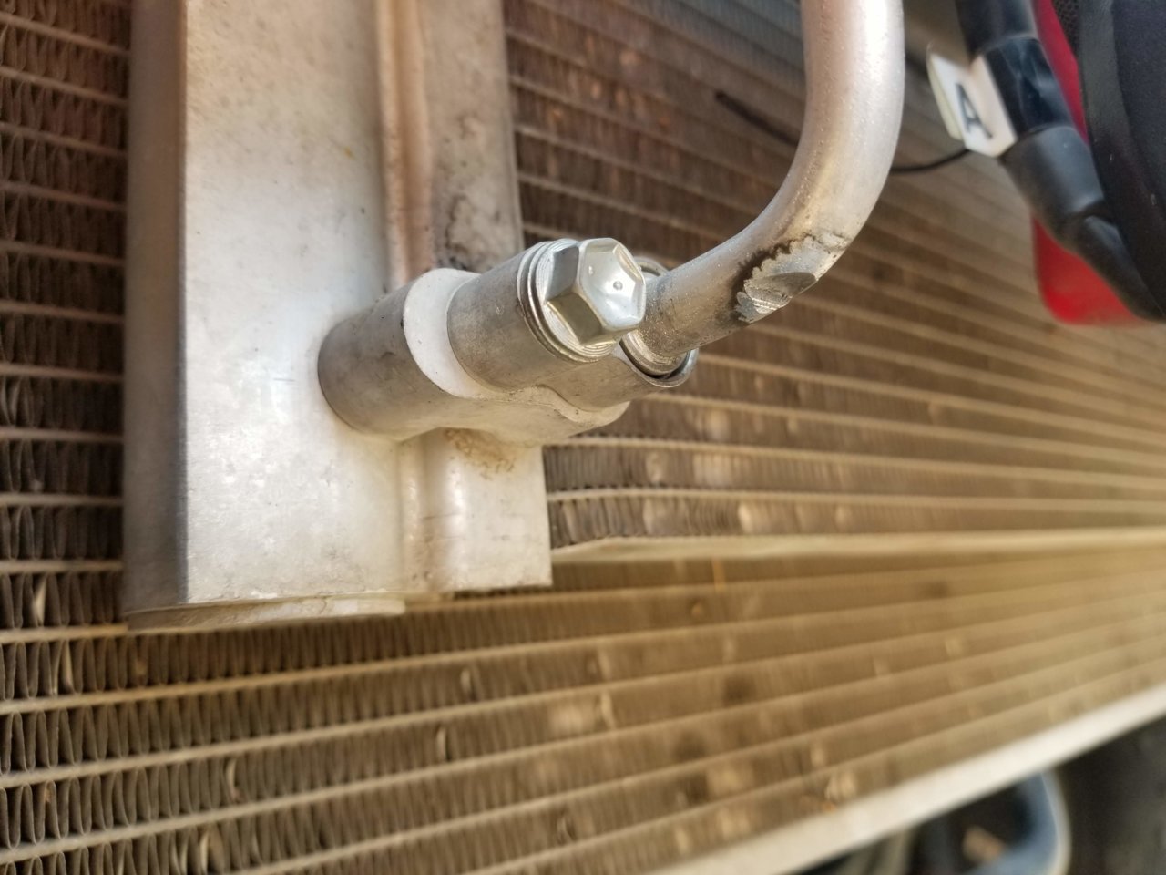

    Off topic, i see you may have an US Offroad bumper too. May check your lower AC line if you do, mine was rubbing through my AC line, took almost two years though. I just took it off and notched it. I gotta post this to their main thread for that, sure it been covered before, but just in case.

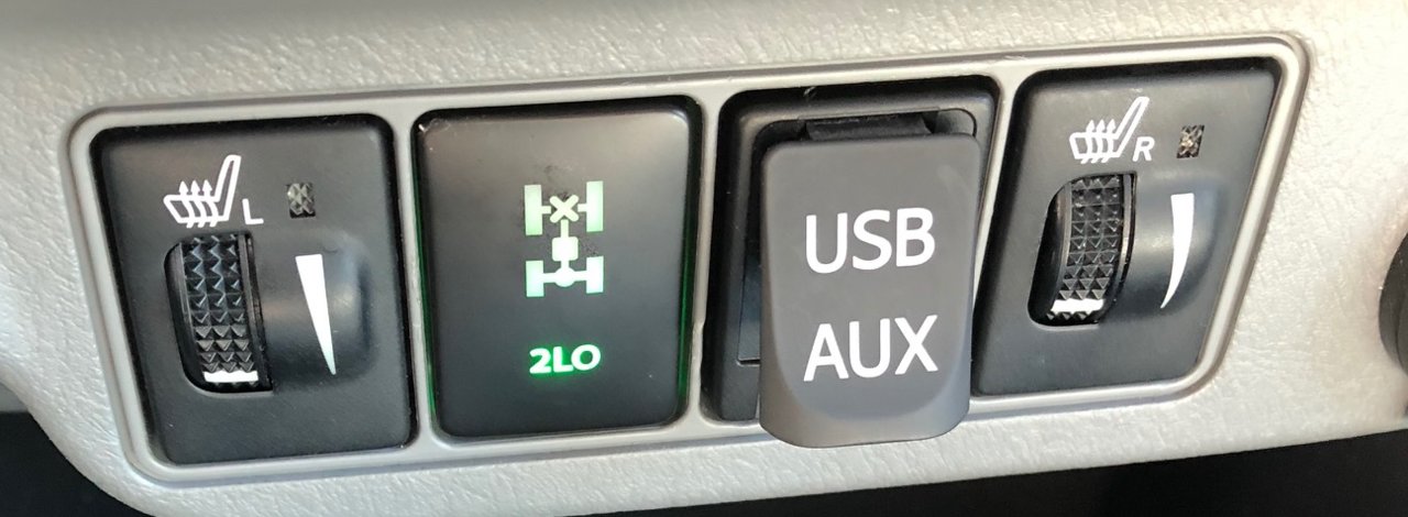

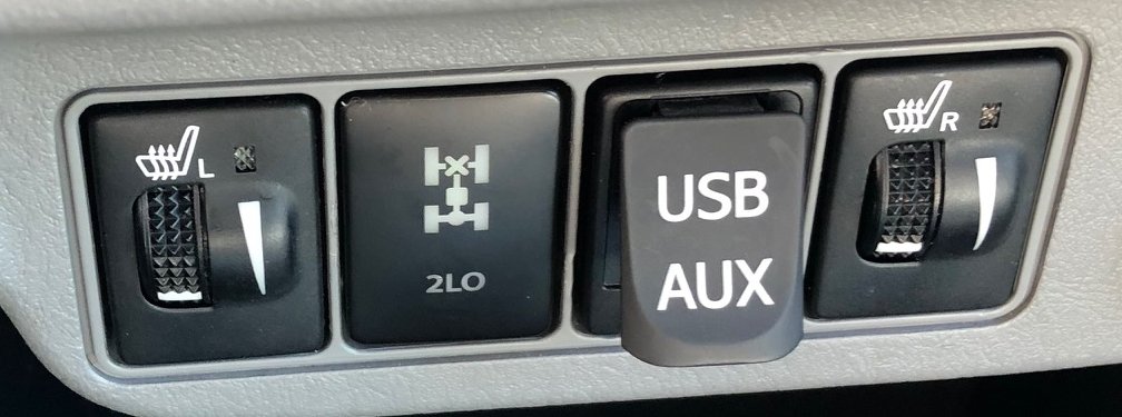

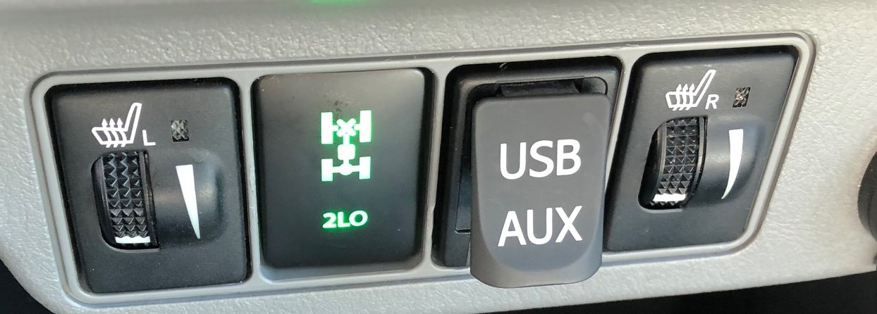

    Received the kit about a month ago - impressed with the build quality as soon as I opened it. I wanted a separate switch so it took a few weeks figuring out what to get and setting aside the time.
    Here is the switch mounted, truck running, headlights off and 2LO not selected (button not pushed)2LO all off.jpg
    Here is the switch with headlights on and 2LO not selected
    And finally with headlights on and the button pushed in
    All work well. I have tested it and like the feature.

    First what I did
    I bought the switch mentioned above
    https://www.ch4x4.com/product/ch4x4-custom-laser-etched-toyota-small-push-switches/
    and an "add a circuit fuse tap" for a mini fuse - not this one but something like it.
    https://www.amazon.com/dp/B01LFXA5U...&pd_rd_r=6cc13fea-b901-11e8-87eb-1be919d0e38f
    I was working above the area where the switch was added so replacing the blanking plate, running the wire and installing the switch was no problem (see recommendation below)
    I ran three wires from the switch to the glove box area where the 2LO module will be located. I thought I was running more than I needed at 4 feet of wire (times three) but it ended up being just right.
    From the switch one of the three wires was lugged and then grounded at a 10mm screw behind the glove box.
    The two wires that are "switched on/off" were connected to the two wires for the optional switch provided with the 2LO harness. Internal jumper removed as outlined in the directions with the kit.
    I then ran six feet of wire to the left to end up near the fuse box.
    I used the add-a-circuit at fuse the fuse for the tail lights as this has power when the headlights are on.
    On the switch there are two lights:
    the text 2LO illuminates if/when the headlights are on - whether or not 2LO is selected.
    the driveline icon is illuminated when the switch is pressed IN (2LO is selected)
    NOTE test the connections to the 2LO wire harness - if connected on way the icon is always illuminated, if so swap the two connections so that it is only illuminated when the switch is IN.

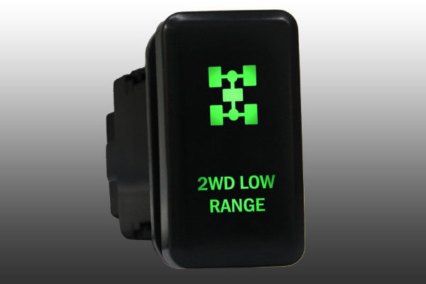

    Air on Board sells 2lo switches and have a number of color options and carry them for both the left of steering area and also the smaller switch for under the AC. This is what the switches look like... I actually like the one you had made better but that is just personal preference really.
