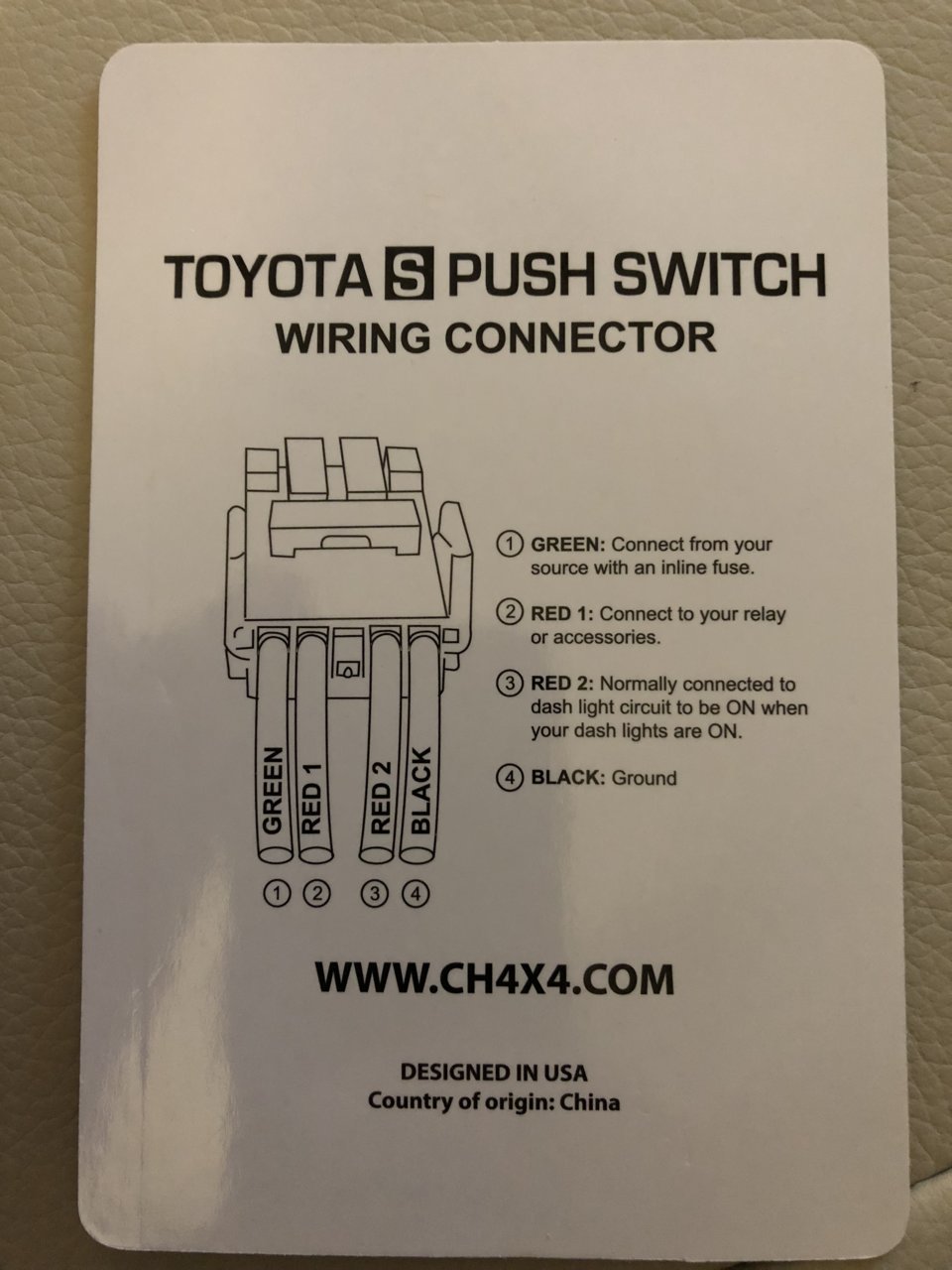

    Went with a push switch...:D
    D2. and Drainbung like this.

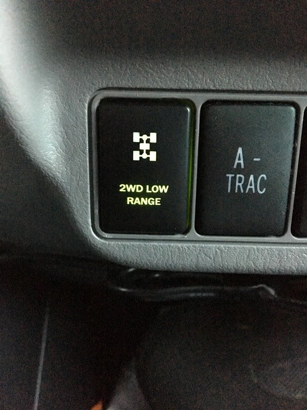

    Finally got around to installing my 2Lo Module w/ switch. Thanks again @Up2NoGood !
    Of course everything tested out fine. Admittedly I forgot to remove the jumper cap and scratched my head for a few minutes on why the switch didn't work. Cool mod for sure.

    looks good :thumbsup:
