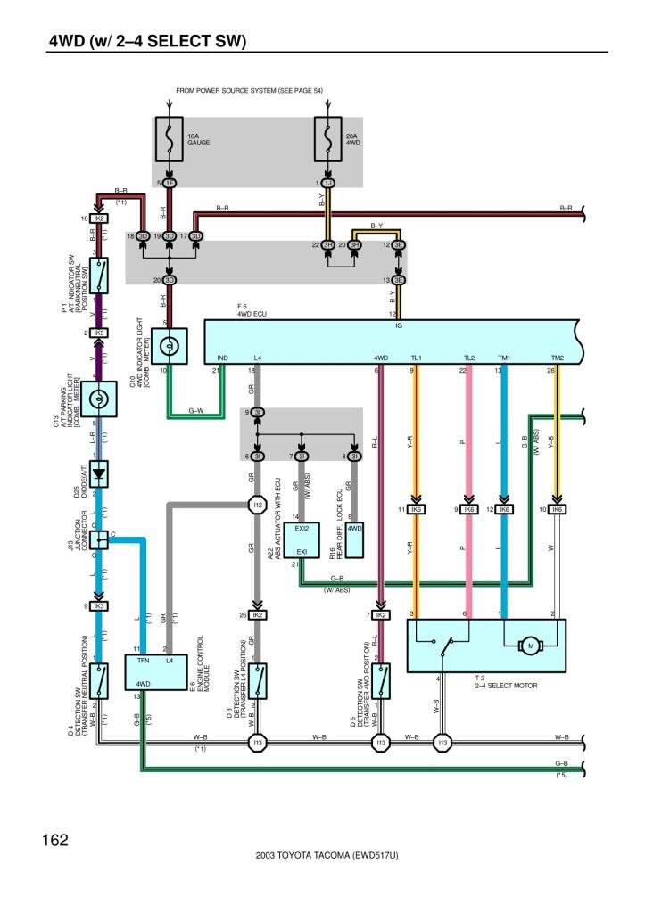

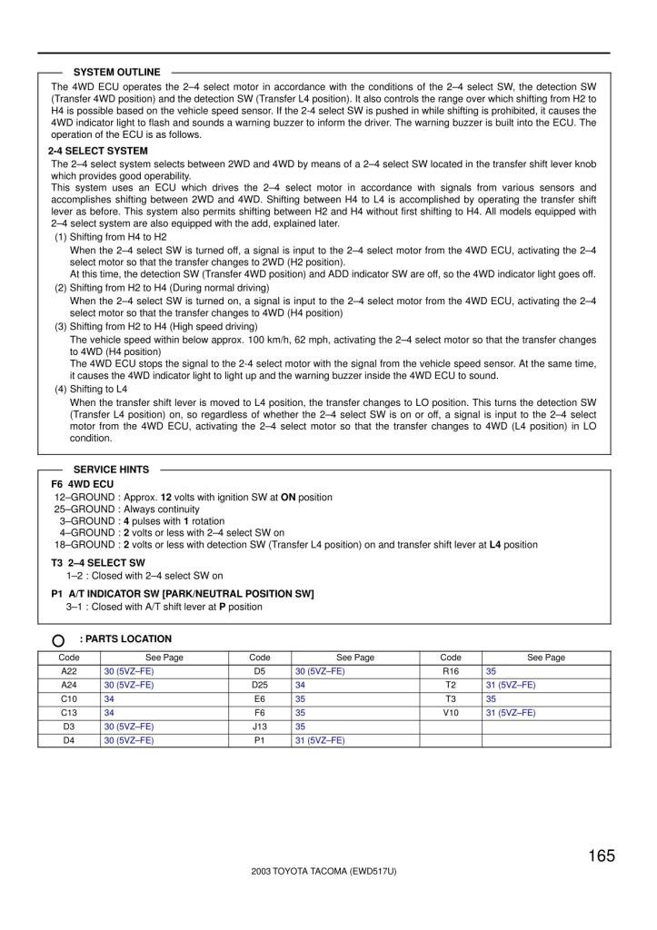

    Does anyone know what wires these are that we are disconnecting on the wiring diagram when disconnecting the blue plug for the 2lo mod? (edit: I verified that those disconnect the l4 detection sw).
    Would like to understand all the possible implications of the mod. It seems to me that it is removing the l4 detection sw thus the 4wd ecu's l4 input 18 will never be signaled (desired), it seems it would then also affect the abs and the engine ecu (shift points for an auto transmission?), and never allow rear diff to be locked(it is confirmed that grey wire mod must be done to use the locker).
    So the question is why not just cut the L4 wire directly at the 4WD ECU (pin 18 Green wire)?
    (on another note. I assume for the grey wire mod that allows for locking the diff in any configuration is cutting out of the circuit, then grounding the box label 4wd: "rear diff, lock ecu"?)

    Ancient thread revival, but need a confirmation. So this mod is basically just disabling the ADD actuator from automatically getting actuated when the shifter is put into 4 low correct? So the front drive shaft will still spin, the main R/P in the front diff will spin, but since it's an open diff the energy is lost on the passenger side (ADD tube side), right?
    I was considering doing this mod to get 2 low for some yard stuff because my spiders are blown in my front diff, but it sounds like if it's spinning the gears inside anyway it won't let me accomplish what I am wanting to.
