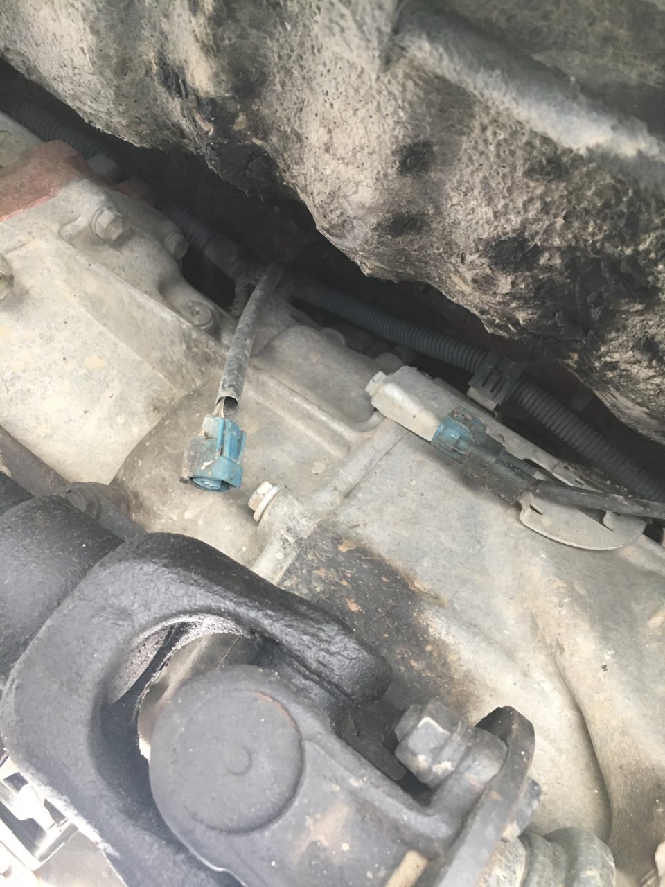

    Now see if the ADD ever engages (actually in 4WD). Not just the front drive shaft spinning.
    The "4wd position" switch on the transfer case confirms to the 4WD controller that the transfer case has and is finished with shifting into 4WD. The 4wd controller (ECU) must see that the transfer has shifted into 4WD before allowing the ADD system to engage.

    Unplugging the blue Jesus plug does not disable 4WD in general.
    I can verify that I have had a working selectable 4WD system since I did the mod in 2010 (see my page 2 response). Not sure if that's what you're getting at here, but there's no question about whether or not 4WD still works when the button is pushed.

    Just did this, it worked great for pulling my travel trailer up a steep driveway.
    Any chance anybody knows the name or part number of that style plug? I want to get blanks to plug into the sockets instead of messing about with tape and silicone.
