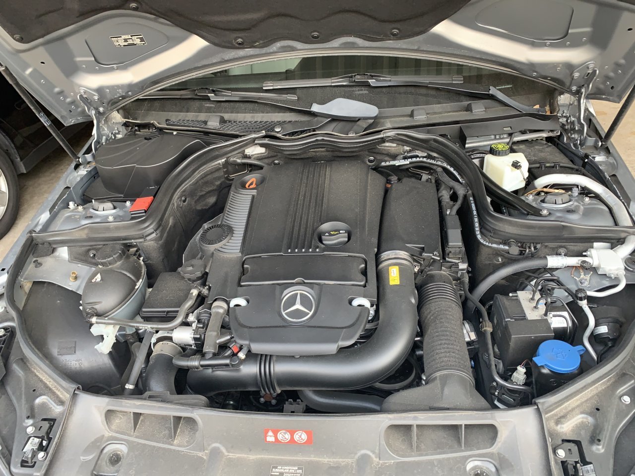

    I get that and that would be my last resort to trade it in with a V6. I know these engine can throw some good power. My merc is a 4+turbo and though its apples to oranges I am not expecting the same here(just an example). Because I know something is wrong with my truck and it can throw some more.
    Anyway thank you for your suggestions
