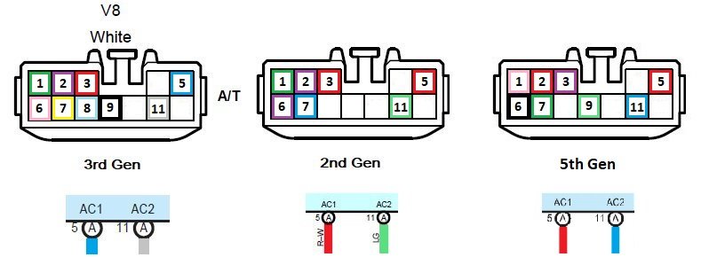

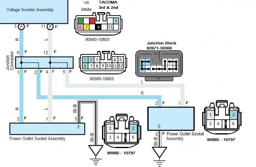

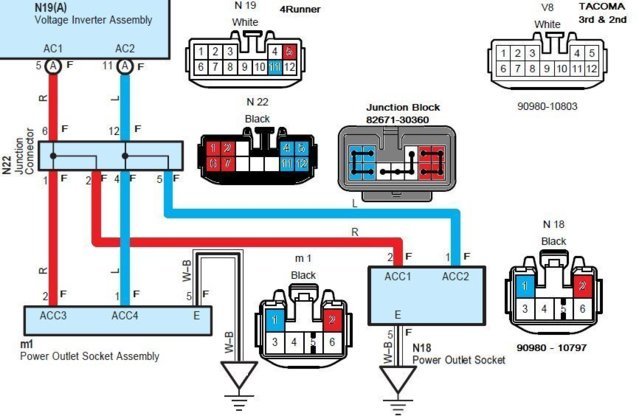

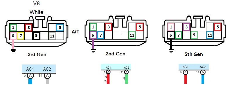

    Well here is another comparison chart for you....adding the 4Runners and I have been informed the Highlanders are right around the corner, but I need to snag their wire diagrams and look into everything as I do not have anything on that vehicle.
    Now after you remove Pin #2 and #8 and your Ground #6.

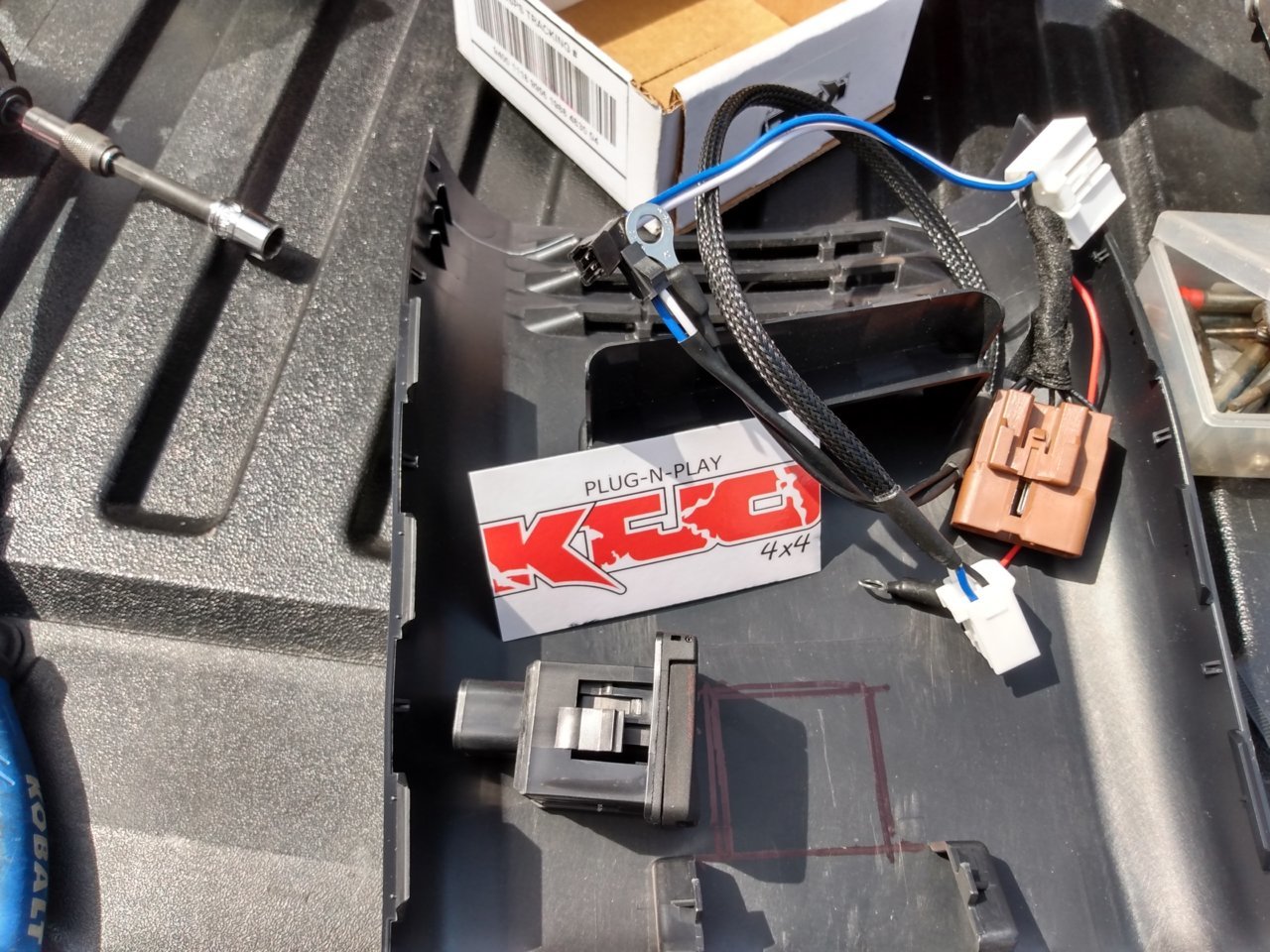

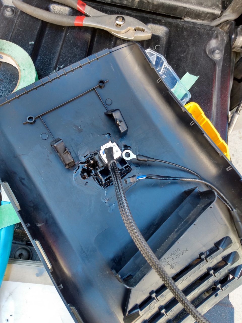

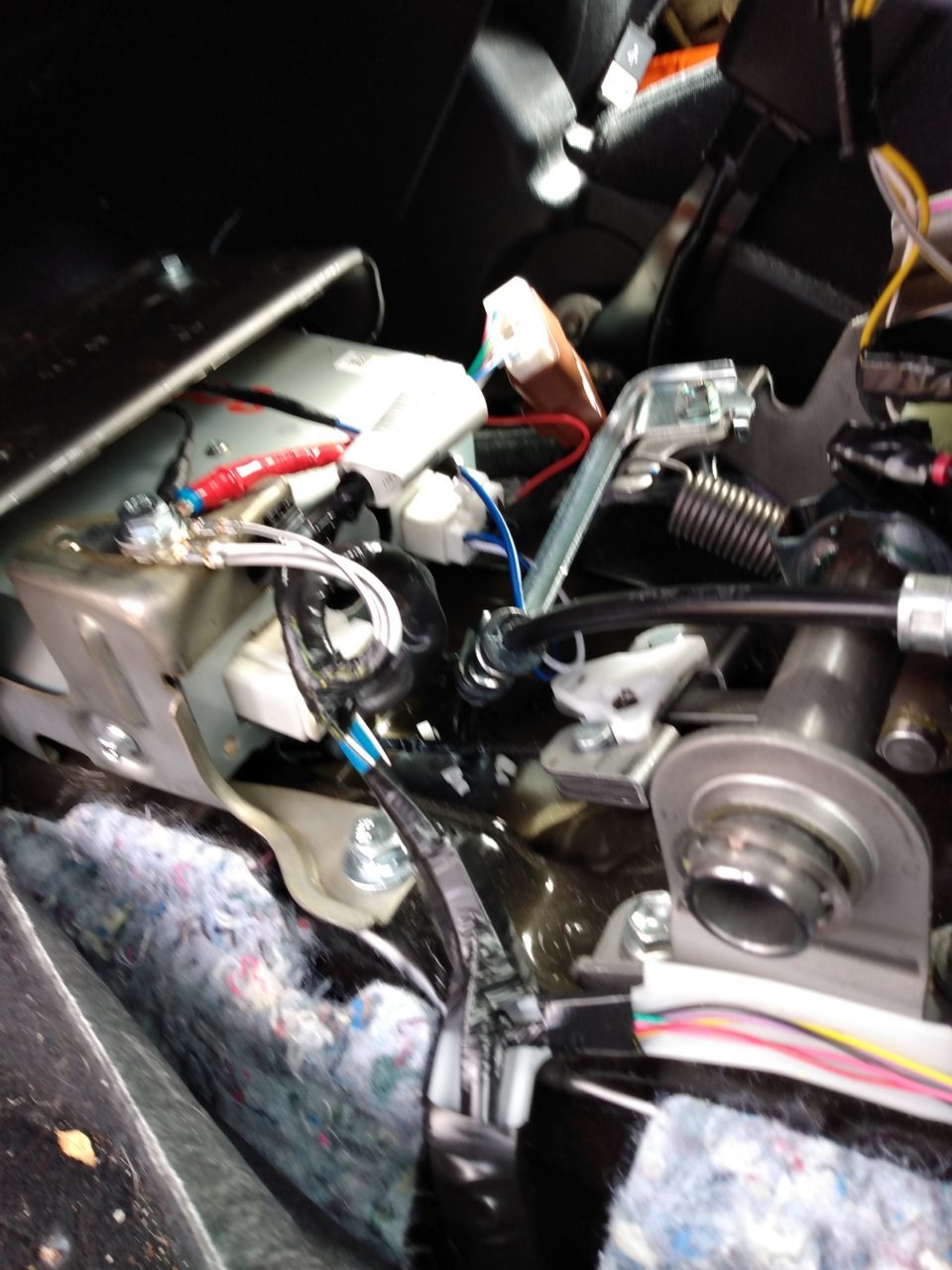

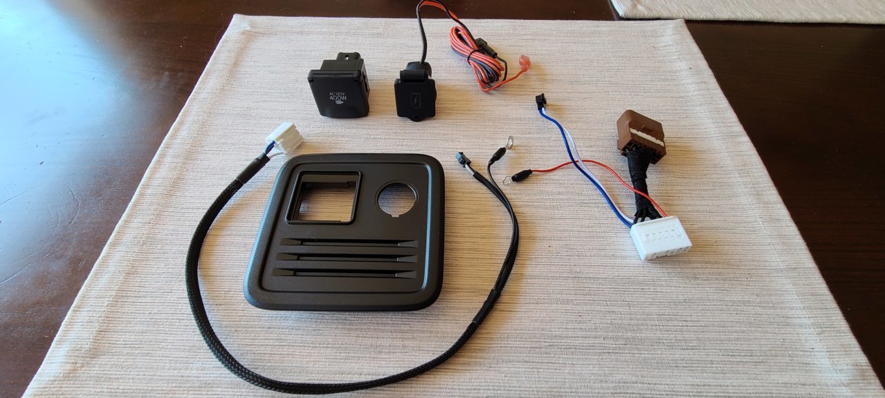

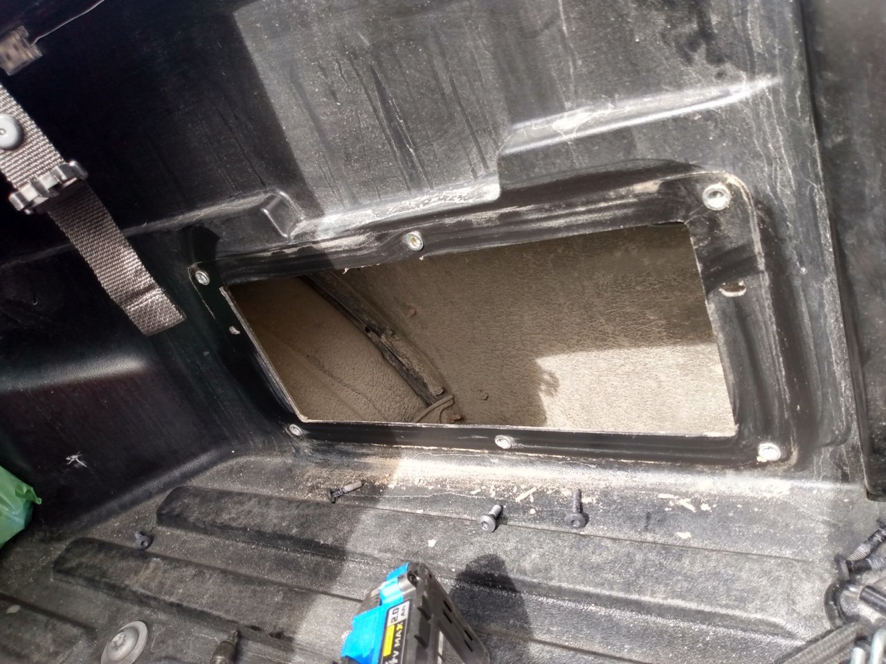

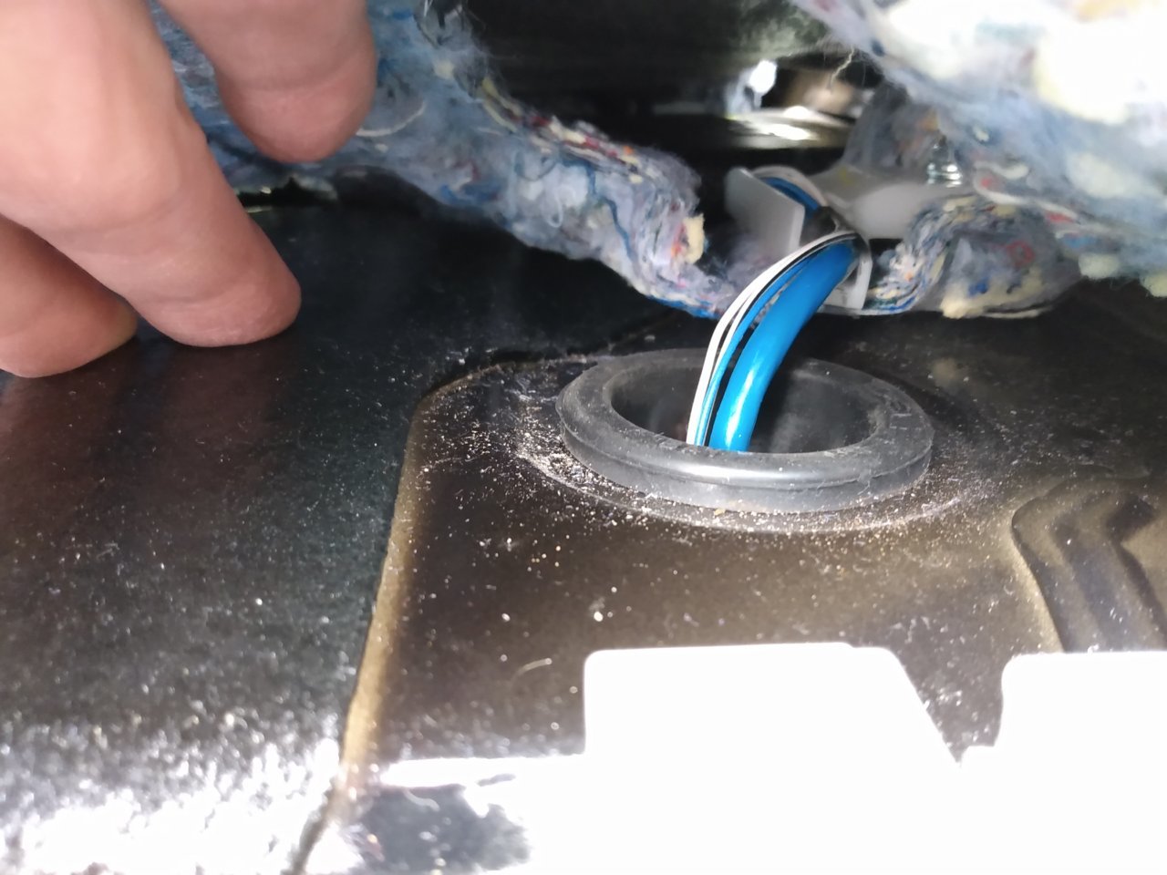

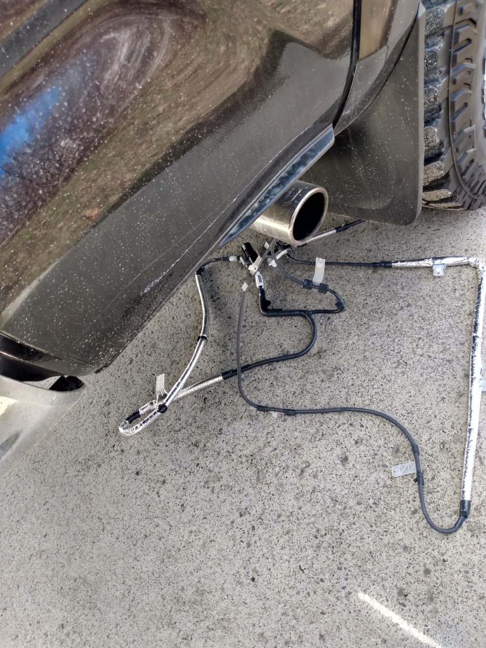

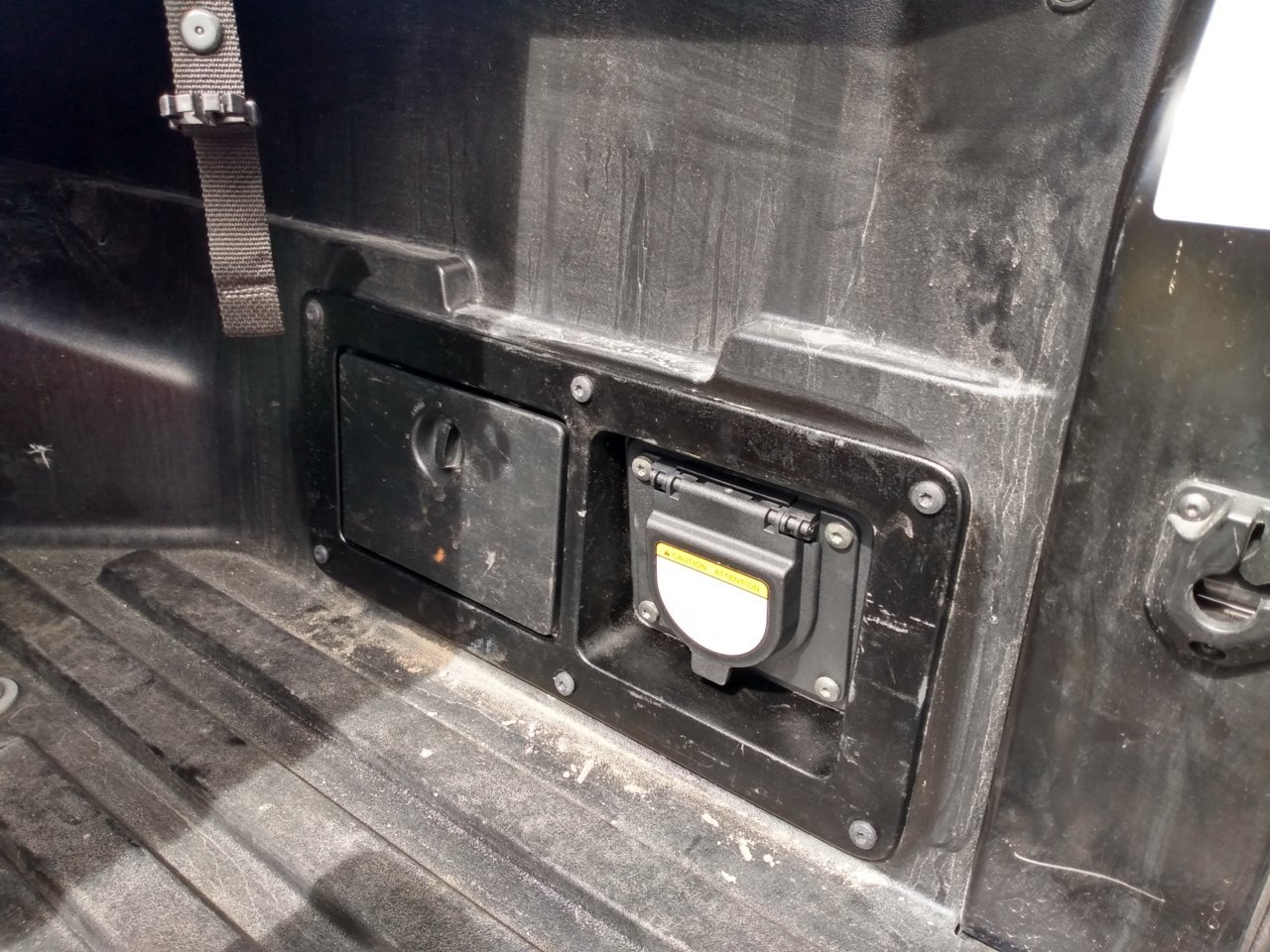

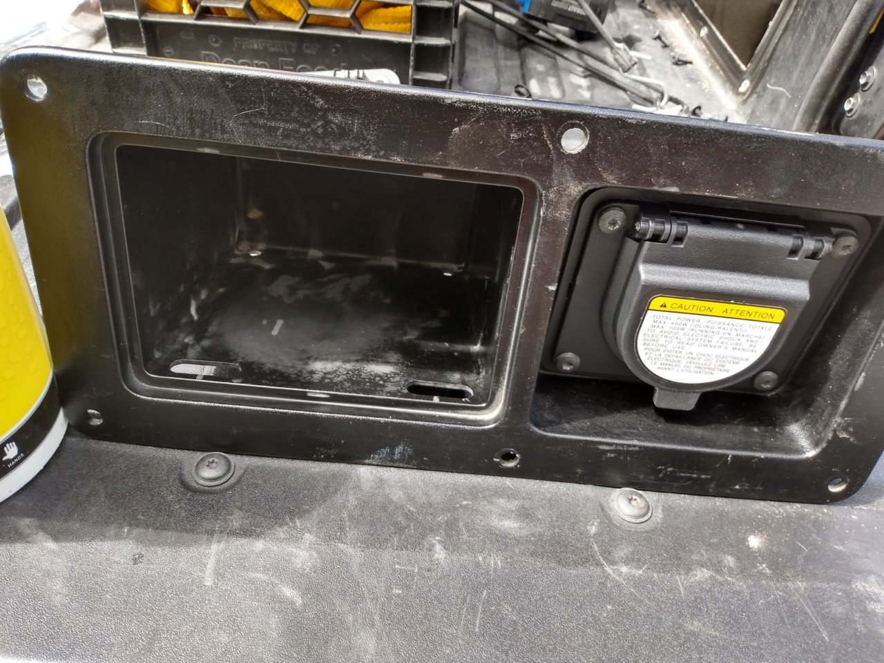

    I install my inverter this week, bout OEM chassis harness that goes from the bed to the front driver side plug on fender , then installed the harness that goes under the passenger front seat that ties the inverter to the chassis harness (OEM) and installed switch (OEM) in dash left side of steering wheel.the plug was be hind the dash tapped up to a nother wire. I also installed the passenger rear cuby box with the built in plug (OEM). Got it all together and it didn't work. Brain fart ,for got to get the relay that goes in the small relay box behind the main fuse box.IMG_20200408_142039997.jpg IMG_20200408_142059349.jpg IMG_20200406_133632584_HDR.jpg IMG_20200406_160115442_HDR.jpg IMG_20200404_132050371_HDR.jpg IMG_20200404_131109979_HDR.jpg IMG_20200404_131115958_HDR.jpg IMG_20200404_131722099_HDR.jpg

    What did you use to epoxy your outlet into the center console? Mine's pretty snug, but not super tight.
