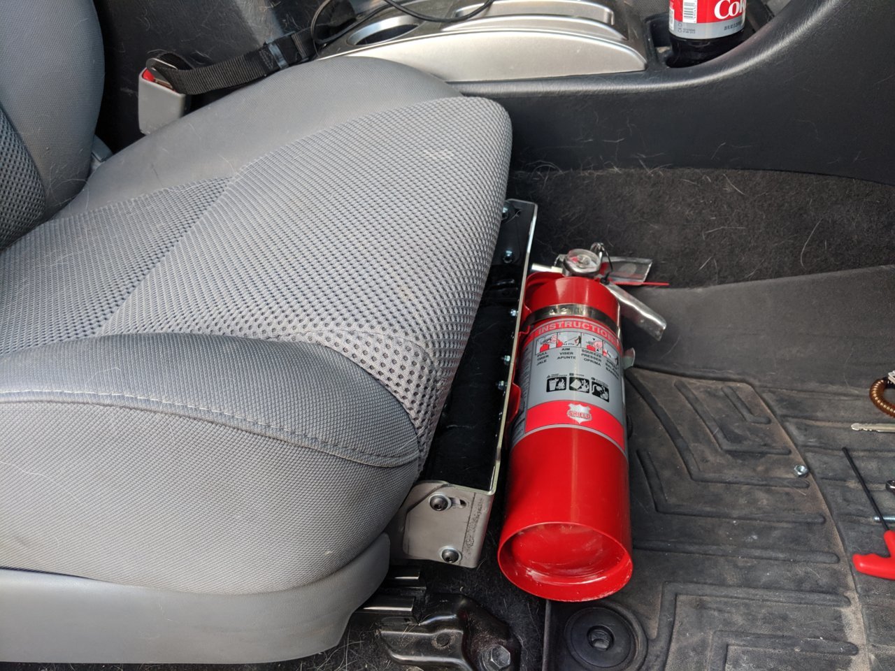

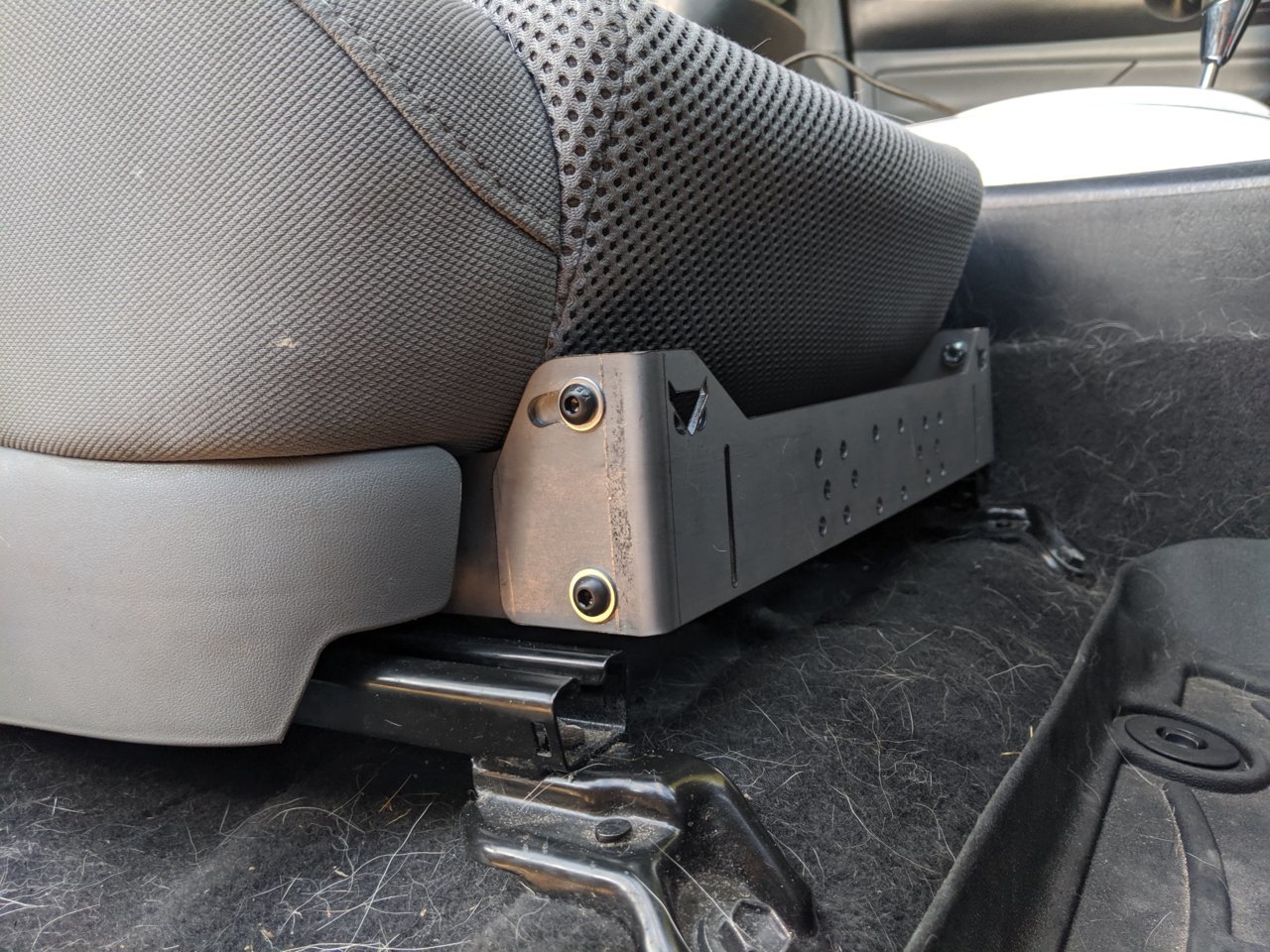

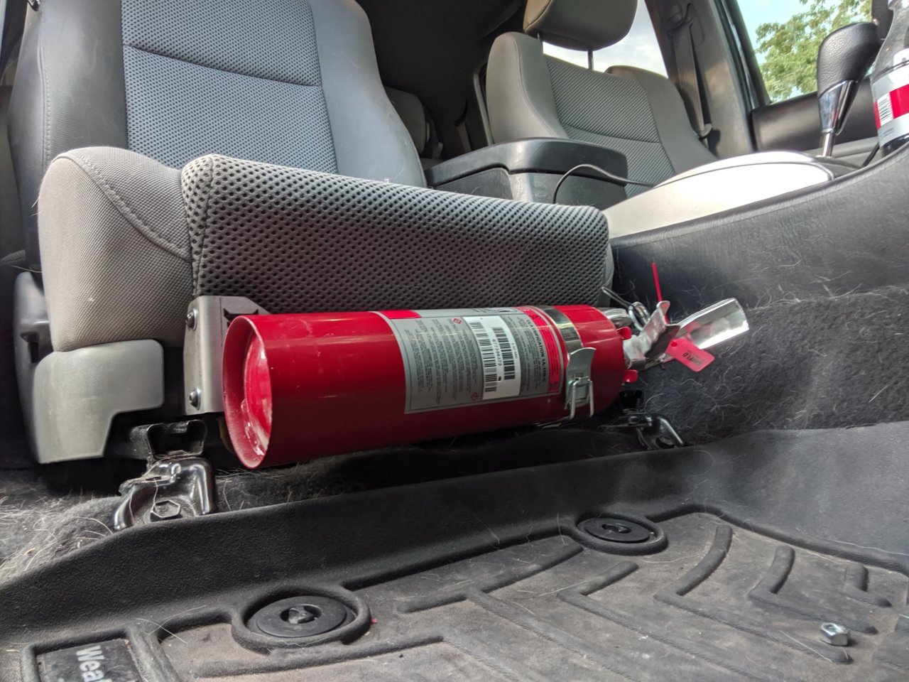

    Hey everyone!
    Here is what I came up with for my GFs 2nd gen Tacoma. It would fit the 3rd gen too.
    The bracket bolts to the seat frame itself and is 12 gauge steel. The final product would be powder coated black. Unfortunately because the seat adjustment bar is so low, I had to design the bracket with enough room to reach the bar. I also added in two different locations where adjustments can be made to provide more space to grab the bar. The bracket can slide outward about an inch from where it is in these photos and it can also tilt forward to make more space. I have no problems getting my hands in there even at the tightest adjustment.
    It works for both sides as well. I also have a strap mechanism that allows you to strap MOLLE pouches or anything with a belt clip to the bracket as well. In my land cruiser, I have the fire extinguisher on the passenger side and a couple MOLLE pouches on the driver with my stuans, tire gauge, gloves, etc.
    Let me know what you guys think.
    Thanks!
    Rami
    P.S. Mods, if I need to be a vendor for this, please PM the info so I can sign up.

    Cool idea. Would buy it if my leg space wasn't already cramped. 6'8" and I need all I can.

    I know the front is more accessible but what about a bracket for behind the drivers seat?
    Have you considered the forces that would occur on the bolts/bracket during a car accident?

    I could go for one of these for about $80.
    How large of fire extinguishers does this fit in that placement if you would know.
    Could you post a picture of it slid all the way forward or is that one of the pictures you already posted?
    Would there be a lower cost for unpainted version?

    Beyond accessibility, you'd lose all the limited legroom for the rear passengers.
    As for accidents, the hardware and gauge of material is way overkill for that reason. The extinguisher hitting your feet would the least of your worries in an accident with enough of an impact to tear 12 gauge steel.

    The typical 2.5 is what's recommended. I know someone got a 5 on the 100 series mount and said it was very secure.
    The pictures show it pretty much all the way in, besides the tilt forward you can see in one of the photos.
    I can take some with it slid all the way out, but it will have to wait till tomorrow.
    I could possibly do unfinished. They would be about $10-15 cheaper.
