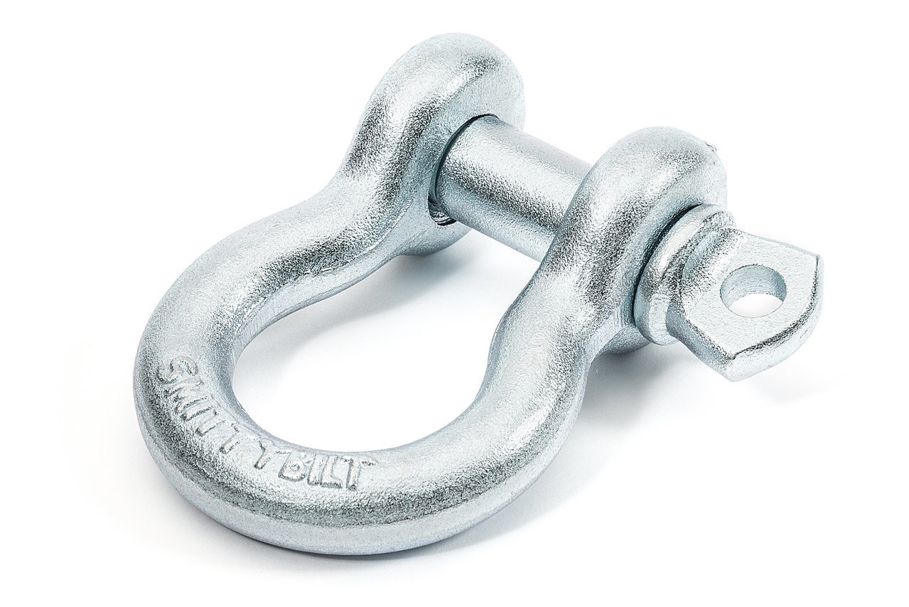

    Just got a couple of these, now to find a pc close to SWB. Maybe I'll just spray them too but I doubt spray paint will hold up at all. 147700.jpg

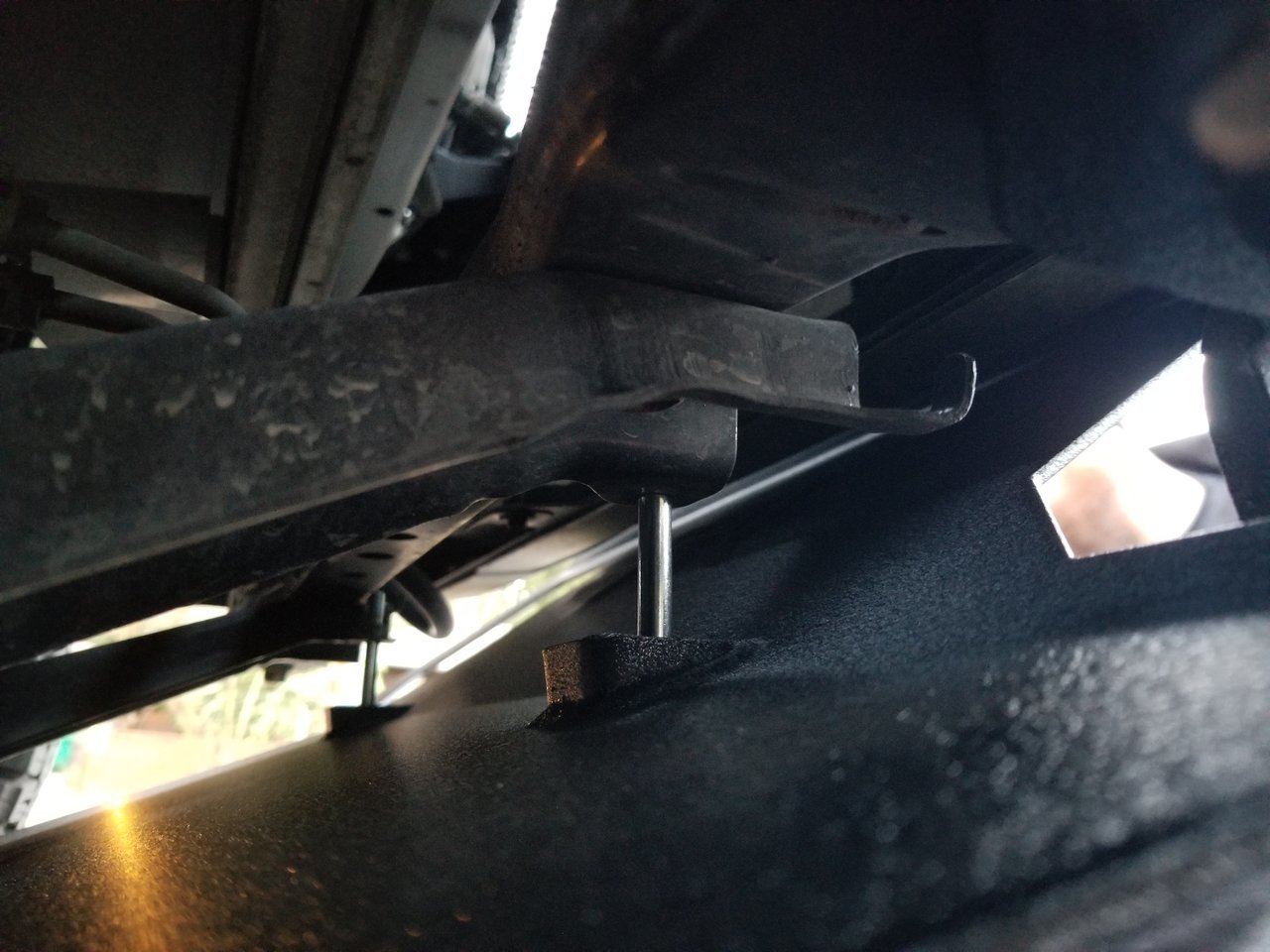

    Went to install my skid and the front bolts are like 2" short. Anybody else run into this? I grabbed some 70 and 80mm bolts from Home Depot and some steel tubing to use as a spacer, but I'm not real thrilled with the huge gap

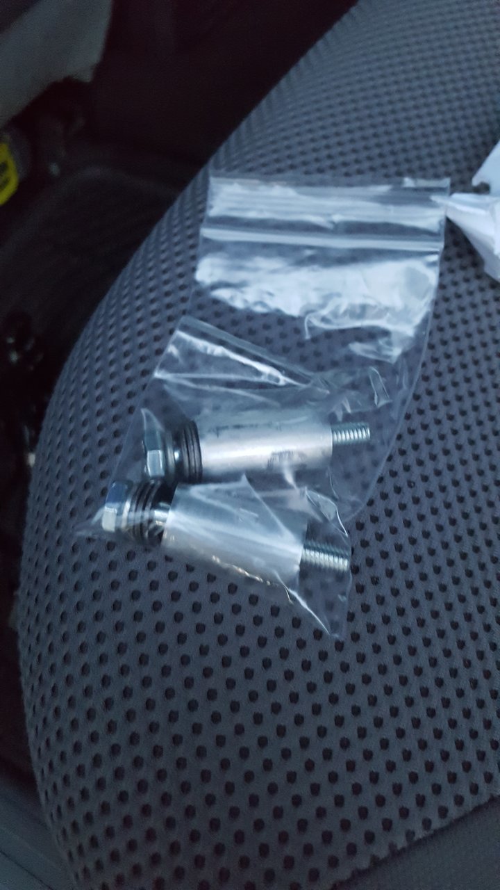

    I'm currently painting my skid so I haven't installed it yet. But do these things go on the front? I recieved these in an envelope. Not sure if maybe yours didn't come with it or if they go somewhere else?

    Holy shit. Those do go on the front. I didn't get them with mine

    Yea, I almost didn't notice mine since they were wrapped in saran wrap pretty good lol hopefully you get some replacements sent your way.

    That's pretty much exaclty what I'm trying to make. The bolts I got are too long, but holding it secure till I can get to my shop to make something proper

    Anyone know if I can find a clear coat strong enough to hold up on shackles or should I just try to find a close powdwecoat

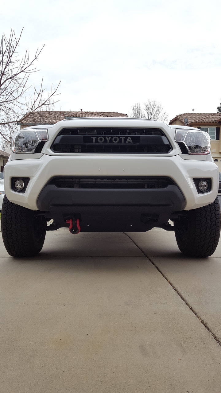

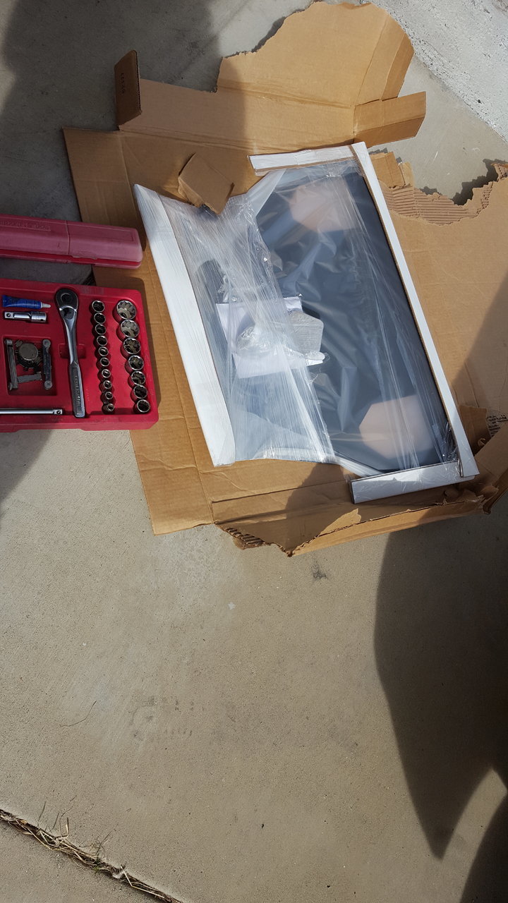

    The better half went to brunch with the girls so I had time to bolt it up.
    Torqued the skid bolts to 32ft lbs with blue locktite and the tow hook bolts to 80ft lbs with red locktite.
    If you don't have a second set of hands a jackstand comes in handy.
