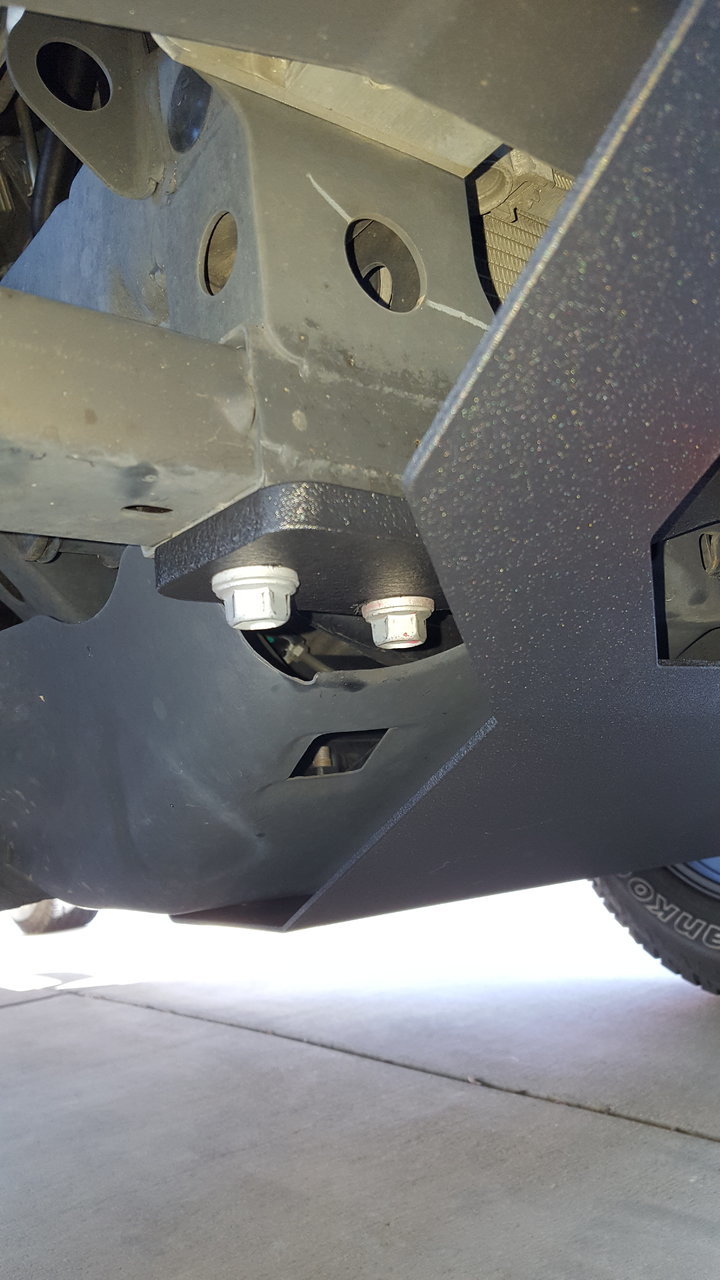

    Looks great stizo. Thanks for sending along the pictures for those of us patiently awaiting notice of delivery. Clearly worth the wait.

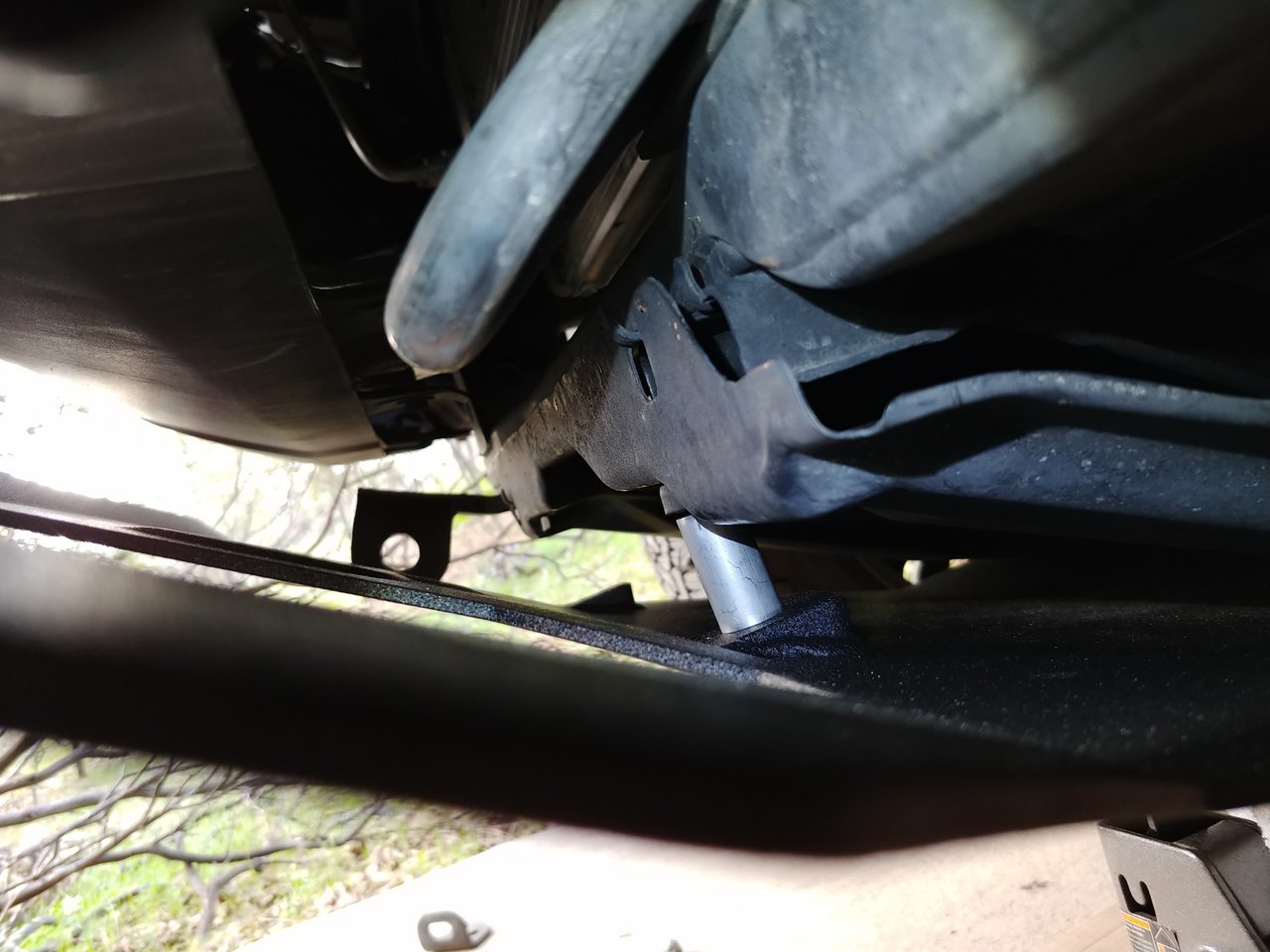

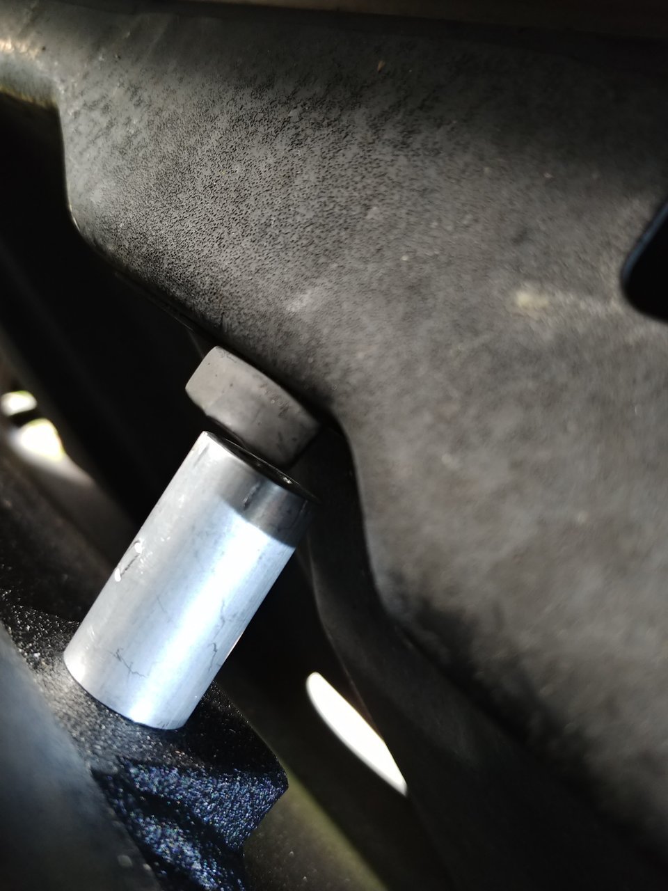

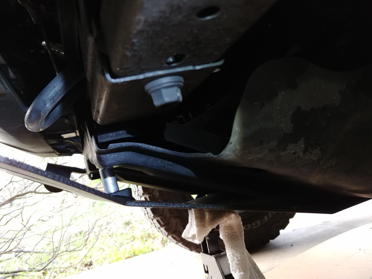

    Am I the only one not able to get the front bolts threaded?
    Here's my order:
    Bolt, lock washer, washer, skid, washer, spacer, washer, stock engine bay cover, stock spacer, and finally the threads I cannot seem to thread into.
    It really does seem like the factory "cover" and spacer needs to come off...
    Any insight?

    Some pics of what I'm looking at:

    I didn't have the stock black spacer in your pic. Try removing it.

    The "stock black spacer" is the bars that run front to back. If you remove them there's nowhere for the bolts to go into
