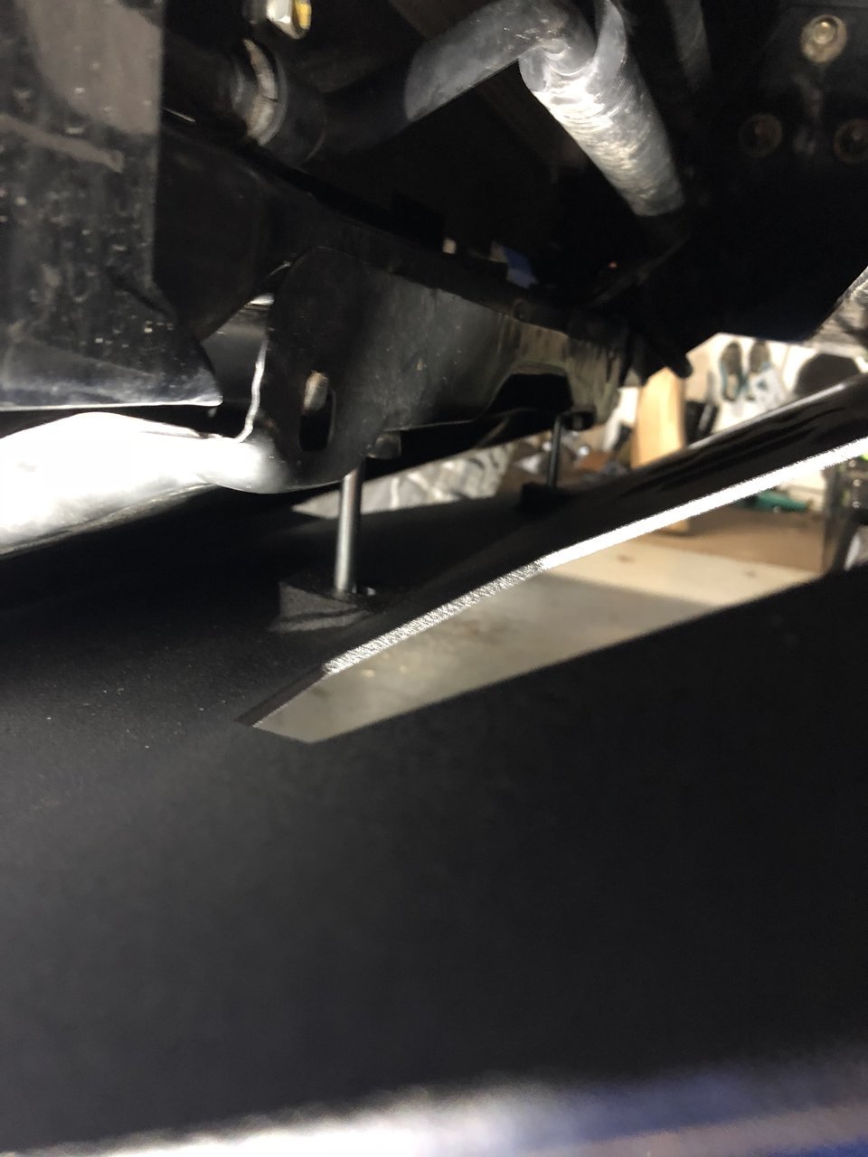

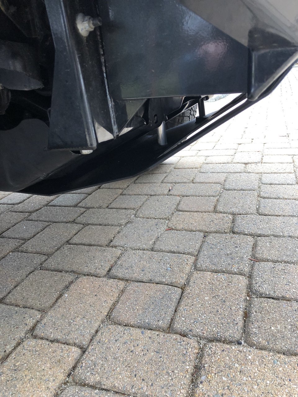

    I did the drivers side without spacer just to hold in place. The passenger side went in very easy since the plate was aligned. Once I had pass side in removed driver side and re installed with spacer.

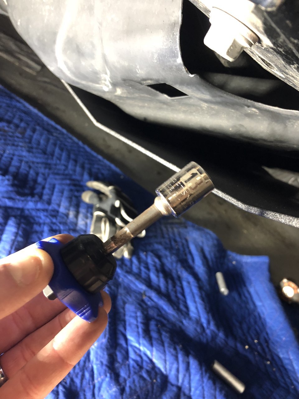

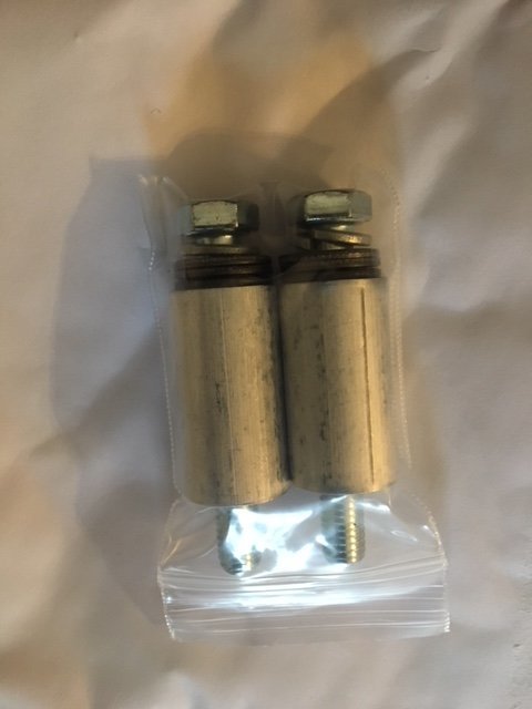

    Just installed. Took 2 hours. Lessons learned.
    1. A shallow socket and nut driver is highly recommended. It allows you to apply pressure to start the threads.
    2. Dry fit without the spacers. This allows you to double check clearances to make sure the spacers are correctly sized for your application. For me they were not. I had to cut a 1/4” off each one to accommodate for my Dobinsons bumper @Dobinsons Mike. I simply used a paint marker to mark the bolts and then cut the spacers to fit.
    3. During your dry fit - once you have the bolts threaded - tighten the rear bolts. This will make it easier to start the front bolts again when installing the spacers.
    4. Only do one front bolt at a time. Leave the other one in without the spacers to hold the plate in place.
    It looks great!

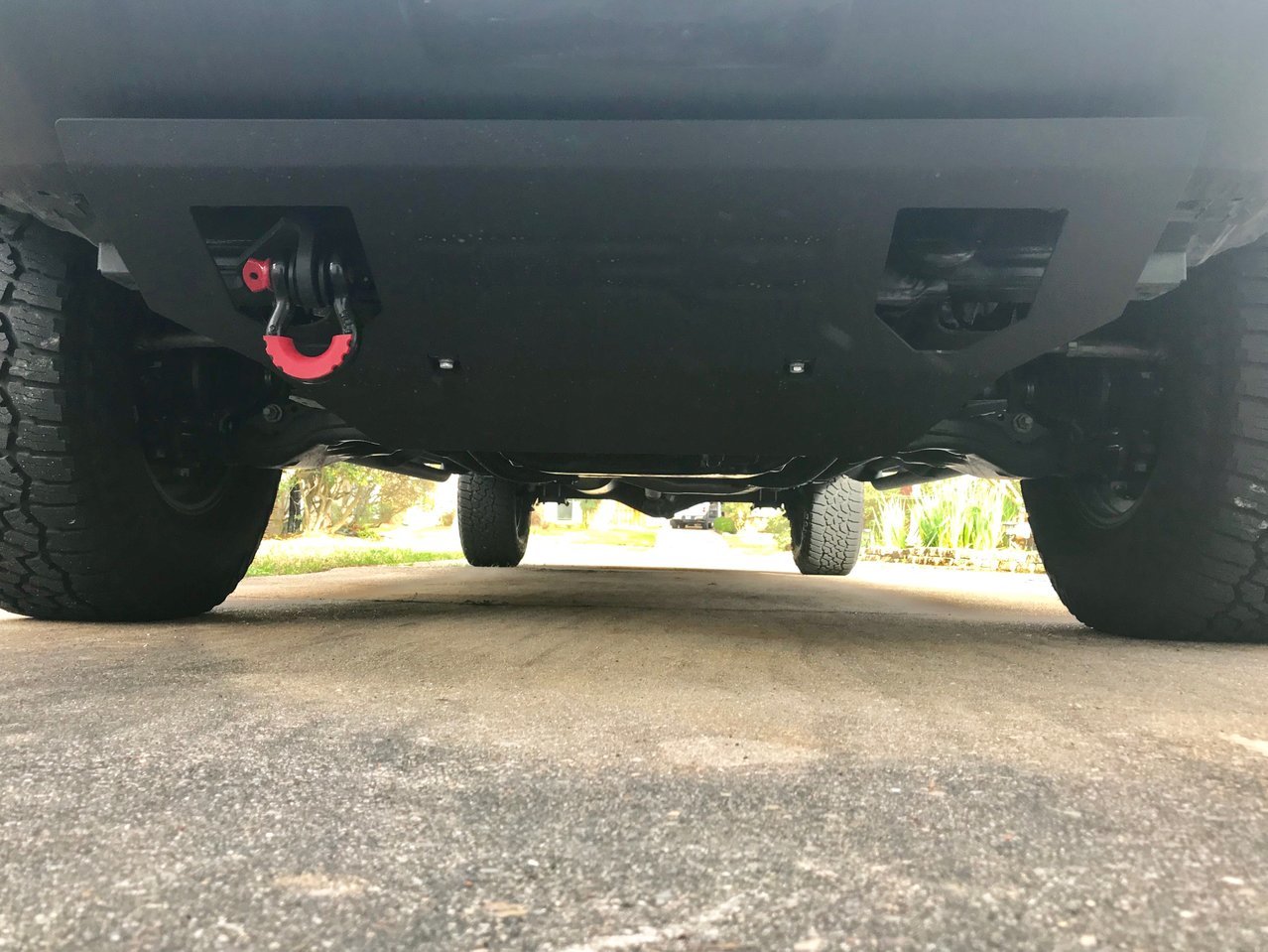

    Those 2 front bolts took forever to get started, love it now!
    If you are looking for isolators for your D-Ring Shackle, I picked up 2 of these from Home Depot for $1.29 each. They fit the gap really good and are cheap.
    zlajoie, TrackAttack, stizo and 3 others like this.

    How are y’all securing your shackles? Loctite?
  12. Feb 23, 2018 at 9:03 PM
    #872
    HFDane
    HFDane Well-Known Member
    Aug 4, 2014
    #135411
    1,157
    Dane
    Griffin, GA
    Hand tight, then stuck a screwdriver in the pin hole and did 1/4 turn more. You’re not getting it off without tools...secure enough for me

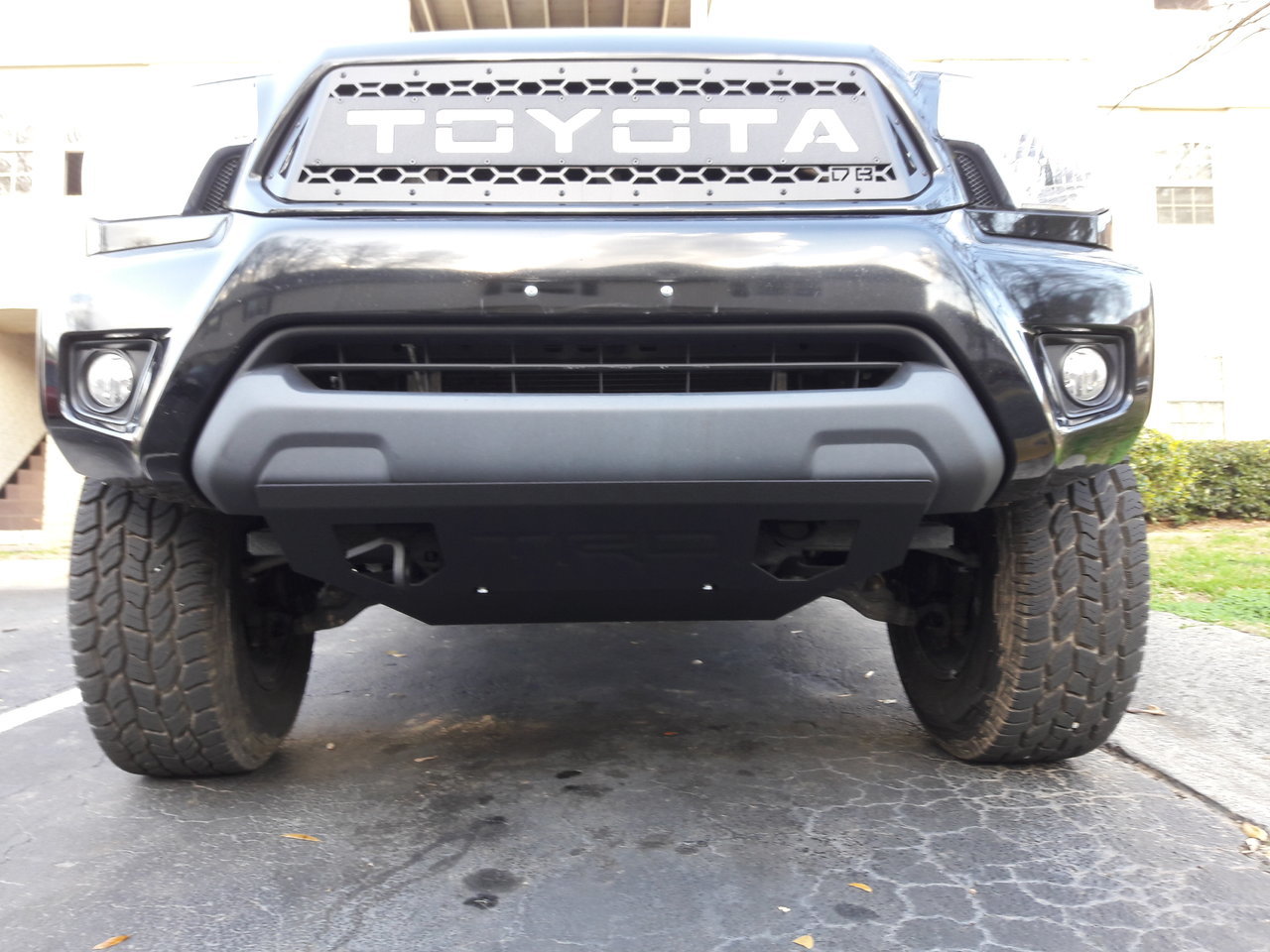

    Installed to see if I like the black on black without painting the lettering. Thinking about painting the TRD white to match the letters in my grille. What do you think guys? Leave it or paint it?

  16. Feb 24, 2018 at 9:58 AM
    #876
    jwctaco
    jwctaco Retired, going slow in the fast lane
    Sep 5, 2015
    #163478
    10,191
    Jim
    SW Michigan
    23’ T4R
    I like it black, all stealthy. I have yet to install mine yet, struggling with the same question. I have a black truck with gun metal accents, thinking of doing an accent in gun metal. That area of the skid would catch a lot of bugs, road dirt.

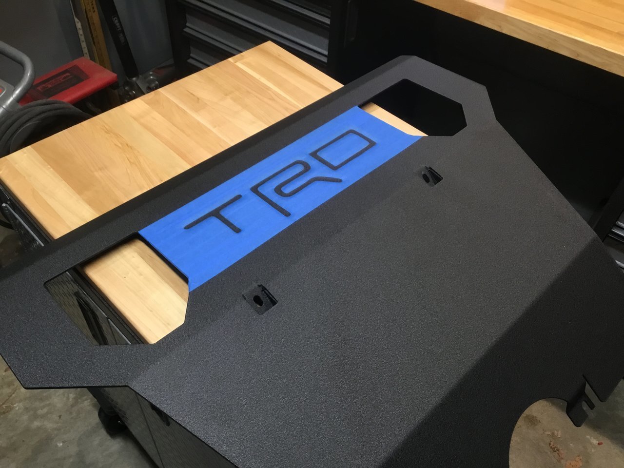

    I received my skid plate earlier this week, and contemplated painting the letters after seeing all the posts with what others were doing.
    I decided to go for it.
    I masked off the letters and cut them out with an Exacto knife. Use a new blade, and only go as deep as the tape.. Cutting out the letters was free form, so not perfect, but unless you are going to crawl up under the truck, you won’t see the minor imperfections.
    With the skid plate powder coated with a textured finish, make sure to push the tape down well. I used a primer and sprayed real light coats to seal up the edges.
    I did start to spray it with bright read, and changed my mind after seeing it sprayed on.. Time to rethink and decide on something a little bit different.. Looking at the truck, I decided to match the Toyota logo in the grille. I picked up a rattle can of Testors Extreme lacquer in Graphite Dust. This was about as close as I could get on short notice. It also has a gloss finish to it, so no clear coat needed.
    End result, tomorrow hopefully, I get it installed.
