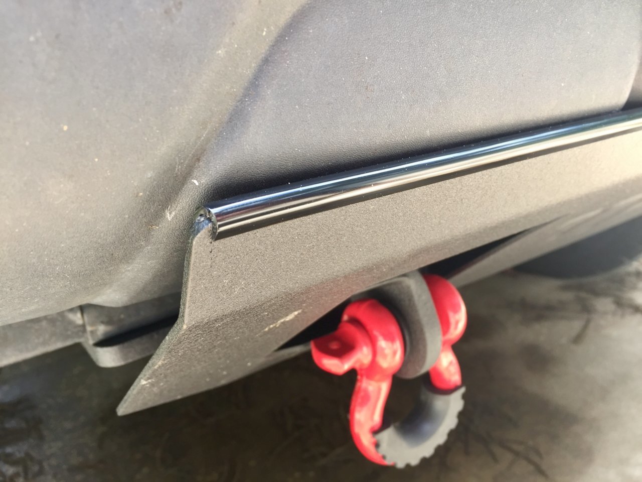

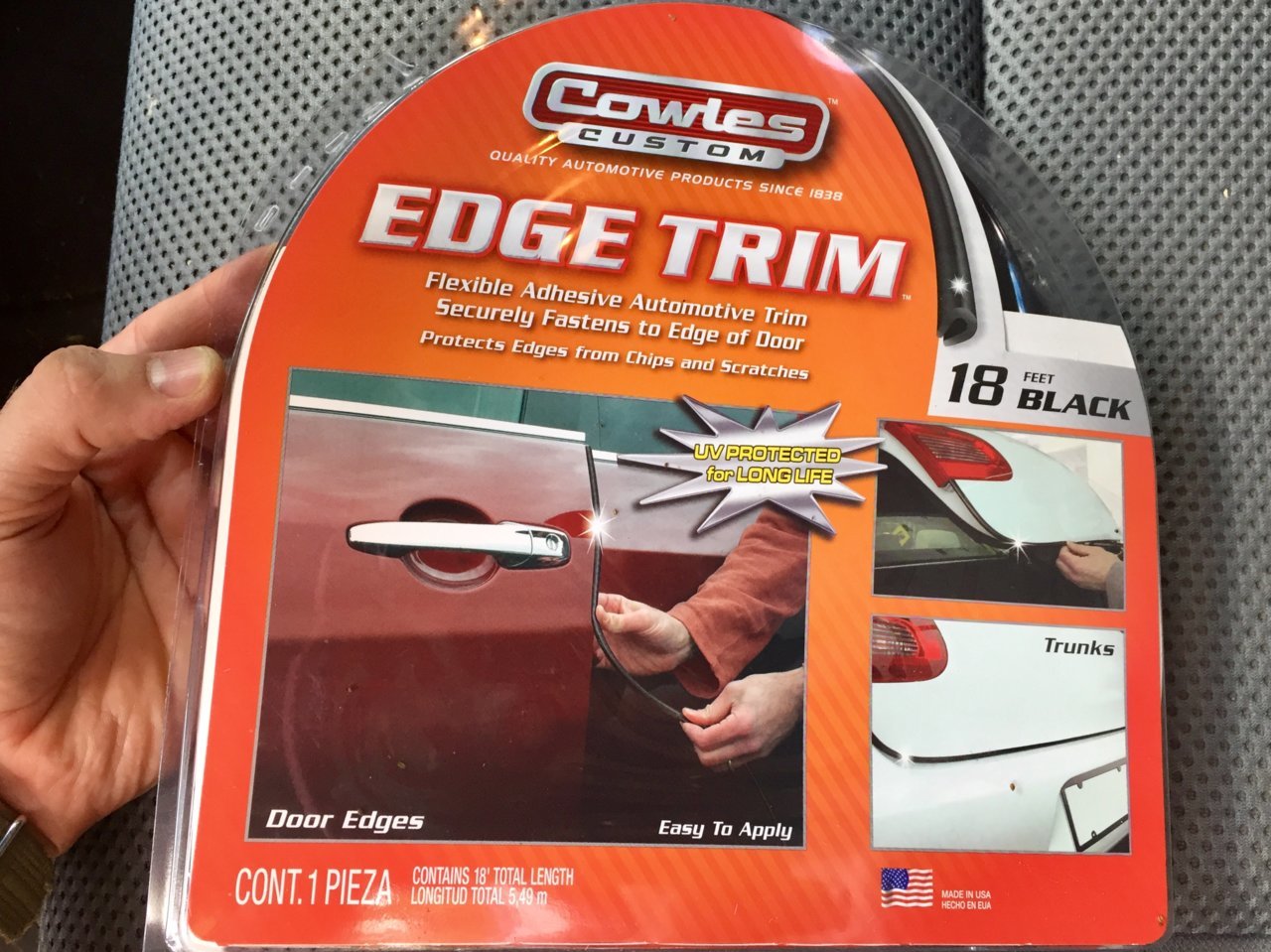

    I was having a problem on my 2nd Gen. It's not a product error, just a minor adjustment for clearance. The gap is minimal at the top of the skid. The lower grill opening on my truck was banging the skid when I went over bumps. The skid was actually digging into the grill and scraping. I grabbed some $12 automotive trim from Advance Auto and fixed it in about 3 minutes. No more rattling:

    You could also add a couple washers to the front spacers. It would keep it off the bumper valance.

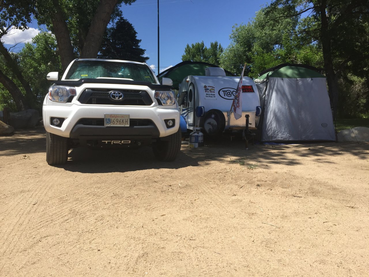

    IMG_4420.jpg Sent you three new customers since we been camping in Bishop!
