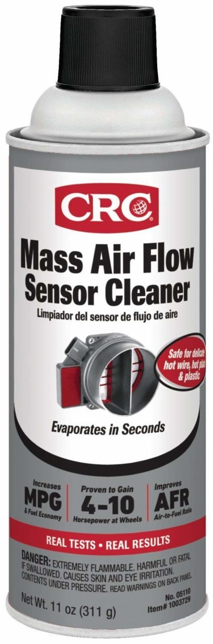

    Was the intake brand new? Did you oil it yourself? Typically if the MAF is dirty or has oil on it it can cause it to run poorly. Always clean your MAF cleaner when installing or after cleaning the reusable filter.

    Try the cleaner, you’ll be surprised. That’s what happened when I cleaned and reinstalled mine
