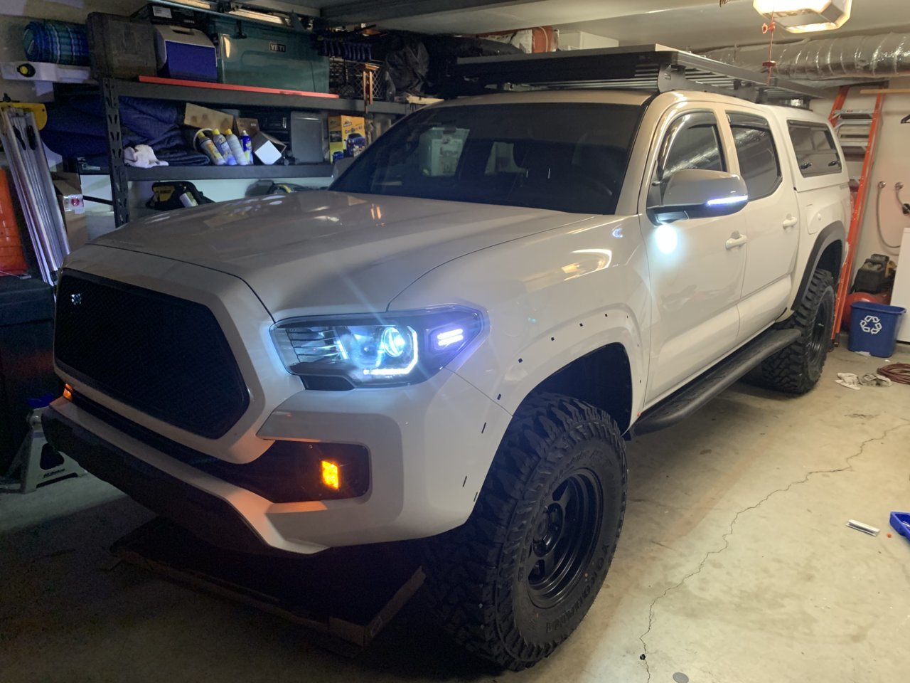

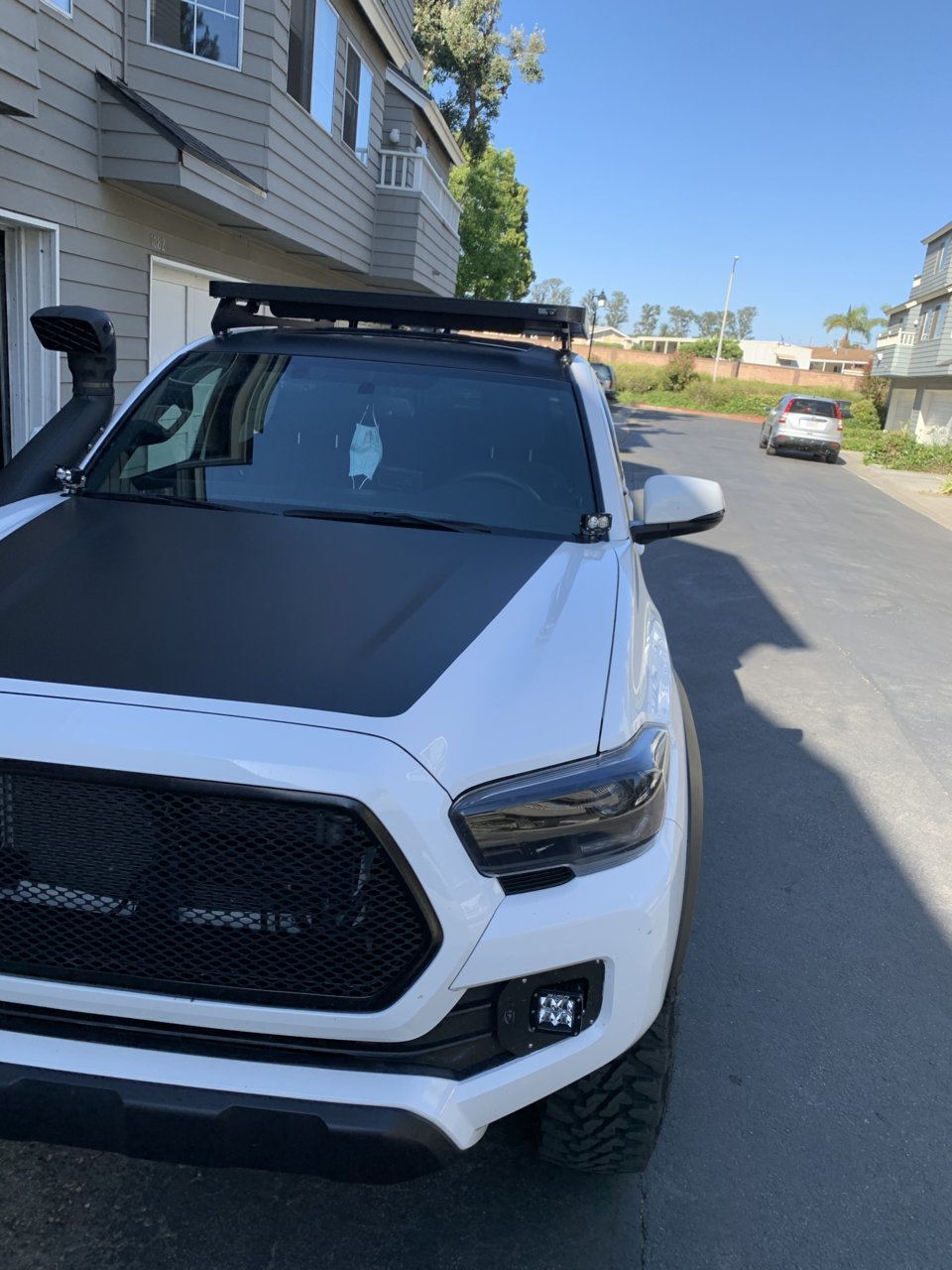

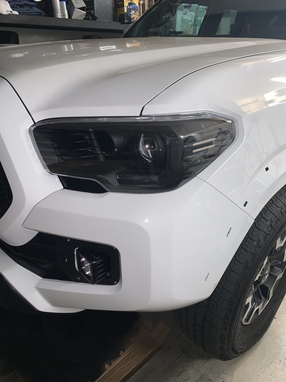

    Finished and mounted on the truck. Can’t wait to get the other projector lol

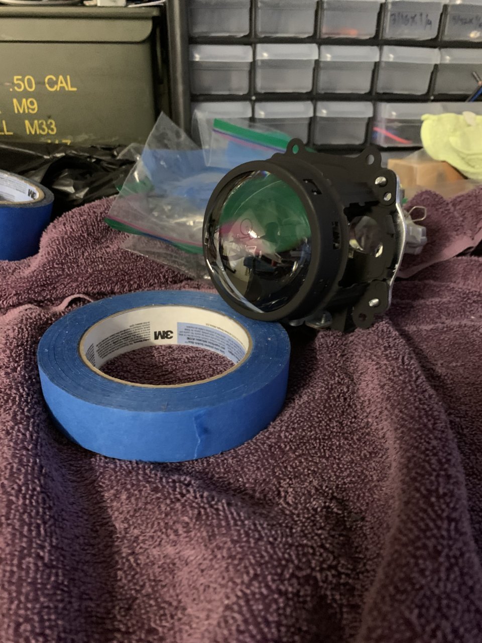

    Other projector finally came today, TRS took care of me. Painted and put back together. But seems Fedex lost my repair headlight so just sitting around waiting more

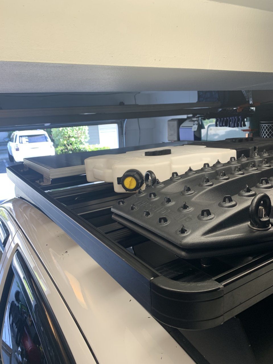

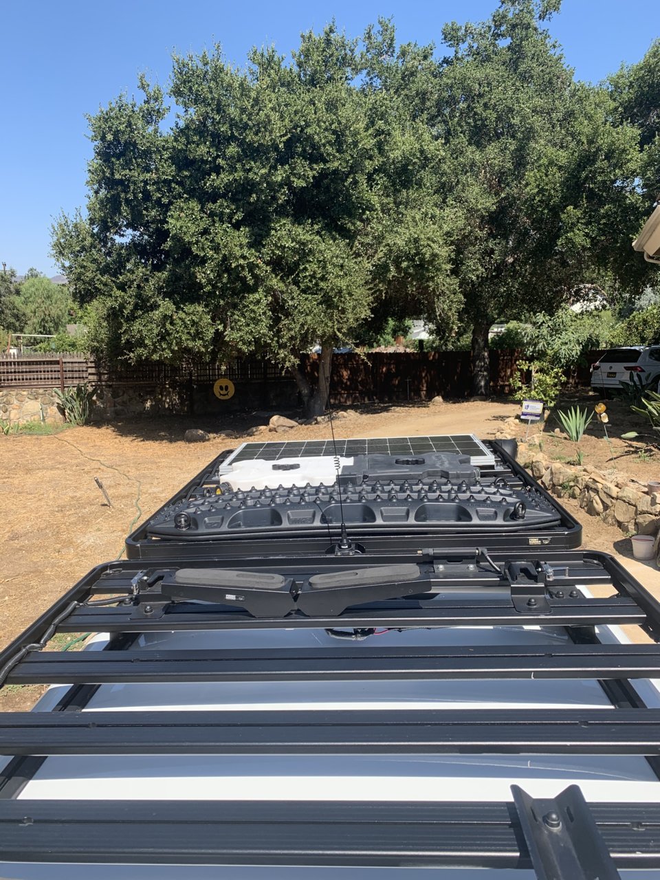

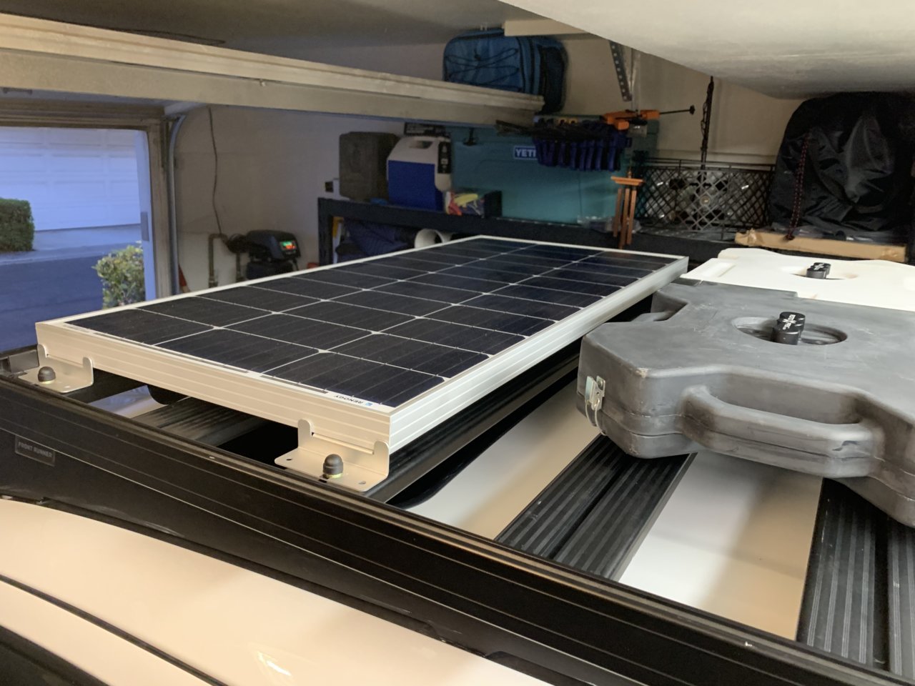

    test mounted the solar panel

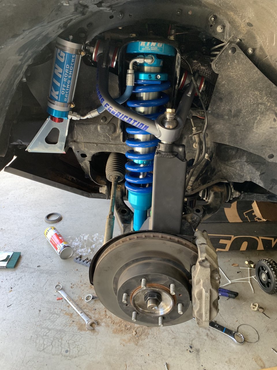

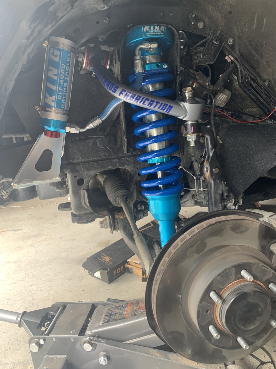

    Torque specs for coil over and upper control arms
    Upper control arm bolt 85lbs
    Uniball 100 lbs
    Bottom coil over bolt 100 lbs
    Top 3 bolts 35 lbs
    Hose mount 35 lbs
    ended up removing the coil overs and taking them to a local shop to get a couple cranks back up
    driver side was 24”
    Passenger side was 25”
    Opps
    Trying to get them to 23.5 max

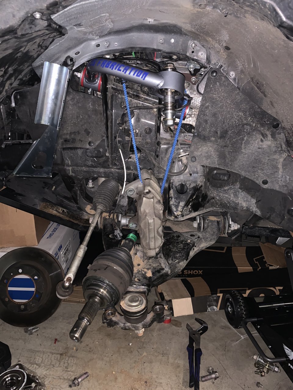

    Took the spindles off to get gussets.

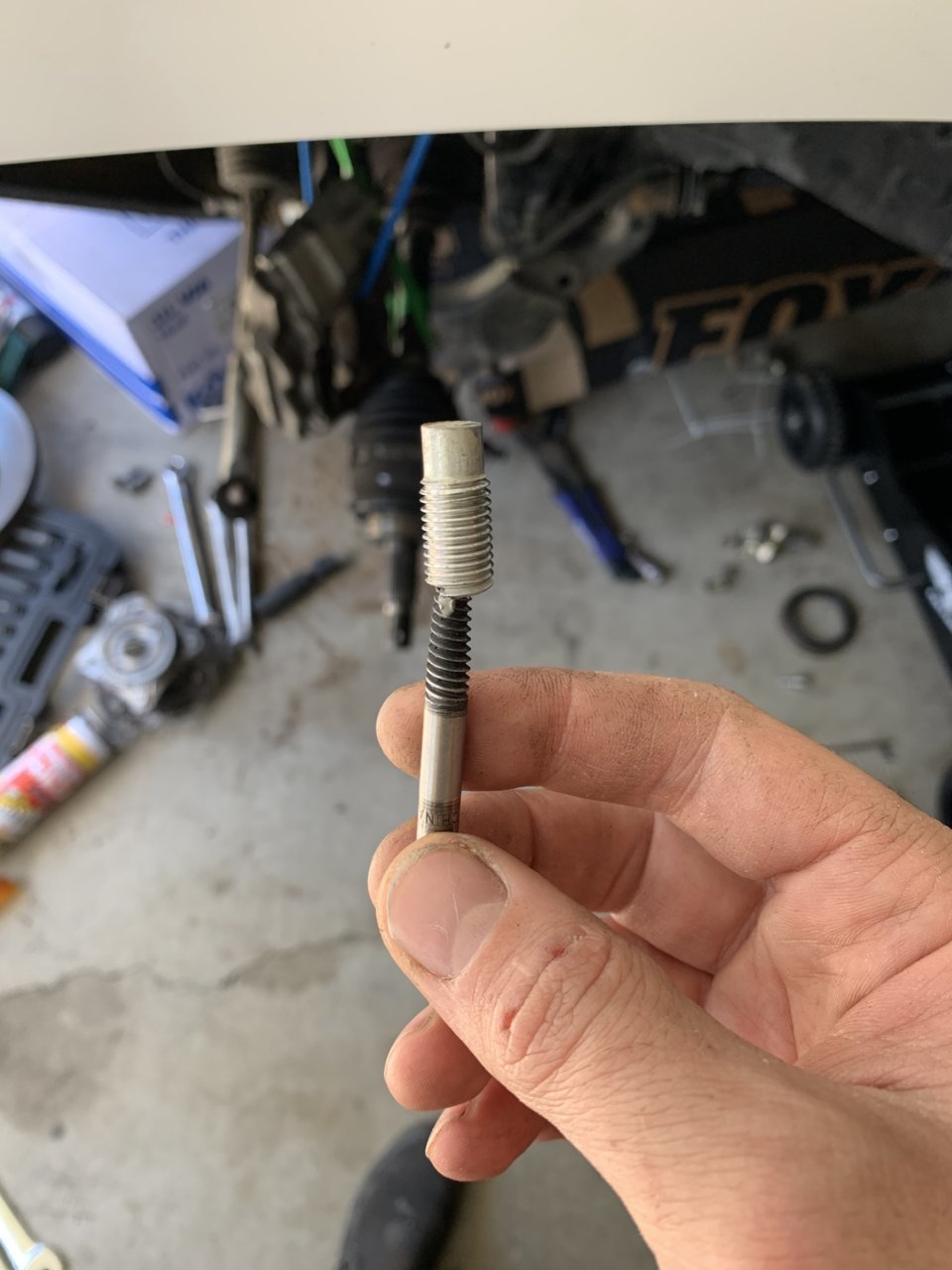

    screwed up and snapped the bumpstop bolt inside the frame so been trying to figure the best way to fix that, think I’m just going to drop my LCA and lube the cam bolt shafts so they never seize while they’re out. Then extract it while the LCA is hanging.

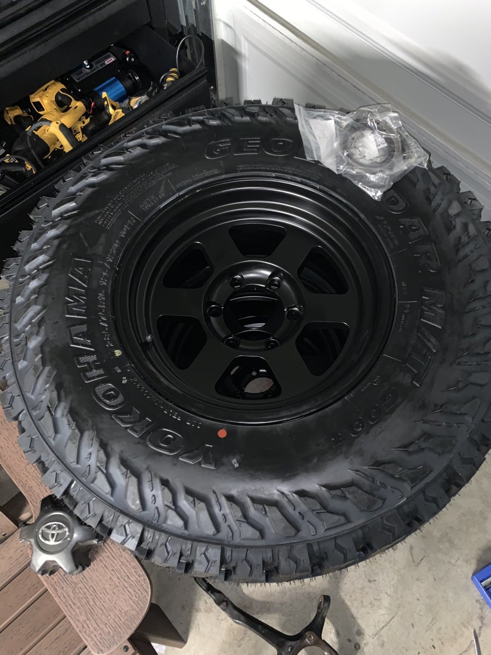

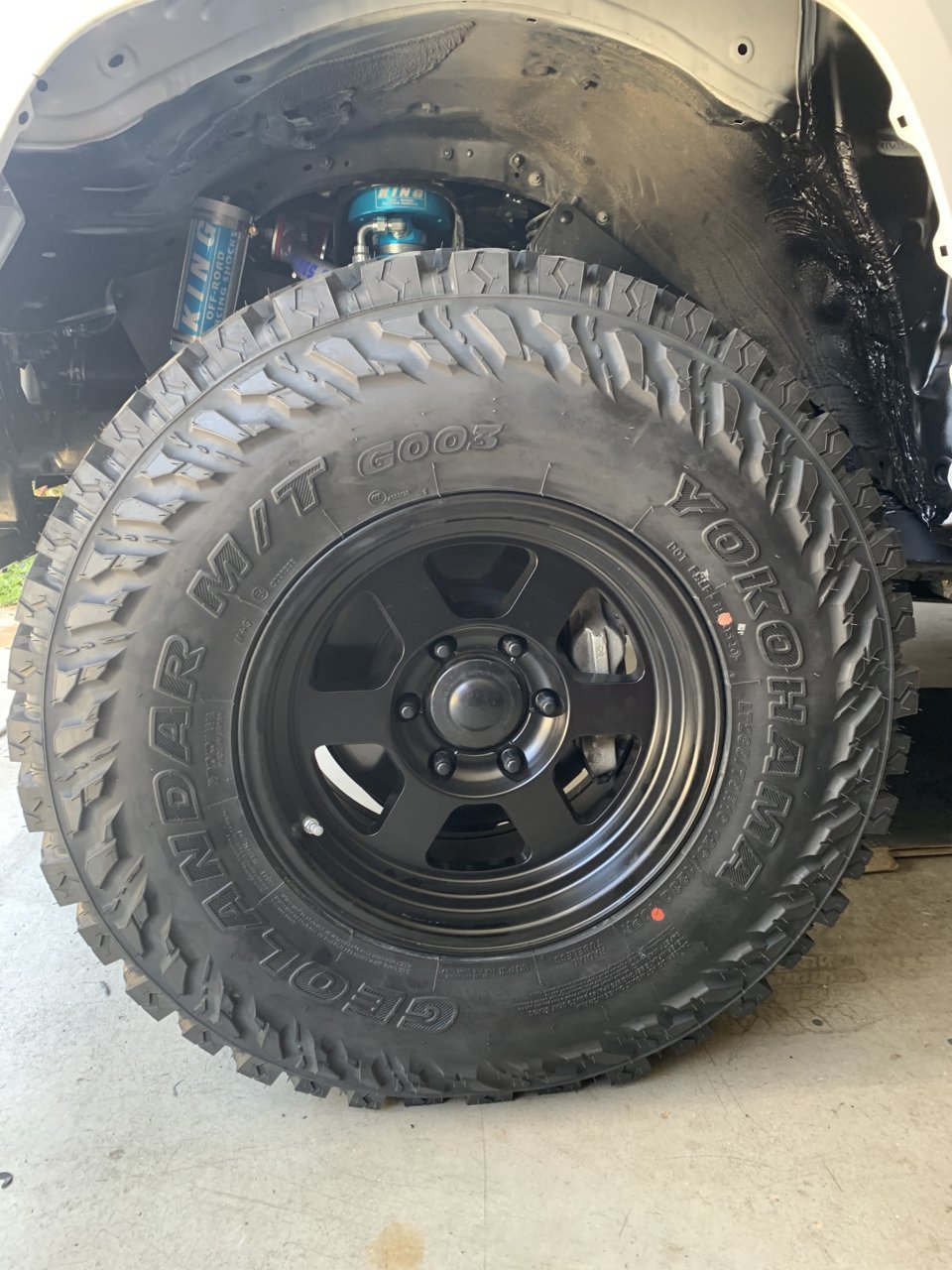

    bright note, got 3 of my wheels/tires mounted last 2 mounted tomorrow

    This bolt can suck it

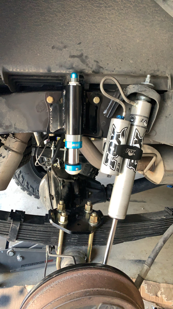

    Coilovers, upper control arms, spindle gussets, allpro expo leafs, fox resi, and retrofit finally done. Eventful few days

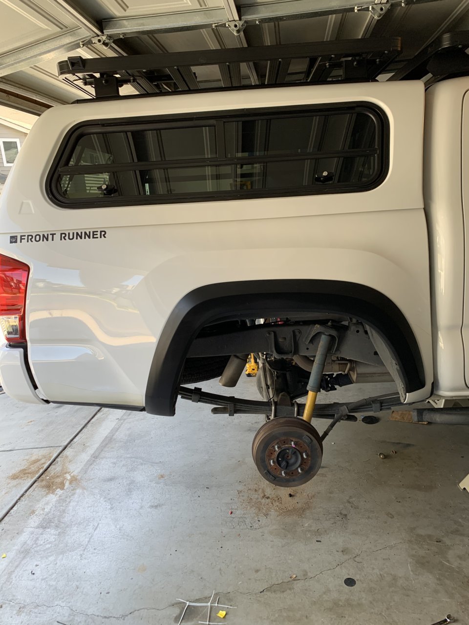

    Archive garage ubolt flip kit with air bump set up came in the mail Monday, so need to install air bumps and that in the rear.

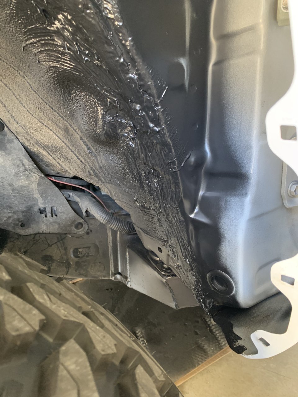

    Got the hood wrapped by a local installer today and smashes my pinch weld and epoxied it, gonna reinstall the fender liners and mold them tomorrow after the epoxy says

    CMC / picture of the wheel well

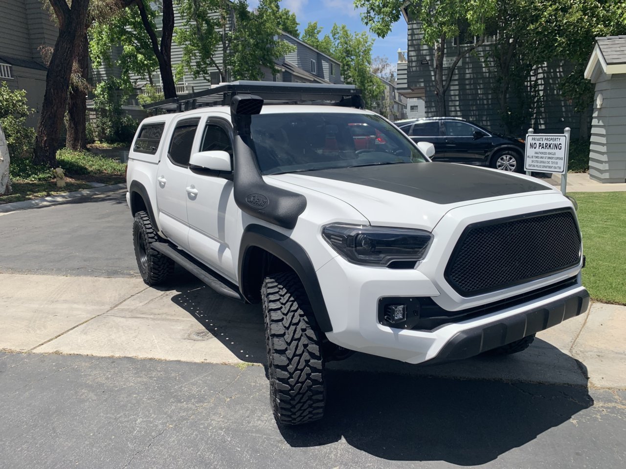

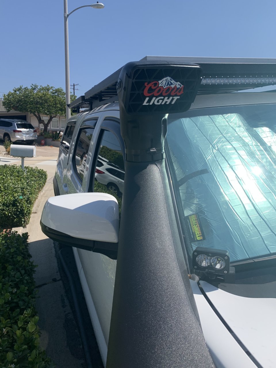

    Snorkel ordered

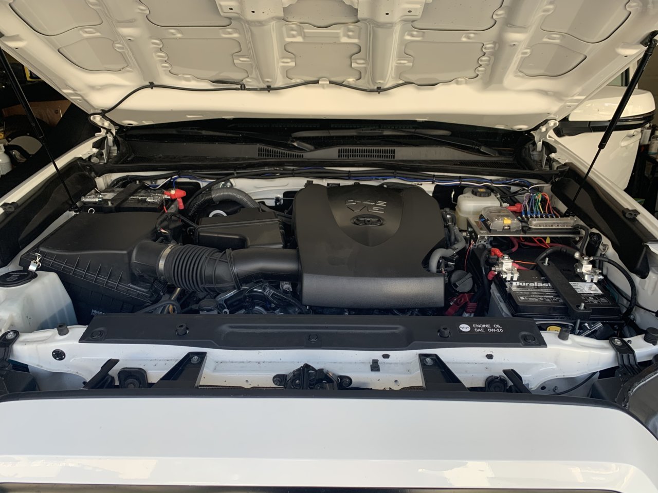

    Had the roof vinyl’d and installed the dual battery kit

    Some installs electrical installs finally done.
    solar wired up, comet nmo mount on a frontrunner adapter so I can move it up and down

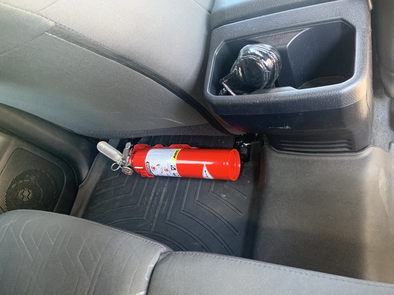

    desertdoesit seat molle mount on the driver front/rear and passenger rear. Fire extinguisher behind the driver seat

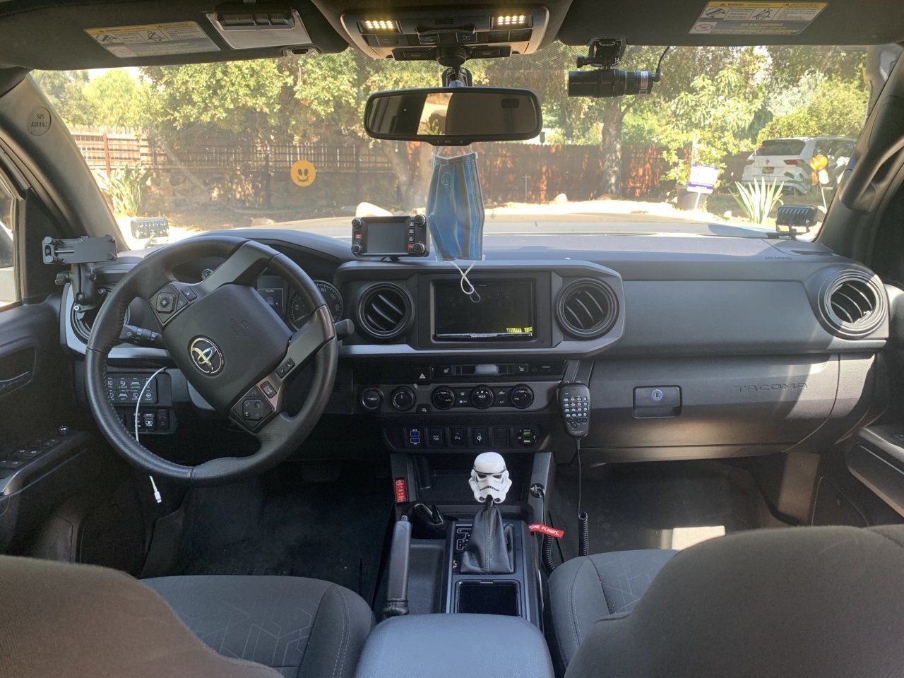

    my dash set up. You can see the dual battery switch, the ham radio, the radio plug I added to the dash for the mic, added a switch for the Meso puddle pods up top, added a dash cam, ran a lighting cable to the driver side vent for my phone mount

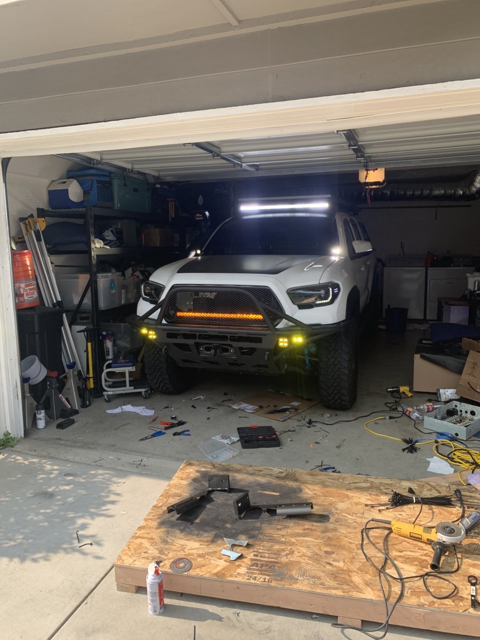

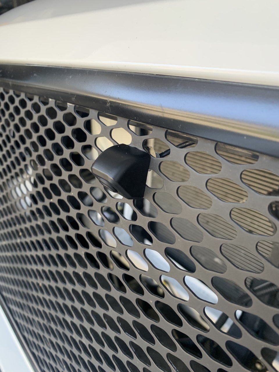

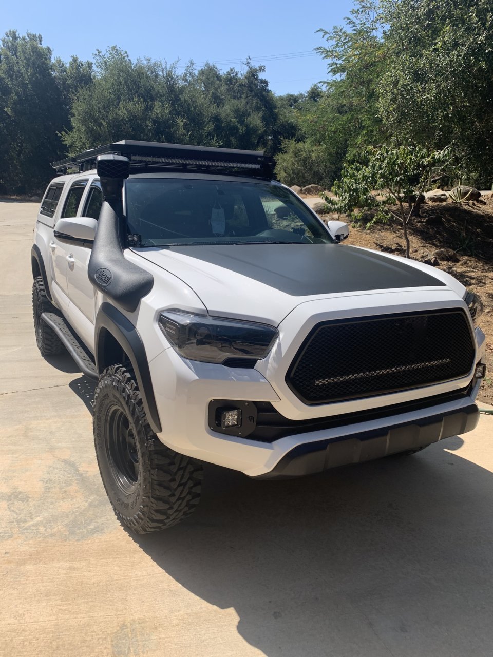

    how she looks from the front. Caliraised 40”single row combo under the front runner rack, 30” single row amber behind the grille for now, put a front camera in the grille

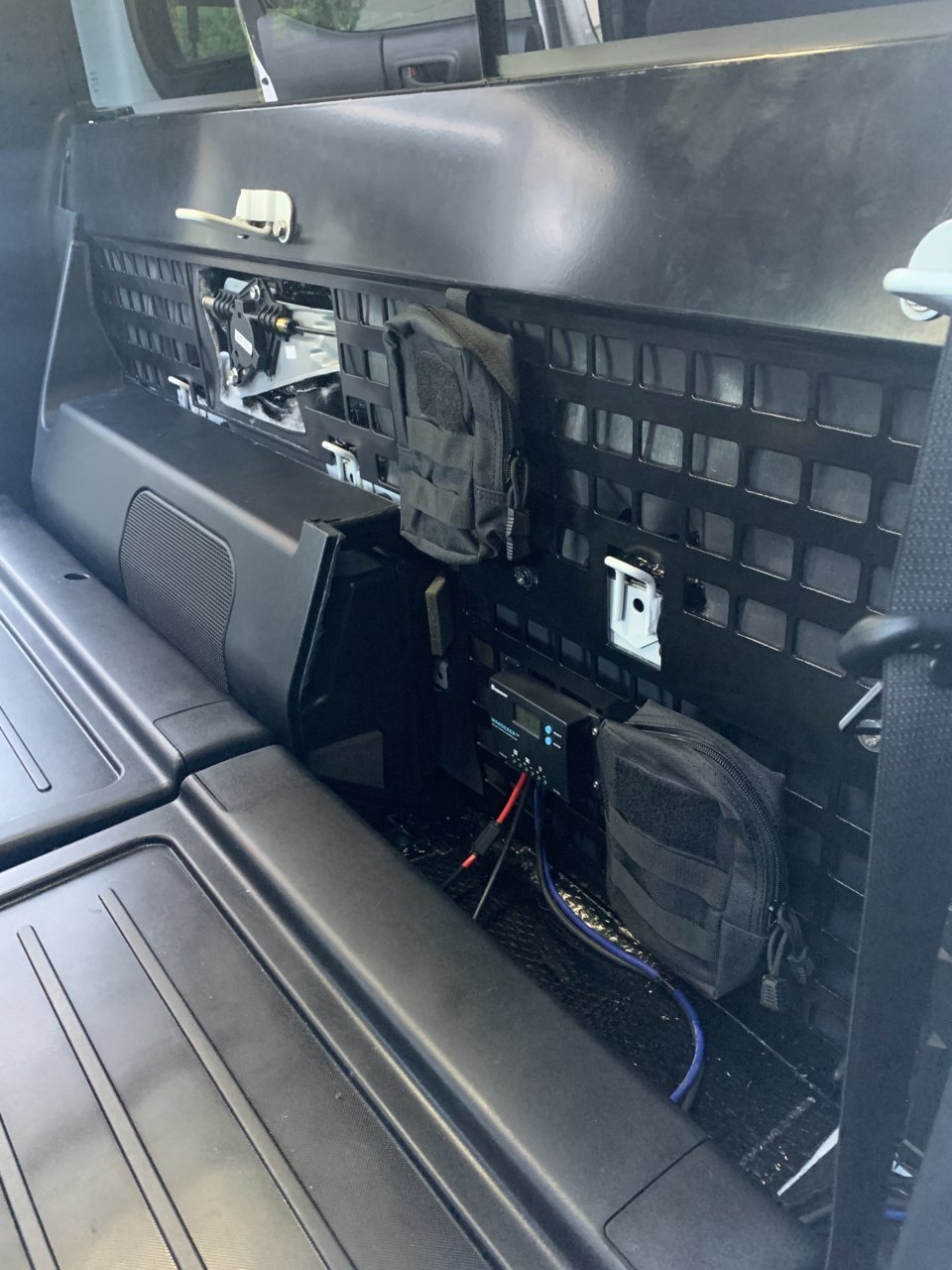

    Installed the molle panel behind the seat by docloco and got the solar controller mounted on it today.
    Since I sound deadened it all I need longer hardware woo

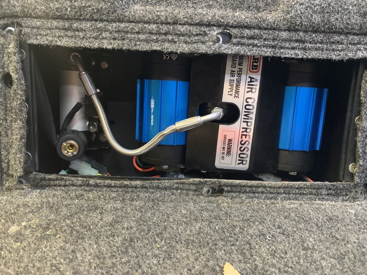

    installed the expedition essentials compressor mount and my compressor. Didn’t like the placement of the locker manifold so ended up redrilling some holes and mounted it this way

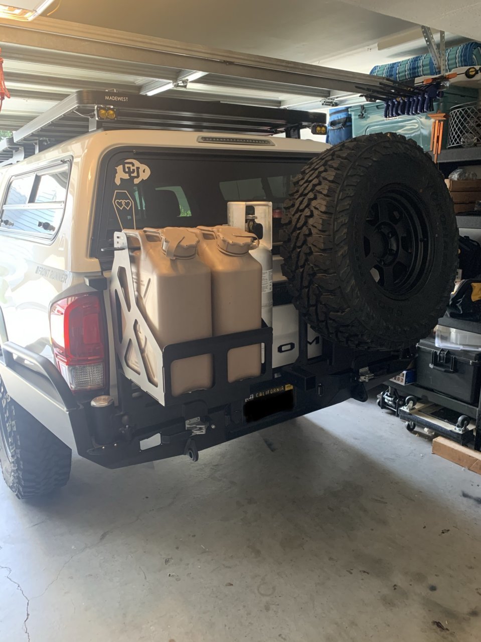

    bamf dual swing out with spare tire // gas cans // table // propane mount

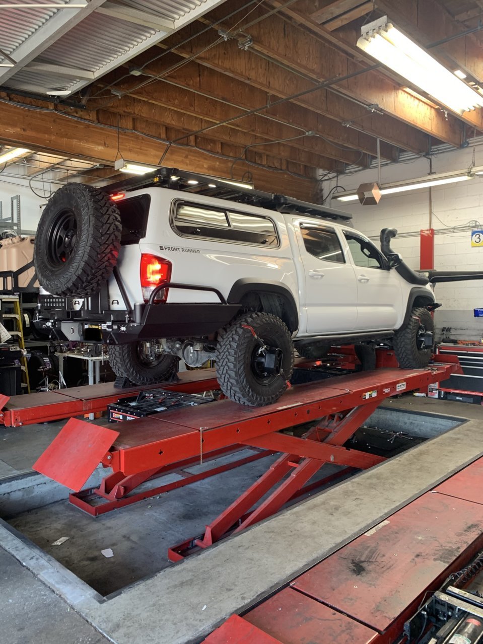

    Getting it aligned ... again
