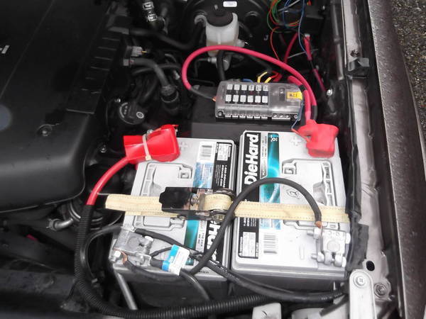

    I replaced my stock battery with 2 Die Hard Platinums side by side strapped in an ATO tray in the stock location. Tight but it fits. I will try and dig up a picture tomorrow when I am near a computer.
  20. Aug 28, 2014 at 11:16 PM
    #20
    chris5255
    chris5255 Me mber
    Dec 5, 2011
    #68244
    254
    Renton WA
    12 Tacoma DCLB TRD Sport-'07 FJ Cruiser
    BAMF Sliders Fog light switch mod, Pelfreybilt Front bumper, Warn Zeon10 winch pinstriping for speed
    Found the picture.
