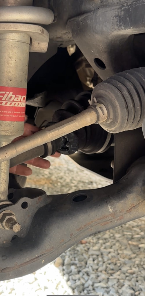

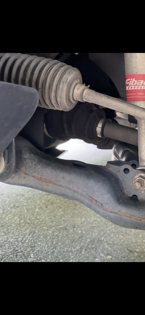

    So I just discovered my boots are torn again. One is completely torn the other has a hole.
    I just had the axle and boots replaced last May for the same reason
    I’ve got an Ebiach stage one lift on the third level with Spc uppers
    how do the axle angles look? I haven’t noticed anyone else having issues with this lift setup
  2. Aug 21, 2024 at 7:16 PM
    3JOH22A
    3JOH22A トヨタ純正男娼
    Mar 27, 2019
    #288172
    13,111
    District 6ix
    3G Tacoma on 35"s, 5G 4Runner
    PDKTaco likes this.

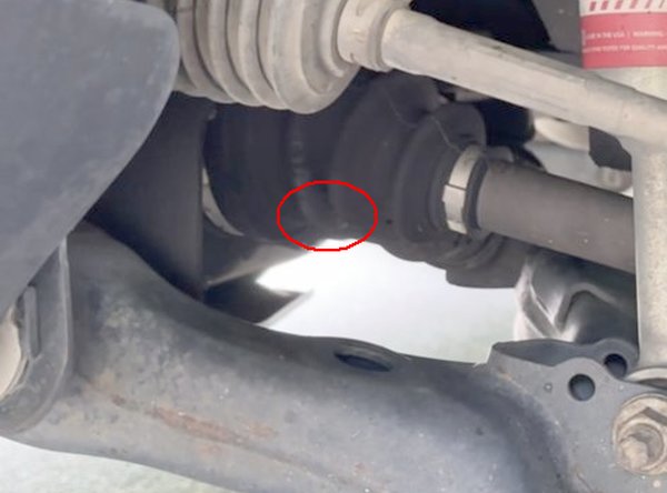

    Even with it tearing lower down towards the first ring?
  4. Aug 21, 2024 at 7:32 PM
    3JOH22A
    3JOH22A トヨタ純正男娼
    Mar 27, 2019
    #288172
    13,111
    District 6ix
    ^You have aftermarket boots? Those can be shitty. With OEM boots, usually the crest of the fins wear out first.
    ^I'm asking because those don't look like OEM clamps.

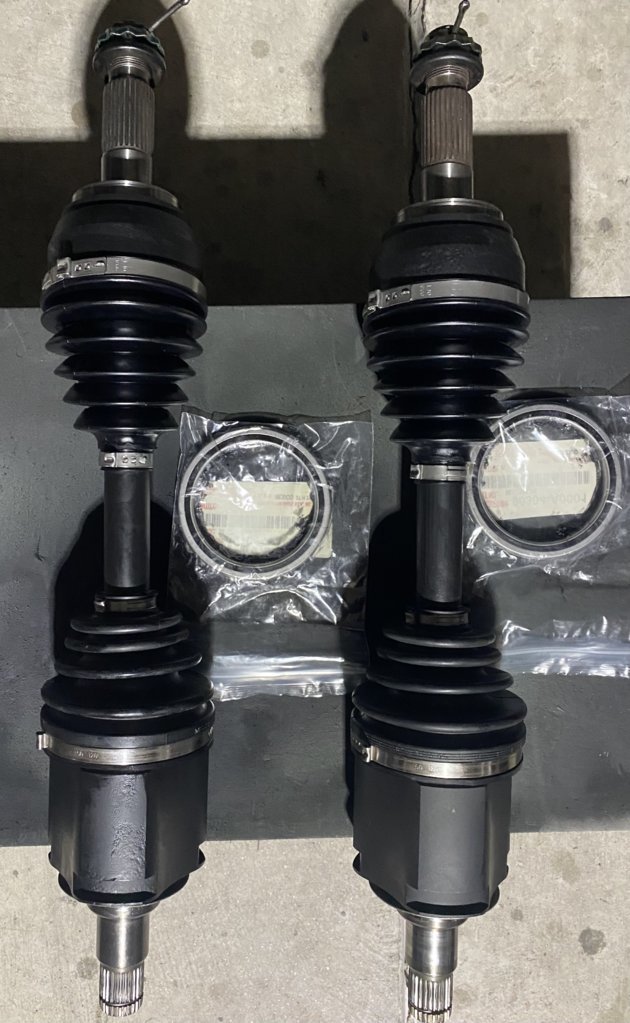

    do you have a picture of a oem one, trying to find one

  10. Aug 21, 2024 at 7:46 PM
    zippsub9
    zippsub9 Well-Known Member
    Nov 3, 2014
    #141634
    4,580
    Halfmoon, NY
    14 DCLB
    Shit bolted onto other shit, and junk.
    First Gen, but same OEM clamps. Those are not OEM and not what come in the parts kit.
    RotorRPM and Chew like this.
