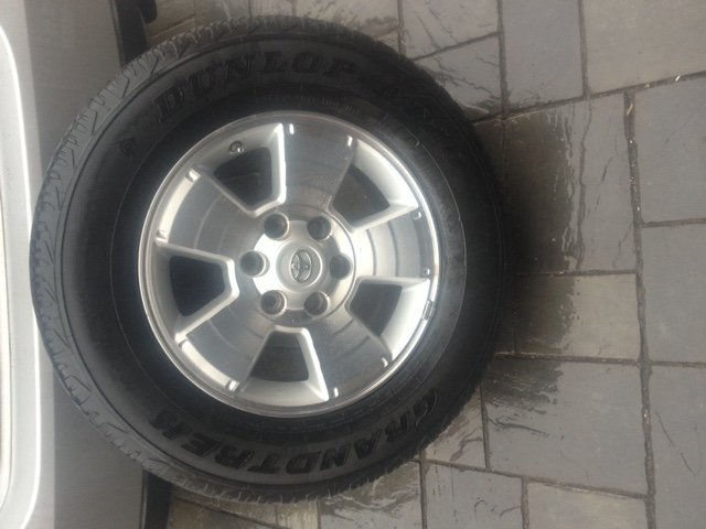

    is anyone running second gen wheels on their first gen? I just picked up a set and would like to see some pics of peoples rigs that have them, prolly be a month or 2 before i get mine back but i would like to see how they look,
    These specifically

    no mods needed with stock tire size (265/65/17)

    Looks good bud, thanks, i was wondering about the offset too, nice to know they worked out for you

    no rubbing either even tho they have more backspace than the <04. If you move up in size you will need spacers to keep the tires from hitting the upper control arms
