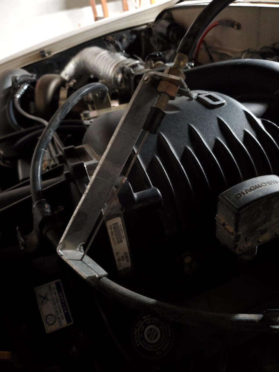

    I don't know if your generation still has a kick down cable going to the transmission or if it's all electronic, but if it does, make a bracket to hold the cable at max line pressure. I used a few zip ties for awhile before I made the bracket.20191203_192501.jpg
    Kick down cable mod and large B&M cooler are the only mods on my boosted 5vz. Works great so far. I just dont let it shift at max power.
