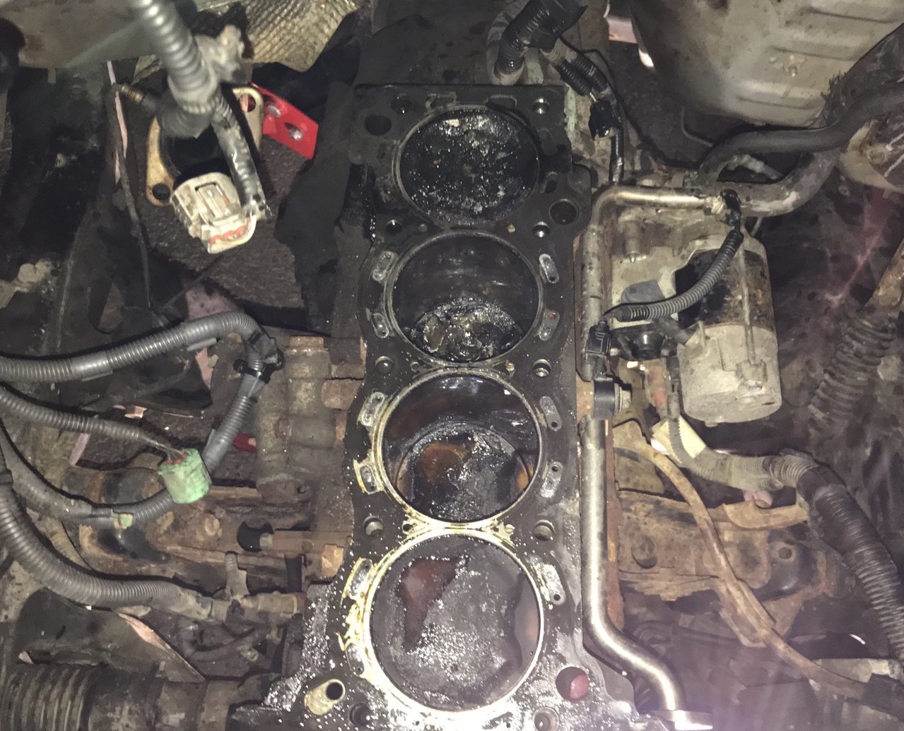

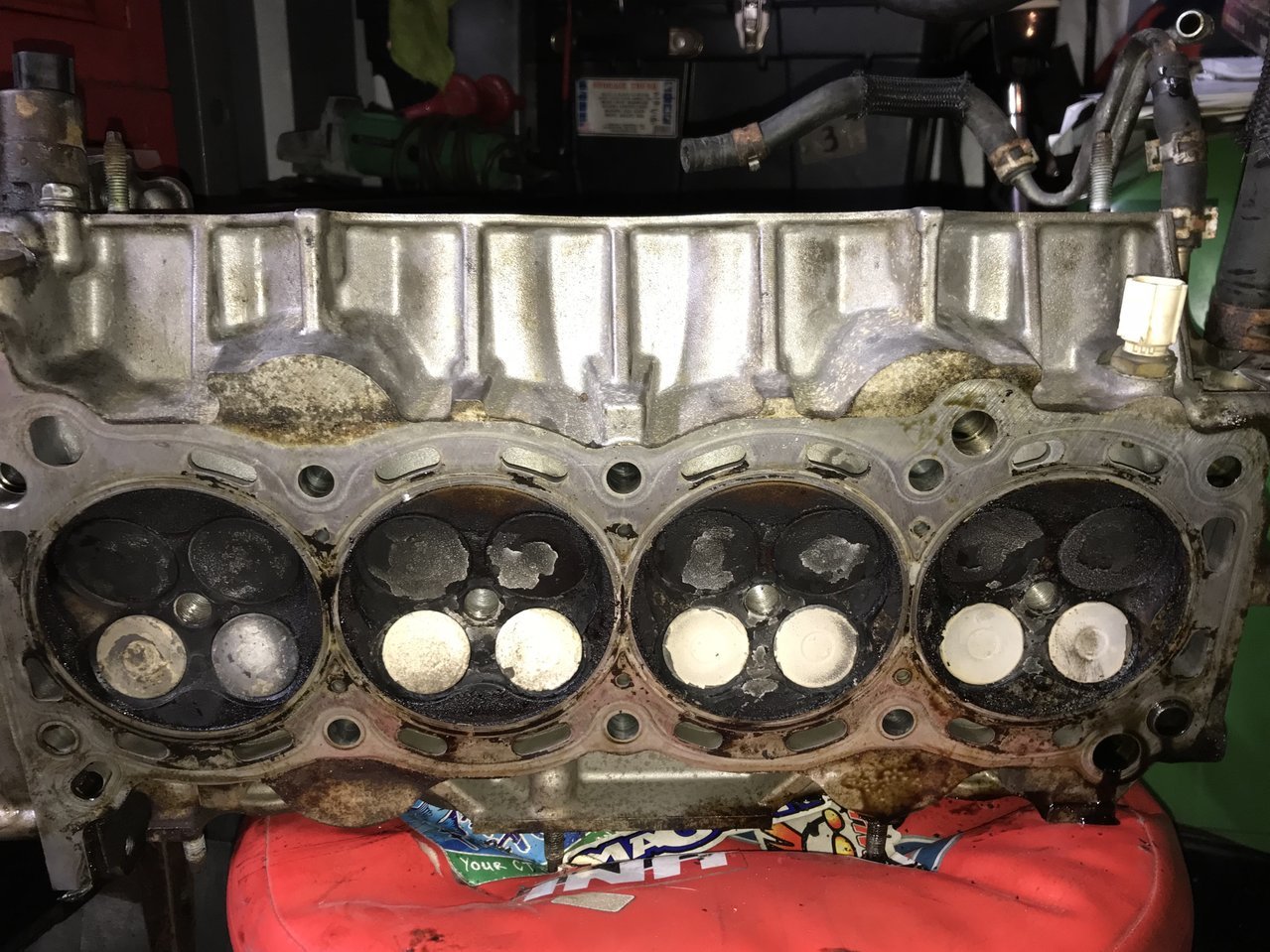

    99E28294-FB03-424C-BC36-DB9E9D66B454.jpg Has anyone with a 2nd Gen. 2.7 ran into a cracked head? I have not heard of this being an issue, a local machine shop says otherwise. I am asking because currently I have the head removed for gasket replacement, and I am debating whether or not to have the head resurfaced, cleaned and pressure tested at a shop or just doing it myself the old school way. No visible cracks, I still need to clean her up and check the valves. But I am trying to refrain from going balls deep on machine work, head and valve replacement.

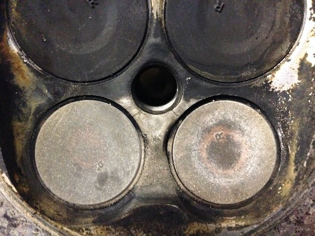

    Yup, it was a 3RZ-FE engine. I found low compression on #3 chasing a P0303 error code (misfire cyl 3), took it to a shop and they removed the head. Cracks weren't visible until the carbon was brushed away from the chamber...pic below.
