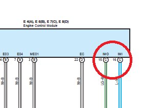

    I am in the u.s. the donor truck was Canadian spec. I currently have a active subscription to TIS to verify all the wiring is the same. According to the schematics the wiring to the ecu is the same.

    The PCM can't know the difference between an immobilizer equipped harness and one without, I wonder on ones without maybe IMO and IMI are shorted together? Maybe worth a try and see what happens.

    that what confuses me. the schematics show no difference for the immobilizer engine harness and non immobilizer engine harness. I just shorted the imo and imi wires together and there was no change. the only conceivable thing I can think of is Toyota hid a resistor or something in the harness to tell the ecu its a immobilizer engine harness.

    Not sure how or where, those 2 wires appear to be the only difference. What if you ground those 2 wires?

    I would see about de-pinning these two wires at the ECM.

    I grounded them. no difference
    with the original immobilizer equipped ecu it will start then die, with the new non immobilizer equipped ecu it cranks but does not fire.

    Have you tried de-pinning these two wires at the ECU?

    yep I depinned them. no change.

    This seems odd as the only two wires I see going to the ECU from the immobilizer ECU are IMO and IMI. If the original ECU had an immobilizer and the new ECU part numbers are the same, then does the new ECU also have an immobilizer?
