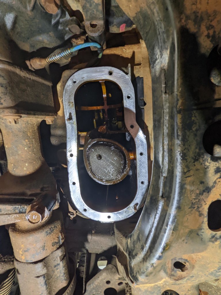

    I might have used a ratcheting wrench Idk it was back in 2022 after a huge tree fell across my property. I wasn't focused or taking good pics but in this one I can't see anything majorly in the way. I guess they could have changed something since,the 2006 model.

    this pic looks like you had just enough space to reach the bolt near the diff

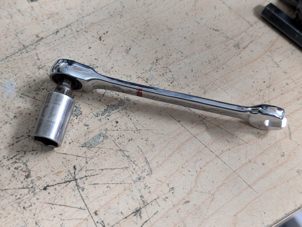

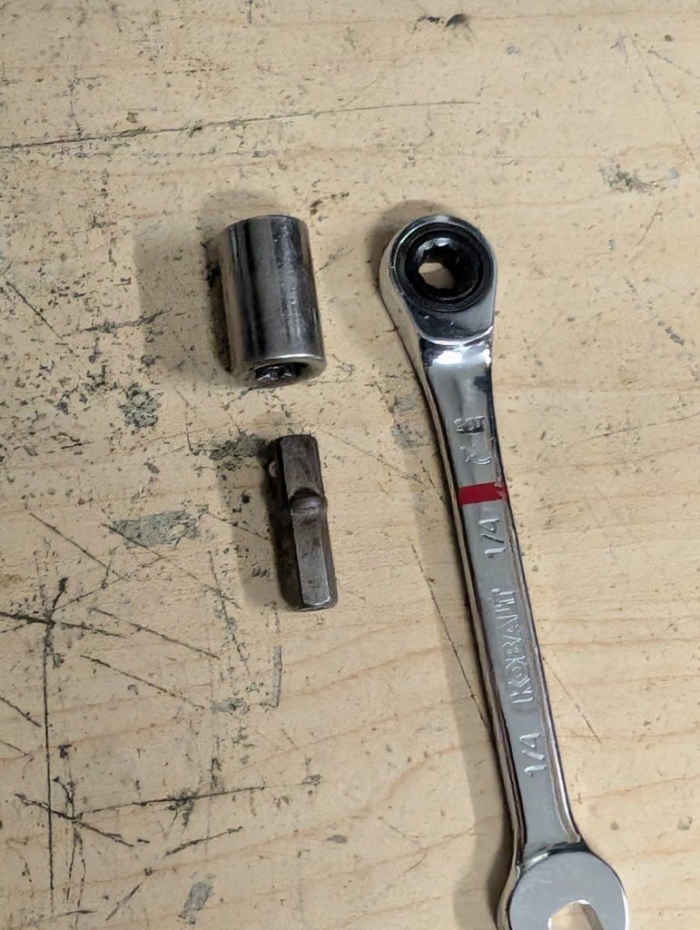

    It's possible I used a setup like this? It may be smaller than a ratchet and give a little different clearance than just the wrench.
    A socket adapter from one of those multi-bit sets.

    2008 dcsb trd offroad 4wd
    I just did this. I used a 1/4” extension/socket and a swivel adapter, however if I did it again I would use a 10mm open end wrench instead. Make sure to clean your oil pickup screen
