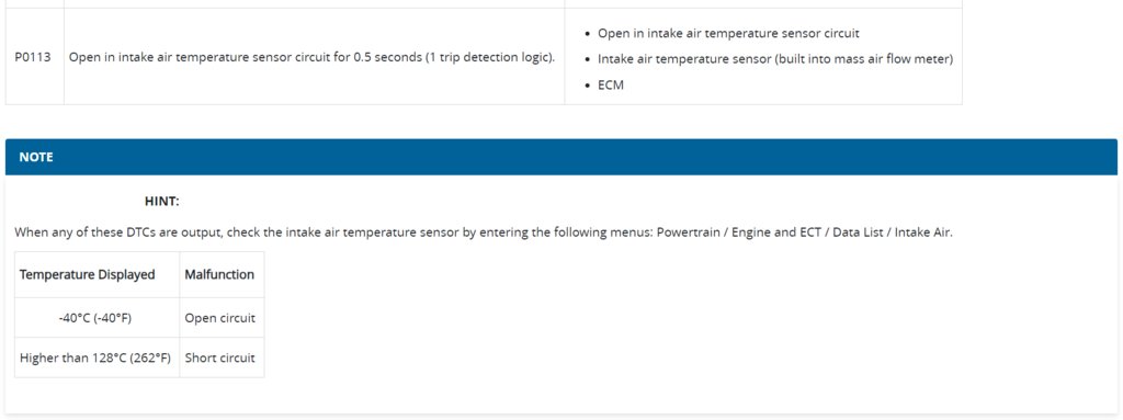

    @TnShooter the first freeze data showing the -40 im not sure my obdii scanner was registering properly (or maybe something really is F'd up).
    right after that the live data shows 37c for IAT and then the 2nd attempt freeze data shows 40c

    -40 on a temp sensor is an open so your either losing Sensor Ground, the Signal wire is open, or you have a flaky sensor/connection.

    It's possible.
    -40 is for an open.
    I'd do the wire tug and wiggle test/

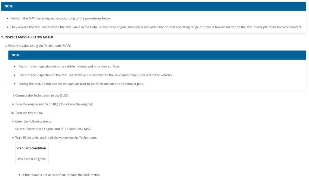

    @livpool14
    Do one more thing.
    Engine off. Key ON.
    See what the MAF reads.
    FSM says it needs to be .72 g/sc - ENGINE OFF.

    It's showing .56 g/s so that seems to be right.
    One other thing. I'm not sure what the higher end cutoff is but while I was just out driving I saw it get to as high as 88 g/s

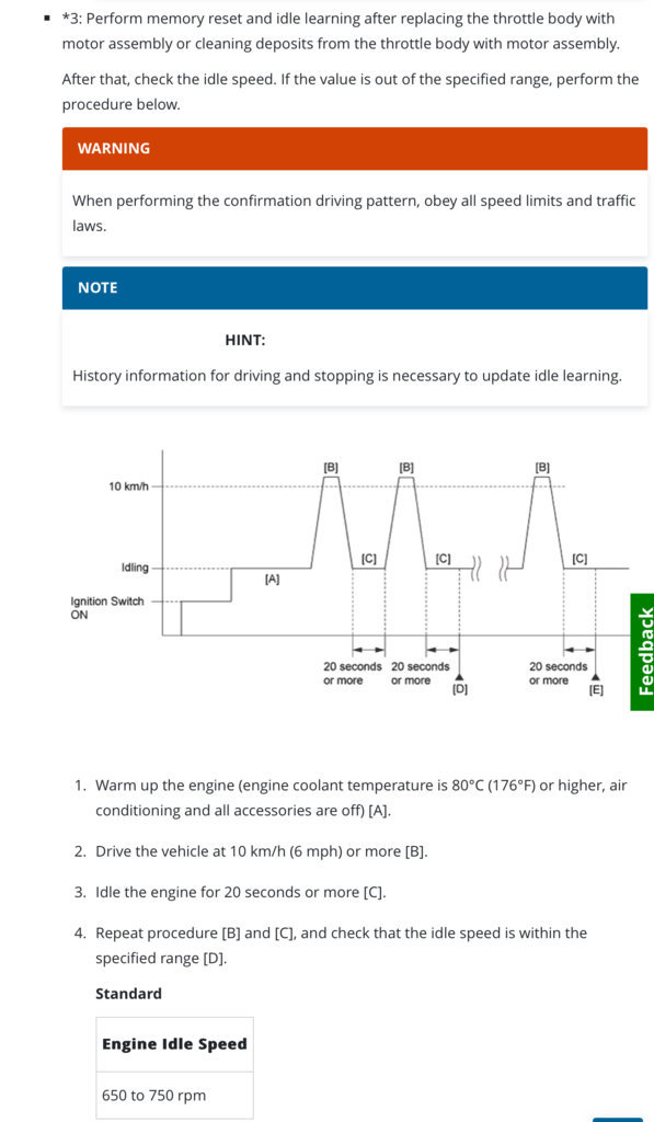

    Something else I'm noticing [not sure it means anything] but when I initially turn the key to the on position there are no noises what so ever. The second I push the gas pedal at all there is this continuous high pitch whine that does not stop coming from the TB. Is that normal? The second i turn it off and back to ON the sound is gone, until I touch the pedal again.

    I can’t say I have ever heard mine make that noise.
    But……I can also say I don’t recall ever having the hood open, engine off and pressing the gas pedal to have heard it.
    I try not touch the ignition switch when working on my truck. Especially if I don’t unhook the battery.
