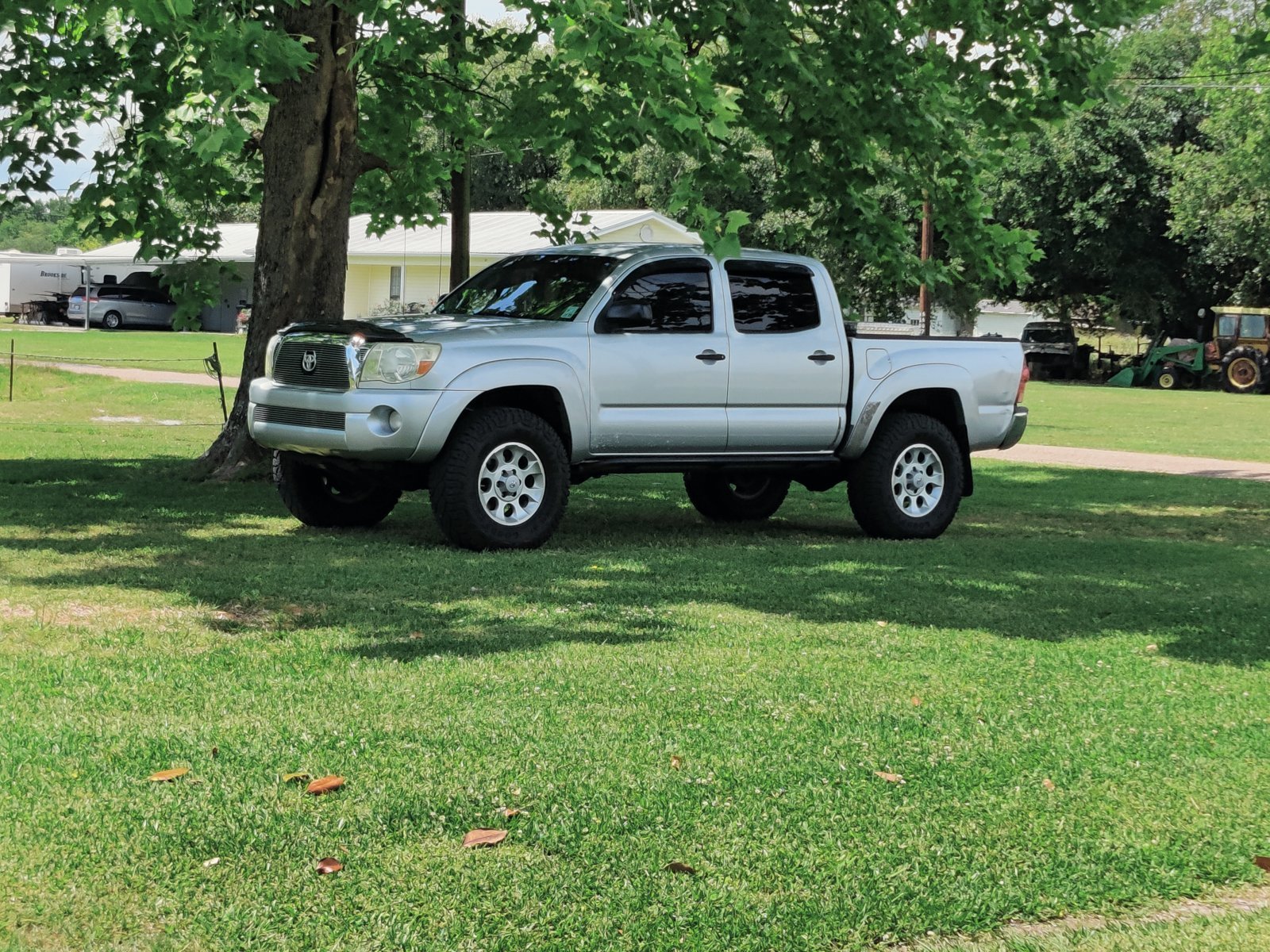

    5% Tint, Bug flector, vent Visors, Removed secondary air filter, Rear Spring TSB w/ Wheeler's Add A Leaf HD Pack, Icon 2.0 rear shocks, Toytec 3" lift up front with Total Chaos UCA's, Debadged, Billet Grille,TRD Offroad rims/17x9 Pro comp 6001 rims, Duratracs 265/75/16 or 285/70/17, Fog light anytime mod, Tailgate hose clamp mod, Pro-dry AFE filter. Extended Differential Breather, ABS on/off, 6000k LEDs from CSJumper, heads/fogs, ScanguageII, Devil horns, Devil horns on third brake light, Mounted 60" Highlift, Mounted Tool Box, Wet Okole Front/Rear Seat Covers, TW sticker, Midland Handheld CB,Painted engine cover, Revenge Fab Sliders, ARE Topper, Weather tech Floorliners, Camper shell, ultimate headlight upgrade. URD -3° exhaust cam gears, .5" XTP Intake spacer. Custom dents.
    2007 4x4 4.0
    285\75\17 Wrangler Duratrac RT
    FJ wheels (15mm offset) .75" Bora spacers, cab mount chopped as well as some plastic fender, pinch Weld was beat back also.
    Total Chaos UCA, Toytec 3" lift up front & Wheelers add-a-leaf HD leaf pack 2.0 Icon shocks.
    Stock 3.73 gears currently avg 14.5 mpg.
    Flexed at home, no rubbing issues. I'm not certain I won't find some rubbing once I get it off-road, minor if any I suspect.
