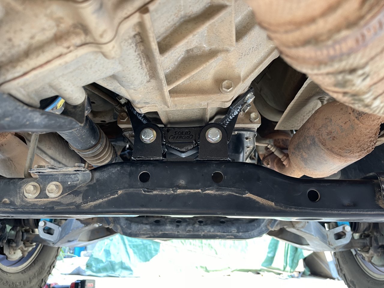

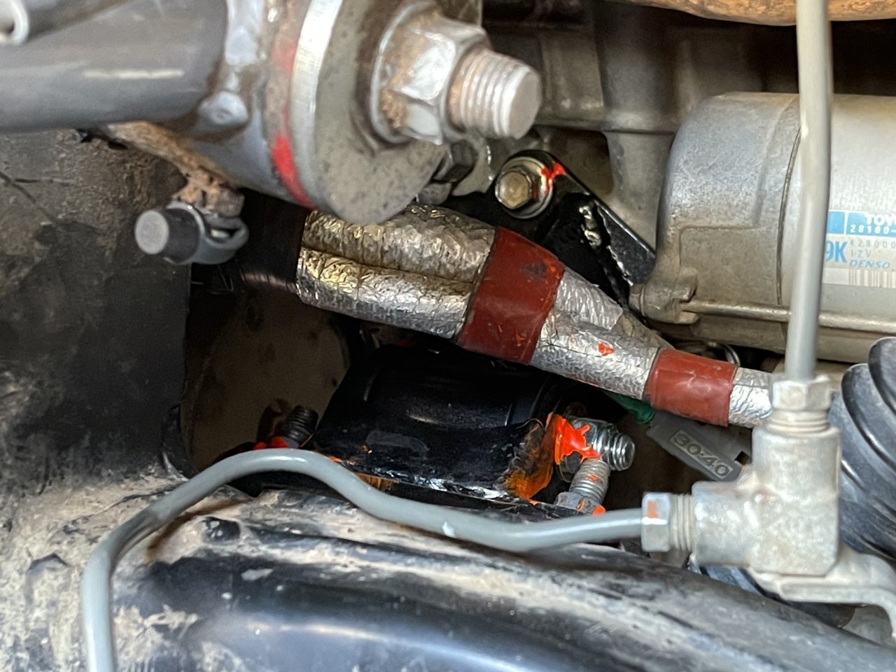

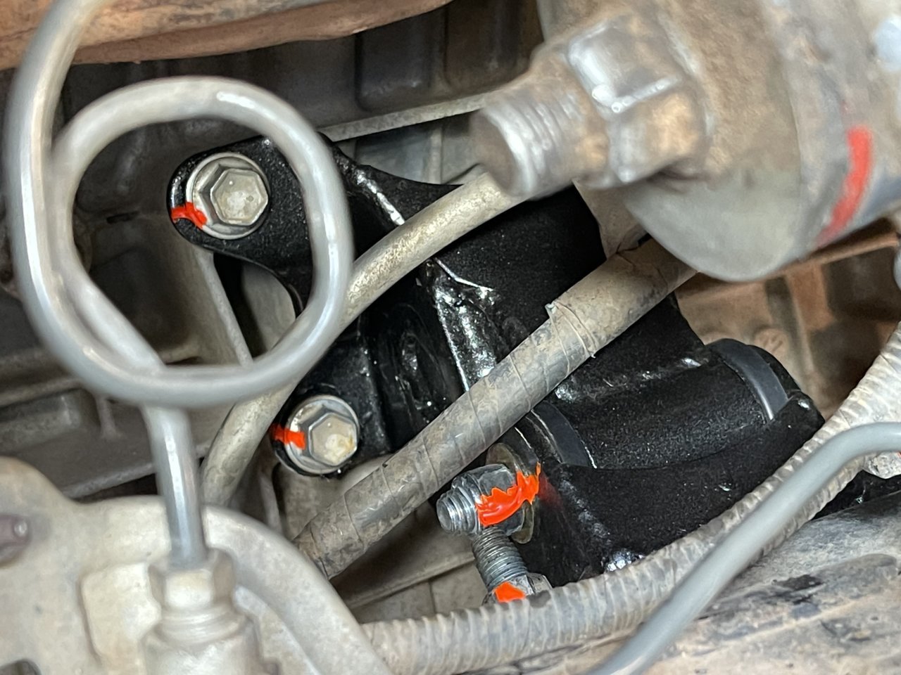

    Got my engine and trans all setup. was a bit of a pain but was able to get all installed without removing any extra stuff. Only thing we did was drop the front diff a bit. You can work the drivers side mount out if it’s dropped enough. Also did it without separating the 2 halves. That may have helped but we had already removed the frame side bolts. Engine bolts were torqued to spec most of the frame side and good and tight couldn’t get the wrench in there. Tossed on some thread checker for later viewing (pardon the mess we were over it by that point)
    Thanks to @Bonzen for the Sunday responses and @Athlaos for some additional tips. Had a buddy help. Usually solo wrenching but def nice to have an extra hand.

    ha partially. I would say it feels like it's putting down more power but the truck doesn't feel a ton faster but only had some limited time on it. The initial hookup is solid though that is def noticeable. I also recently added archive hangars and cross brace.
    I need some more time on it to say for certain. I am getting some axles wrap in the rear so the leaf pack has to go (new one on order).
    For anyone concerned with feeling. There is some slight vibration but not much it will come down to the end-user and how comfortable they are. You race truck parts its race truck parts. When driving it's not noticeable. The truck does sound a big difference from nothing soaking up the vibrations and the overall drive train does feel more solid.
    Need more time but install was not too bad just a pain getting the drivers side out.
