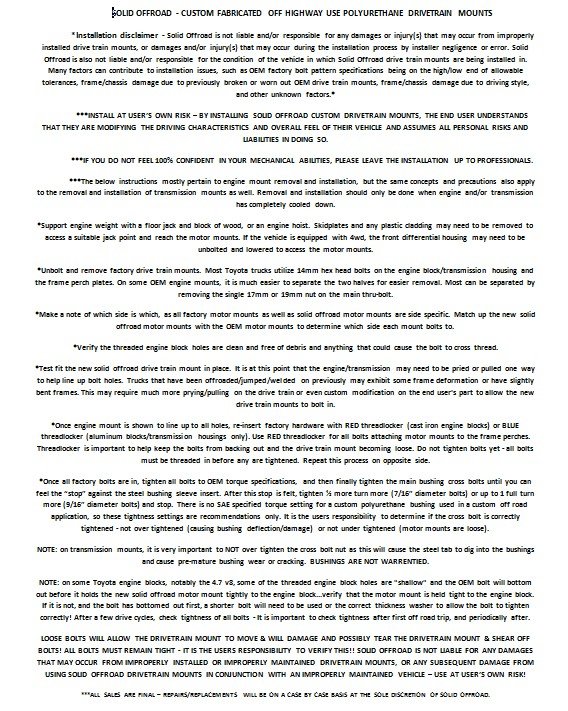

    I attached a screenshot of the instructions. Cant attach a MSWord file so hopefully this will come through. But the installation is pretty straightforward, definitely not rocket science. The spaces are just tight, thats your biggest adversary.

    Thanks. Any chance you could convert the MSWord doc to a .PDF file (usually this is an option in the Print.. dialog box) and attach that? The screenshot posted above is almost impossible to read.

    PDF attached :thumbsup:
