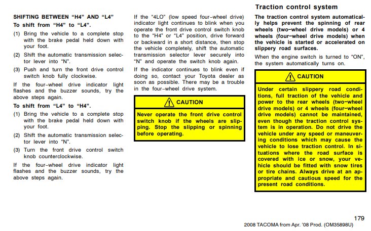

    Hey all! Long time listener first time caller. I've read up on several threads on the forum trying to understand the blinking 4lo light I have while trying to engage. I just wanted to ask if anyone had tips, links or a better understanding than I do about this problem. Of course, I found that my 4WD is out after a 1/4" of ice and 3" of snow. I'm in need and want to try to get under the truck this weekend if I can make it back home.
    Variables I do know:
    I have tried the 4WD in drive, in motion, in neutral, etc..
    THE FRONT WHEELS WILL NOT ENGAGE
    I haven't heard anything from under the truck, solenoids, motors etc. But also, that is me in a running truck in the cab. So it will definitely need a closer look or hear.
    Also last year I did have some rear end work, I had a leaking seal. Which took the shop several times to seal up. The truck is at 200k miles. I'm not sure when the front diff or T case has seen a fluid changed.
    I'm seeing the front diff actuator motor/solder fix, what else is in the system to trouble shoot?

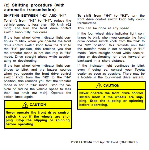

    It is the 4lo ight which is blinking. When I try to put the truck in 4WD high or low. I have zero 4WD. 4WD lo light blinks on the dash when I turn the selector switch to 4WD high. In any case, situation or option of driving, at a stand still etc. The front wheel s will not engage. After the switch is returned to 2WD the dash light continues to flash until the truck is turned off. Next start with the switch in the 2WD selection. no light on the dash.

    Thanks I'll try again at greater speed. I've owned this truck for about 5 years now. I could be going crazy, but I feel like I know how to put it in 4WD. This doesn't explain the reason why the 4 lo flashing light comes on when in "H4". So far this thread is going great! lol

    check above link if you found this in the system search. Loads of info on the matter. For me. After unsuccessfully attempting to get into 4H or 4L I made the trip hime in 5” of snow. Thankfully made it. Maybe the aggressive tires I have helped. But I could not make it up my drive. I tried the processes again and low and behold. Thunk, 4Low! Made it up the drive and played with the switch and tracked my drive out for about 5 minutes. It worked flawlessly. From 4low to 4 high to 2wd then back to 4 high and back to 2wd. I’m guessing I need to pull the transfer case actuator and inspect, clean or replace. Check grounds and make sure that vacuum tube is good. Thanks all
