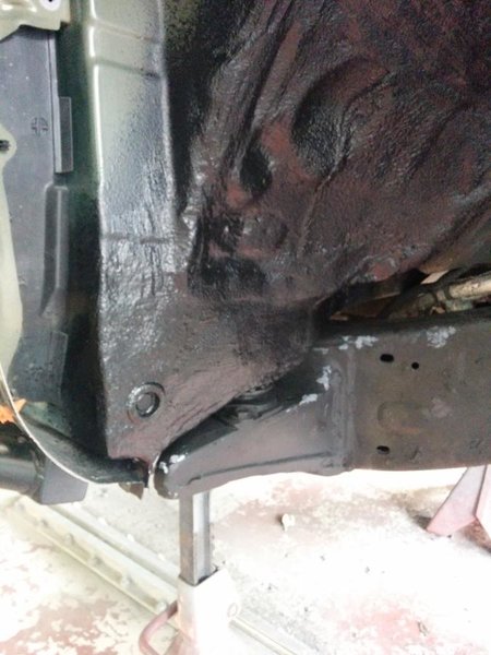

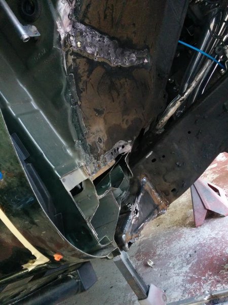

    Ok, if the pictures show up, in the first pic mine is the little Spruce Mica between the two blue FJ's, rollin on 35" MTRs, does that mean I join the 35" club as per OP...? No body lift, I am prob only 1-2" of lift though, as you can see by the other trucks in the photo...
    As for the second photo... Anyone care to guess as to why one has to and I'll quote "Beat the firewall like it raped my daughter."...? Well if you take a look at all that bracing in there and the fact that every 90 degree bend in a piece of sheet metal will increase the rigidity by 400%, well you start to get the idea, the firewall REALLY doesn't wanna go anywhere... ;-) Third photo is after cutting out what Toyota should have left out from the factory and welding it all back up, seam sealer and undercoated... I don't wanna hijack this thread so I'll try and put together a build thread for the curious...
