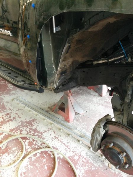

    Okay I am probably going to sound like an idiot for asking this, but, why are you guys having to cut your firewall back so much? I just had to pound the seem flat and in just a bit and my tire clears just fine when it is stuffed in there. :confused:

    Try turning with it stuffed and i bet youll have some rubbing

    Hmmm...I was turned to the passenger side completely stuffed and no rub??
    Maybe I just didn't notice it rubbing because I was going so slow but I don't remember seeing and marks on the fire wall.

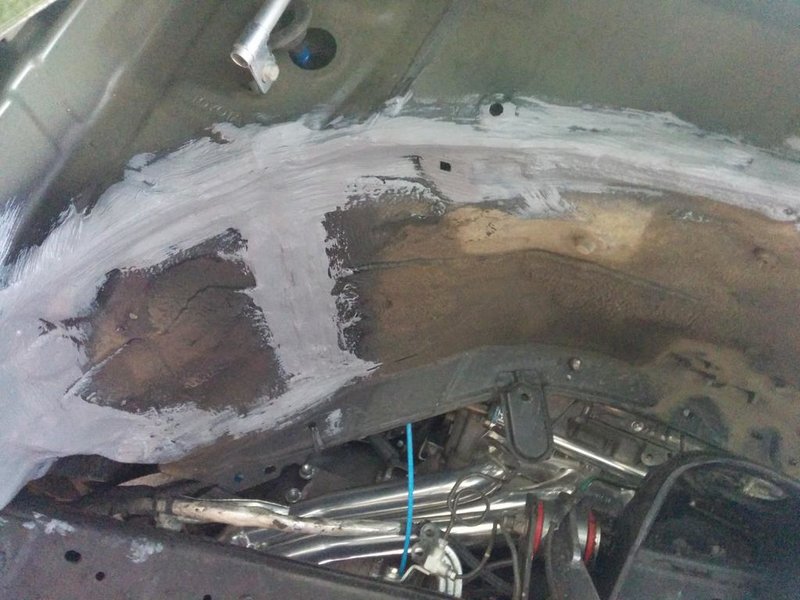

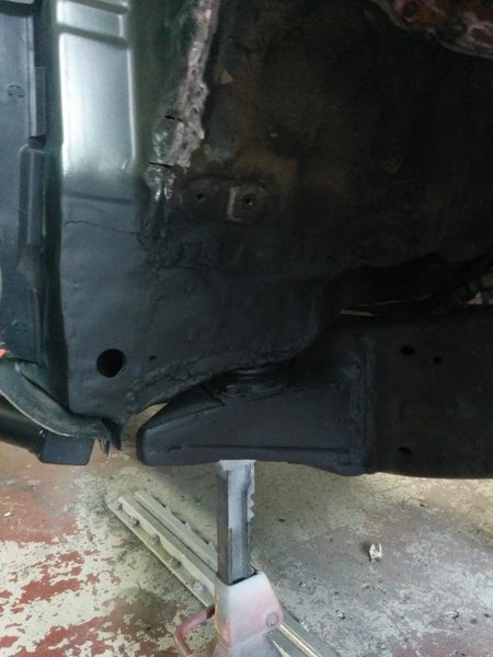

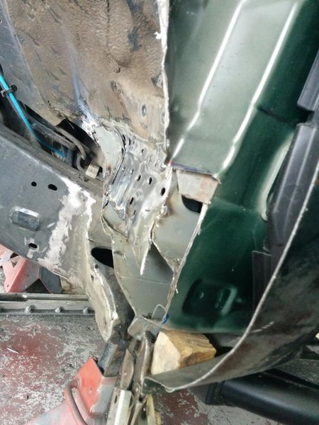

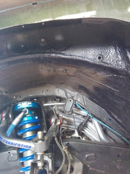

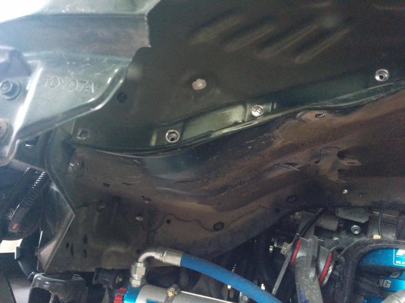

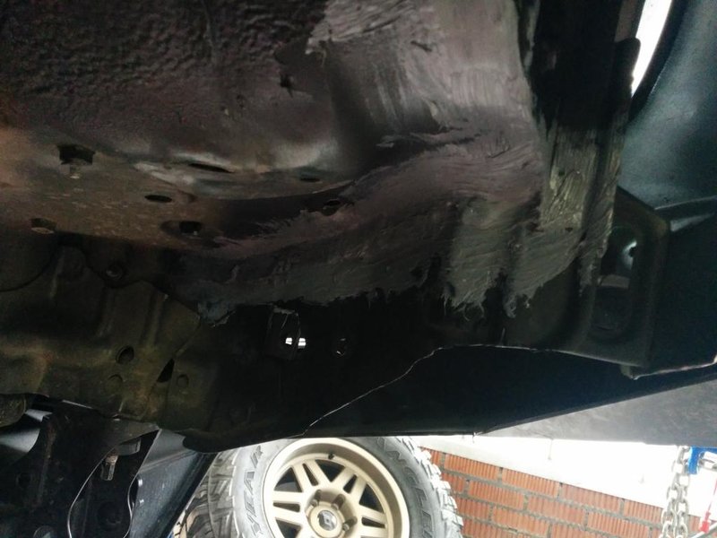

  17. Jun 6, 2014 at 9:21 AM
    #2177
    Geodesix
    Geodesix Member
    Sep 10, 2013
    #112252
    13
    Vancouver, BC
    2013 Tacoma TRD Sport

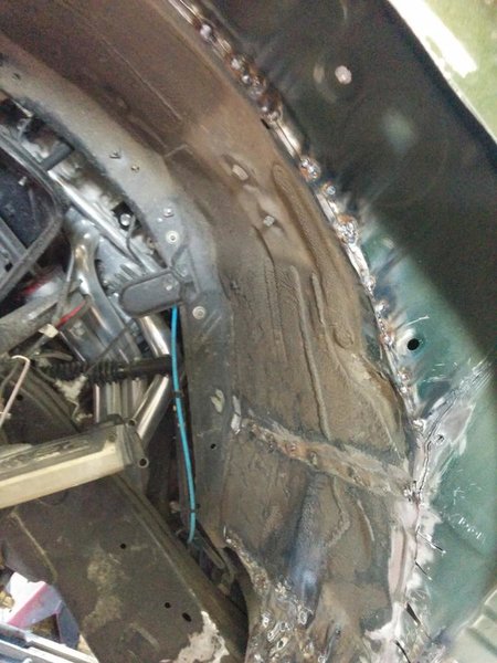

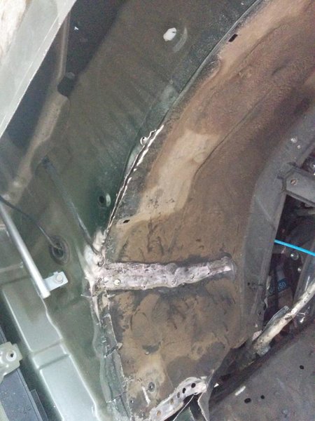

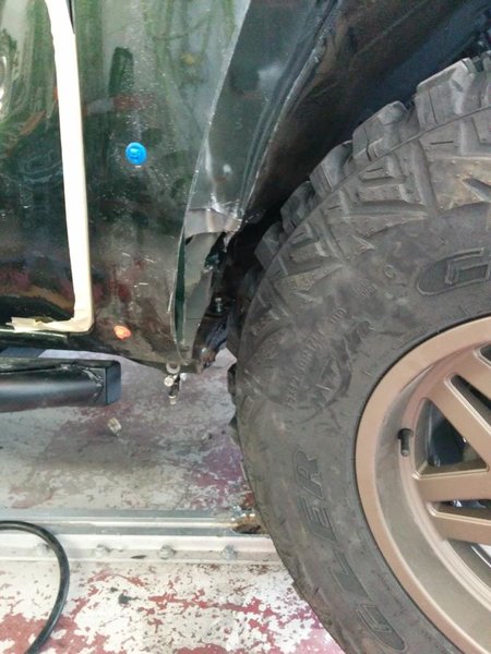

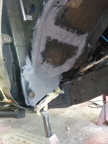

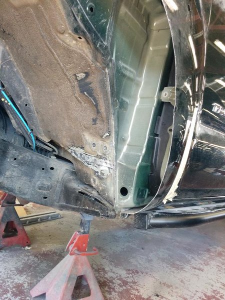

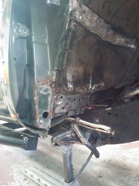

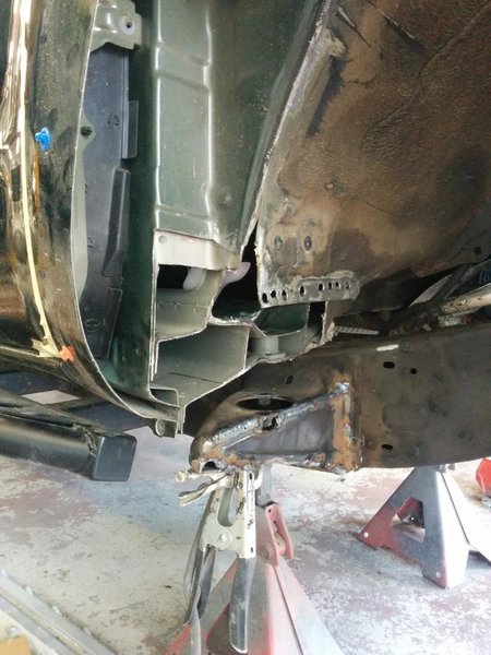

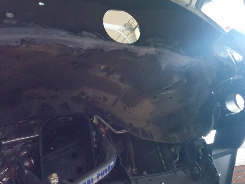

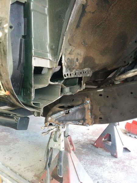

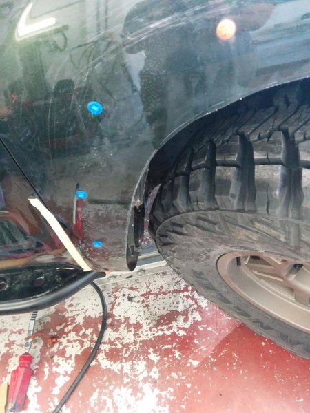

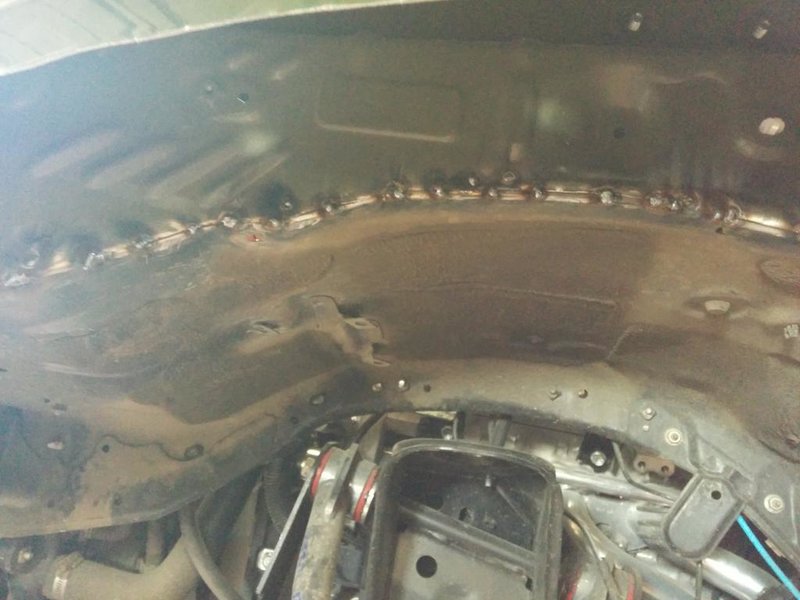

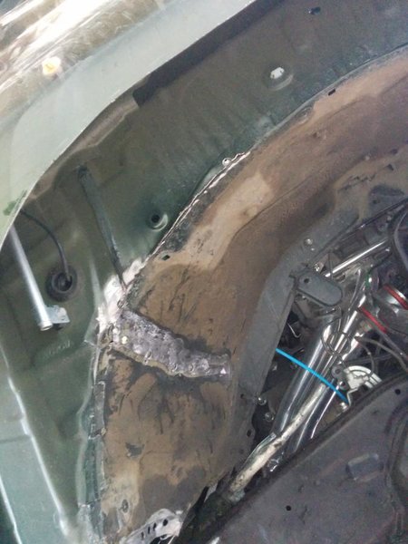

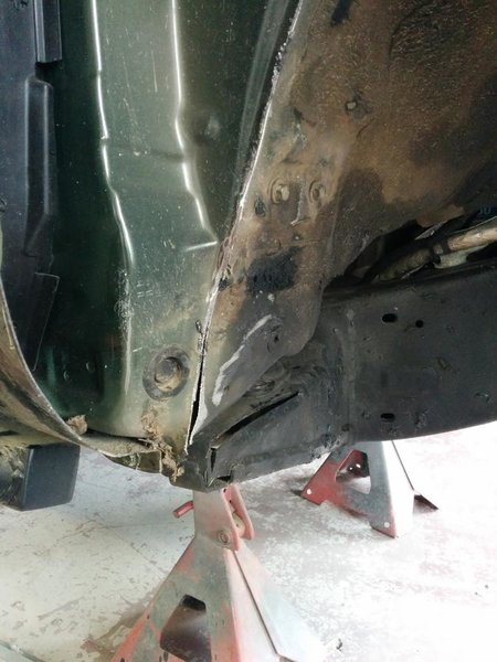

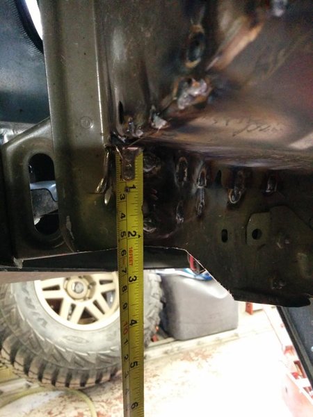

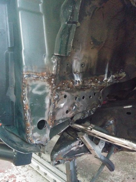

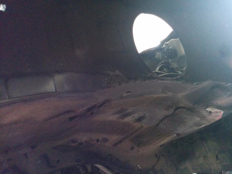

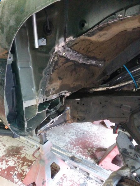

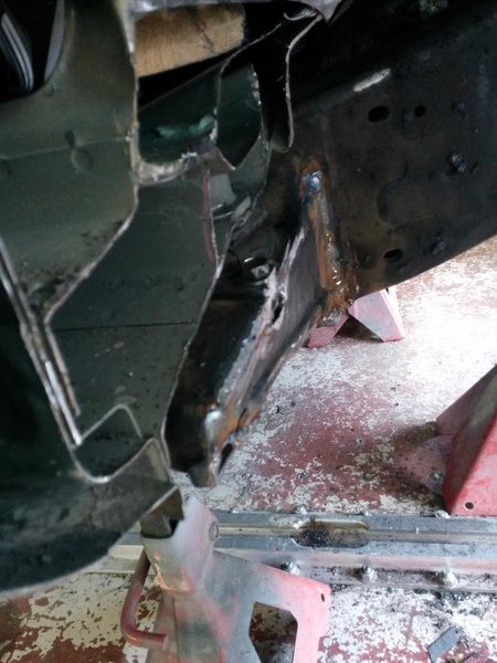

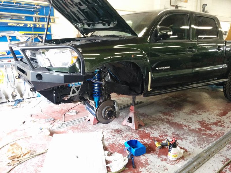

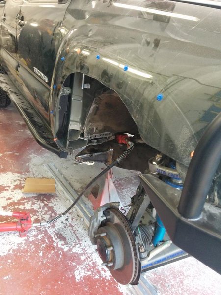

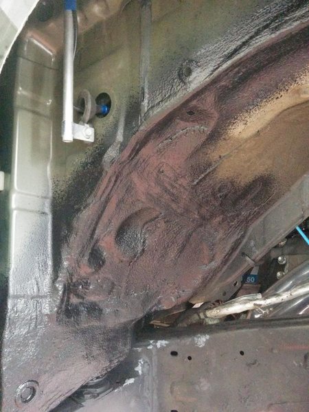

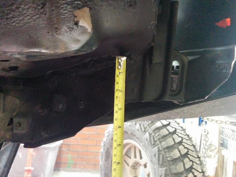

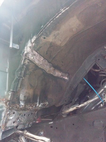

    I'm sorry to OP if this is pic heavy, this isn't all the photos but should give an indication of what's involved with not only the fire wall but we also drilled out the spot welds and moved the inner fender up more then 2 inches on each side. There are a couple shots with a tape measure for you to see how much it was moved up. Everything was welded back with the same metal that we took off the truck so technically it's all OEM sheet metal...(Still thinkin this might work at the dealer for warranty work... :rolleyes:) Again this isn't all the photos but if you want me to take some down I can, i'm not trying to hyjack this thread...
