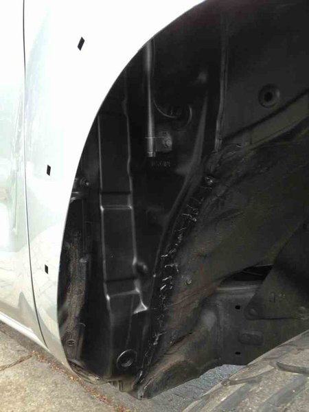

    You're gonna need to beat the bottom by the rubber plug in a bit more, and the body mount will need quite a bit more taken off. Have some RTV ready to fill where the firewall cracks.

    With 3 inches of lift and a 1 inch body lift would that make it a little easier? I'm really thinking about going to 35's and I plan on cutting and beating but would the extra inch of body lift help any with fitting them and rubbing with flex?

    It should, but the only problems people have with rubbing is on the frame and UCA...BL won't help that

    lift height won't help you clear the tires except at right height.as soon as your suspension starts moving, it doesn't matter what lift you have.

    I'm aware of that. I was wondering if the body lift would help as the suspension flexed.

    There is one spot on top toward the front that rubs on full compression. The body lift would eliminate that one spot.
